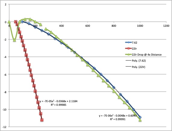

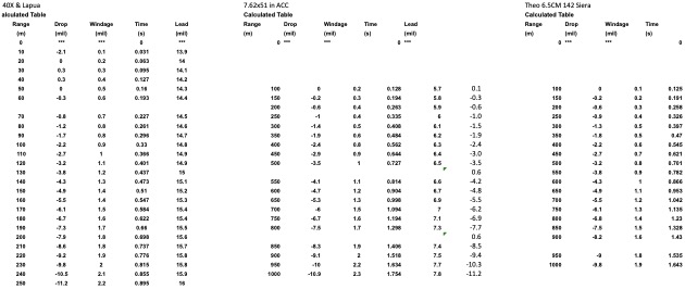

This is the old thread on a target. I also did some excel spreadsheets looking at 22lr and 7.62x51 175gr.
Take my dope from my 40X and some calculated dope for longer distances for my 7.62-175gr out of an LMT MWS.
Red line is mil drop for the 22lr, the blue line is the 7.62 data. The green line is the mild drop for 22lr, but with the distance times 4. Pretty close at relevant distances.
7078414
I was running the equations to try to divine out some kind of relationship.
To me, it wasn't so much the wind as an issue, it was that the 22lr seems really sensitive to ammo, gun and air temp for 200+ yr shots. Still looking to do a day long look at ammo temp, cold bore and gun temp affect come ups at 200. I saw 1 mil differences from morning to noon (50F to 80F) that I could never get to calc out in a ballistic calculator the differences based on air temp alone.
