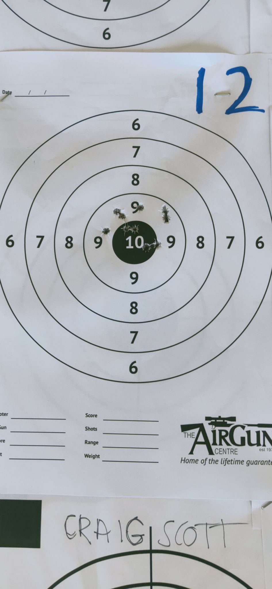

Just finished testing a 22in 9t on my 2013 Anschutz. This gun is set up for 200yd competition only. I have two excellent barrels. one Anschutz 27iin 16t and one custom Lilja 21in 16t. Just purchased a 22in 9t Lilja. Tested this fast twist at 50,100 and 200yds with poor results. It will not shoot with either one of my 16t barrels at these ranges. Definitely does not like Eley flat nose .Shoots Round nose Lapua and RWS better but still not up to my 16t barrels
For what it's worth. Just finished testing a 22in 9t on my 2013 Anschutz. This gun is set up for 200yd competition only. I have two excellent barrels. one Anschutz 27iin 16t and one custom Lilja 21in 16t. Just purchased a 22in 9t Lilja. Tested this fast twist at 50,100 and 200yds with poor results. It will not shoot with either one of my 16t barrels at these ranges. Definitely does not like Eley flat nose .Shoots Round nose Lapua and RWS better but still not up to my 16t barrels. After having gone through a brick of excellent lot tested ammo I still don't know if the poor accuracy of this barrel is due to the twist rate or it's just a bad barrel. At $450 per barrel I'll probably never know. I've read a lot of post on fast twist barrels. Some saying their fast twist out shoot the standard 16t at longer ranges. How do they know it's the twist rate or it's just a overall better barrel. There's a lot more to barrel accuracy than just twist rate!

From a PRS rimfire comp today. 10 shots, 60 sec, gun starts in prone in position, shooter starts standing 2m behind, with magazine in hand.
Only shots within 9 ring count, no breaking or touching line, must be in. Was a ~2.1moa shot. 100m distance. I was the only one in the comp who cleaned this stage. I used SK standard plus (yellow box), and i use a 9twist swan barrel. Aussie made.
Wind was a bitch, tail wind, real switchy. Still, 45sec for 10 shots and i was done.

Honestly not sure what happened here. Having a full custom setup, VS stock tikka t1x, bergara and c457.. not a fair comparison.
As for distance, like 200+m, yes, i can group better than multiple vudoos at my club. We were shooting groups at 300m, and multiple shooters on my rig found it easier to hit and finish a KYL rack. Not saying other guns are crap, for that day, in those conditions, we all found it "easier", was more forgiving.
I have some SK long range to try soon. Will test out to 200m, against multiple other guns, on paper. Maybe do 385m on steel too.
