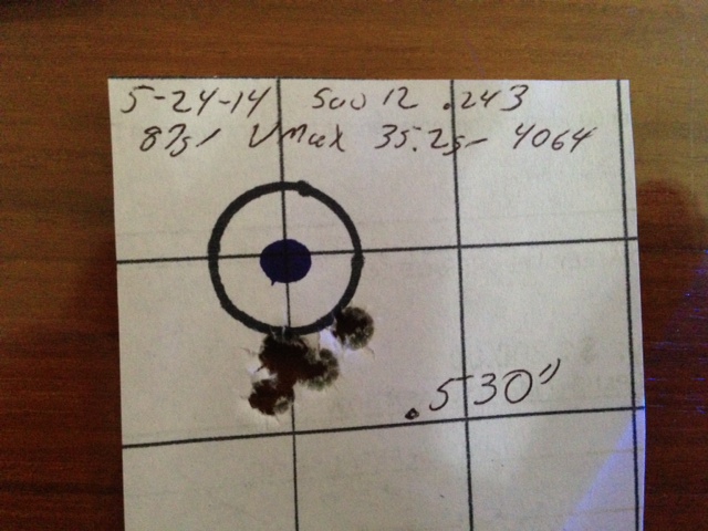

I'm not completely done with load development but i went to the lighter 87gr Vmax's and a faster powder (4064) with great results...right now I'm seated 010" off the lands with 38.5gr of 4064...*THIS IS OVER MAX LOAD-USE AT OWN RISK*...MV"s are around 2940

Hay guys, Im trying to help my brother do some load develompent on his savage 243. Has a 9.25 twist brl. We started wth 85 grn hdy Interbonds and a string starting at 33.8-37.0 of 4064(.3 steps). None were any good. Seen post earlier in this thread that one guy pushed on to 38.5 with good results. Anyone have a compearable load they could share. This is an off the shelf gun.
I could not ever get 95gr Nosler Ballistic tips to group out of my factory Savage with 4064. Not sure what the issue was, but my barrel did not like that bullet/powder combo. I switched to the 87gr V Max and have been happy. I use Win brass with 35.2gr of 4064 and get sub moa 5 shot groups.
It also likes 35gr of 4064 behind the 95gr Sierra Matchking with Win brass and primer. Both loads are extremely mild, but group really well.

Berger 105 Hybrids
Lapua brass
Fed 210M
H4831sc 44.3 gr
OAL 2.825 which is jumped .030 for me
26" Kreiger
Tested this load out to 800 yds this morning and showing 3140 fps. Started with 42 gr and worked up to 45 which is where I ran into pressure signs. 44 to 44.5 looked the best shooting .4 to .45 3 shot groups @ 200 yds. So I Set it up at 44.3 and ran with it. I fought and fought to get IMR 7828 ssc to work in this rifle for some time. So when I shot these groups I was hooked. Speed looks better that what I was expecting, and shot very well out to 700. Ready to get some more loaded and tested.
Dam that's smoking. Most of the loads I've been researching have been around 2900. That's awesome! My rifle should be here by the beginning of next week. Can't wait to put my hands on it!!!
Same here Sierracharlie. I was looking at maybe just maybe hitting 3k with what I've read. So when I tested the load at, 400 then 600 then 800yds, I was really surprised with what the data was showing me. Forgot to post that its a 7.5 twist and at 3100 altitude. More tests to come.
That gives a little more to the equation but either way I'm jealous til I get my hands on mine. Found out it shipped today from GAP!!!
flippn sweet!!! Mine is a PCR barreled action job to a stiller predator action. Had some 4350 but felt I needed something a touch slower, so I tried and tried till I got a 8# stock of 4831sc last week, and it looks good and it was hard to find some data on it so I thought I'd post it just to help out. Gap did a 22-250 with a 8 twist barrel for me this spring. Shootin the 75gr bergers with 4350 at 3200 fps is a PD Killer out here and I cant wait to test it on Yotes!! Rock On!!!!!!
