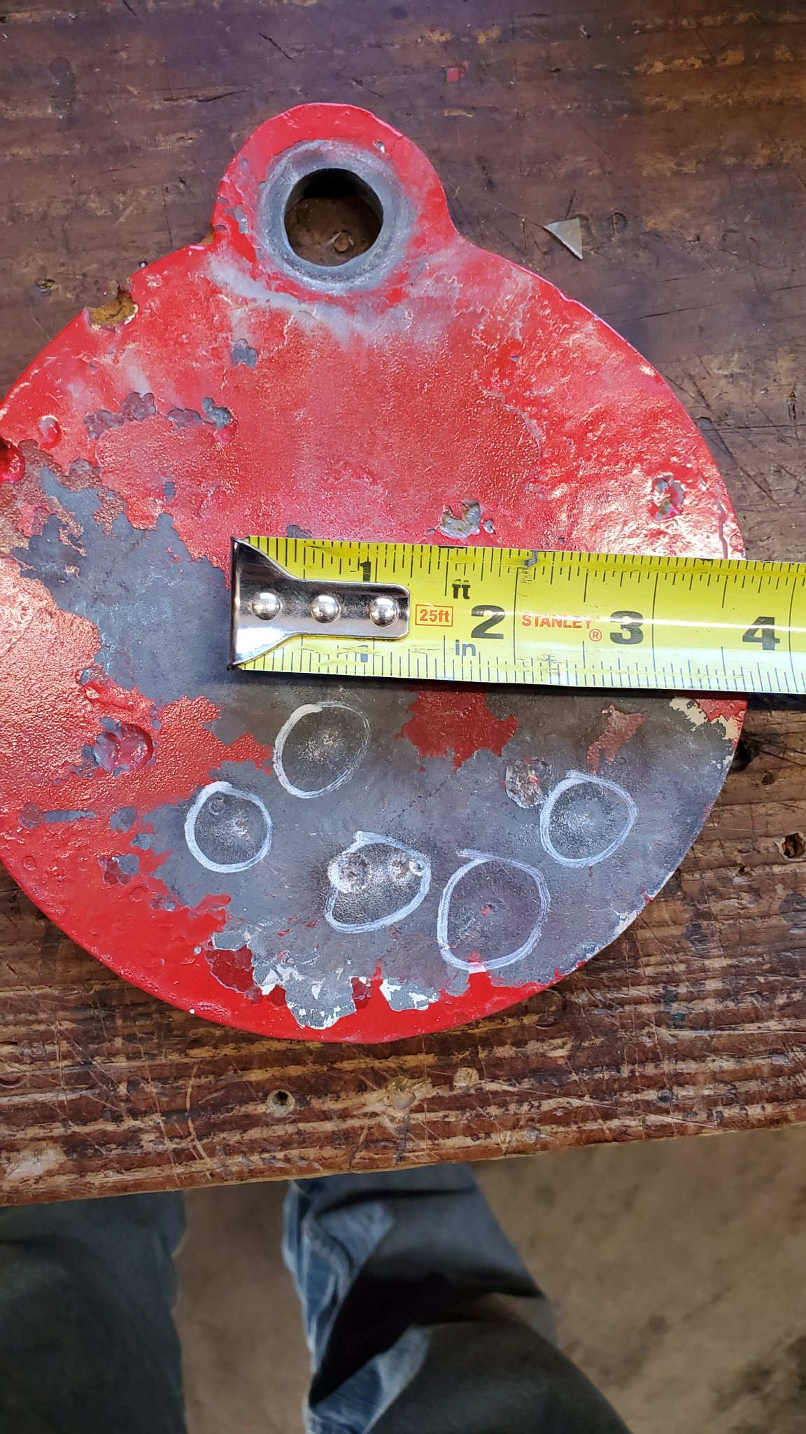

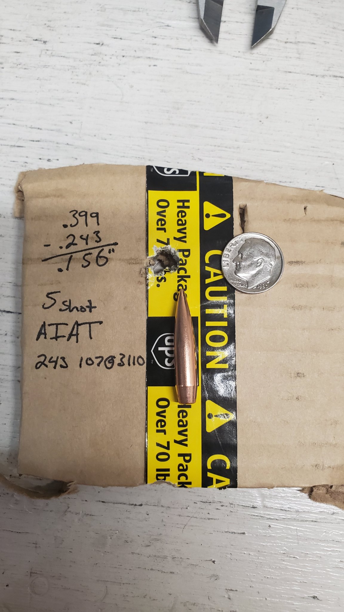

24" bartlien 7.5tw 5r aiat
107smk pointed, .547bc @2.280 ogive
43.5gr h4350, win match prep brass, cci br2 3110fps and bugholes at 100yds
7101378
And 750yd
7101379
Reactions: BallisticPrimate

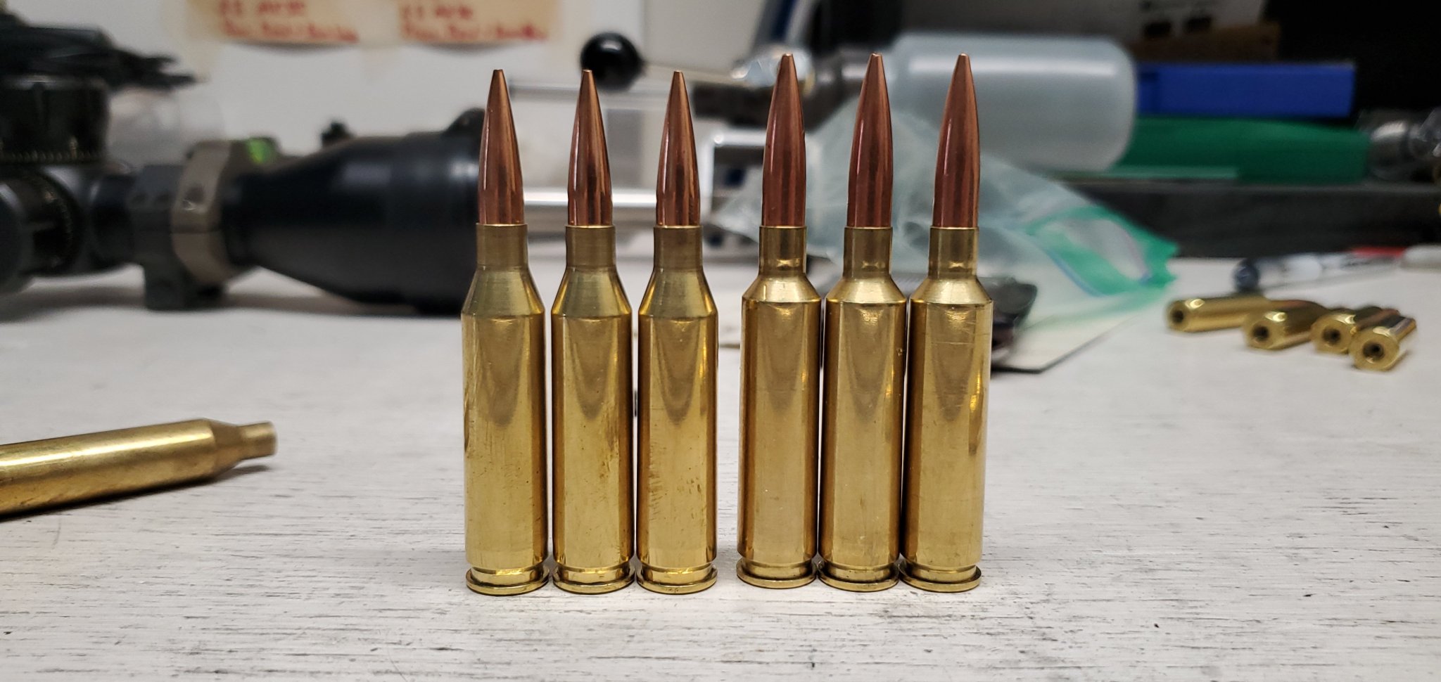

Thanks. I'm having a bartlien 5r 7.5tw med Palma spun up for a curtis axiom in 243 cutright. Pretty cool rd, Jay cutright designed it and used it to win a bunch of 600 and 1000yd ibs trophies about 10yrs ago. 243win case with shoulder pushed back .050 with 243 cutright die, then fireformed in cutright chamber. Results in a longer nk, 37.5° shoulder, body taper identical to 6br. Case capacity is close to 243ai. Jay was getting 3150-3175 with 115 dtac and h4831sc in a 26" -30" barrel
7101434
Some win brass with bumped shoulder, loaded to measure nk size. His reamer is .270, but my chamber will be .275 no turn with a .185 freebore.
7101435
243win on left, 243 cutright on the right.
