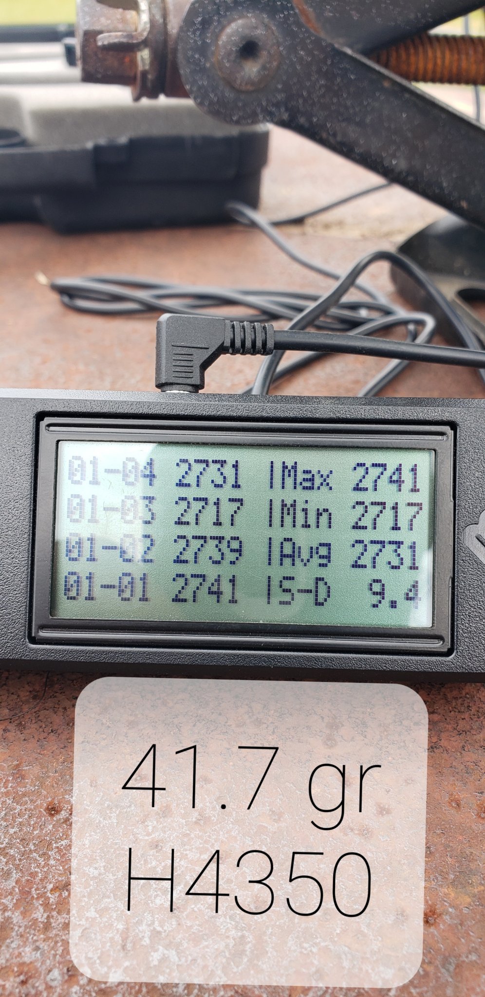

Anyone have any experience with 25 creed using Hornady 134 eld bullets? I have 26" preferred barrel cut with 25 creed blackjack reamer. So far I have just ran a few loaded with N555 to get velocity and going to test more tomorrow. Also going to try a few others including h4350 and RL23.
If anyone has any experience with 134 elds let's hear it! Pic is of two I shot just to get idea of velocity 41gr N555, Peterson 6creed brass, 134 eld cbto 2.175

I run alittle test on mine today. 22" Proof Carbon with a Deadair Nomad-Ti.
Sometimes I'd get a sticky bolt and then the next shot .2g higher it would be smooth as butter. 🤷
22" barrel at 2950 with a 134, that's HOT. I run a 28" barrel with 135s at 2860fps. Instead going straight to the max, perhaps try the slightly conservative charge of 40.5gr? Not telling you what to do, but I would definitely not be running on the ragged edge. What's your case head and fired primer look like? Bolt lift is a sign that the psi is over expanding the brass to dimension that are an interference fit between the chamber and/or bolt face.

39.6 I didn't realize was straight to the max. 🤷 I had researched enough and seen many reports of 42+g of H4350 being used.
I ran this to zero in on what I was looking for. I won't be running on the ragged edge for sure. I understand bolt lift is a sign, have known that for 25+ years. Case head and primer looked fine which is why I tried the next charge. (Which also looked fine with no sticky bolt) Weird.......

42.6 was max in mine with H4350, 43.0 with rl16. Both these were over 3k fps but my barrels is 6" longer than yours. Your barrel is making more psi per grain than mine by quite a bit especially considering the length loss(or could be a large lot to lot variation in 4350). From your test and the node at 2940fps, I was just saying, I wouldn't run it there. Did you ladder these rounds at distance to see what velocity ranges held tight vertical? The Peterson brass does also hold less powder than lapua and alpha, also contributing to elevated psi/velocity.
In my 2nd 25cm I ran 131 aces at 2950.with 41.3gr H4350, that was a 26" krieger blank. Brass after 3-4 firings was getting clickers upon primary extraction, his was due to a poor fitting redding FL type S die. Once I switched to matchmaster FL bushing die all that went away. If you're not seeing psi signs on case head, and the fired webs aren't over 0.471 I'd say your pressure levels are safe. I'm my 3rd 25cm barrel the first two were burnt with 131s and now I'm onto 135s. I really miss the 131 blackjack, that was a damn good bullet.

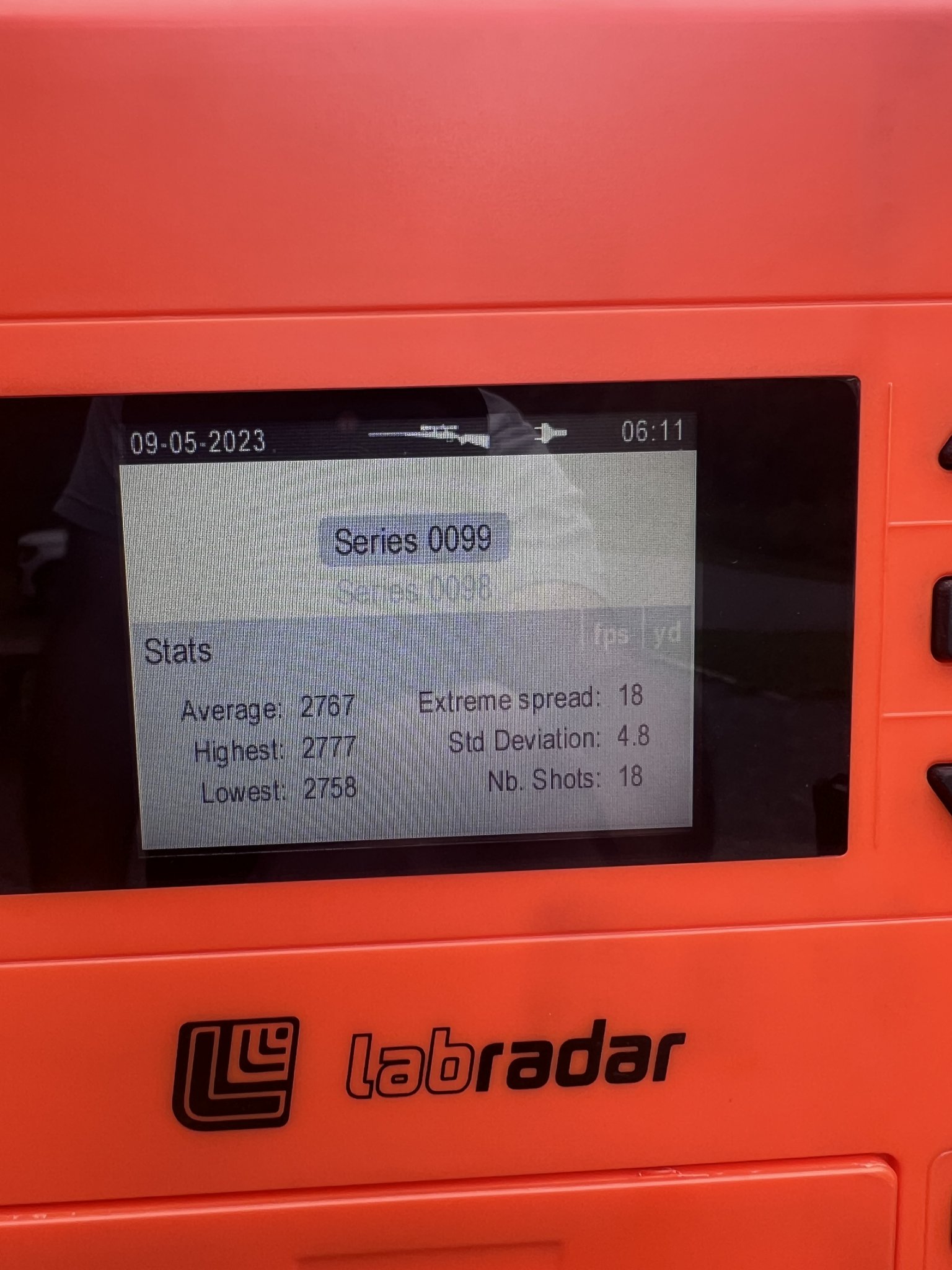

What kind of group are you getting
This is what I got the other day with the 134elds 42.3gr H4350, 2850fps, 24in tube with a can. I'm not sure if I used the ballistic x correctly, still learning how to use it.
