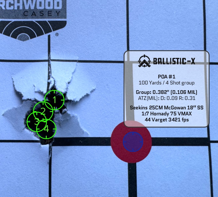

9/23/24:
44 gr Varget only mild extractor ring on Alpha brass. Working up loads so only loaded 4 but looks promising.
3421 fps

28" Brux truck axle that is easily 1/4moa with either charge but the lighter node is a tick tighter.
What brass? I have a 28in on the way and was hoping for a comfy 2915ish with h4350.
While its possible, you’ll be pushing pretty hard. I shoot the 135’s at 2800 out of a 27” bartlein. Great accuracy, just not a speed demon.
@Towhead dont know which of the creeds you've owned, but the 25 vs 6.5 is hair splitting at best. When I cook this barrel, i’ll go back to 6.5.
