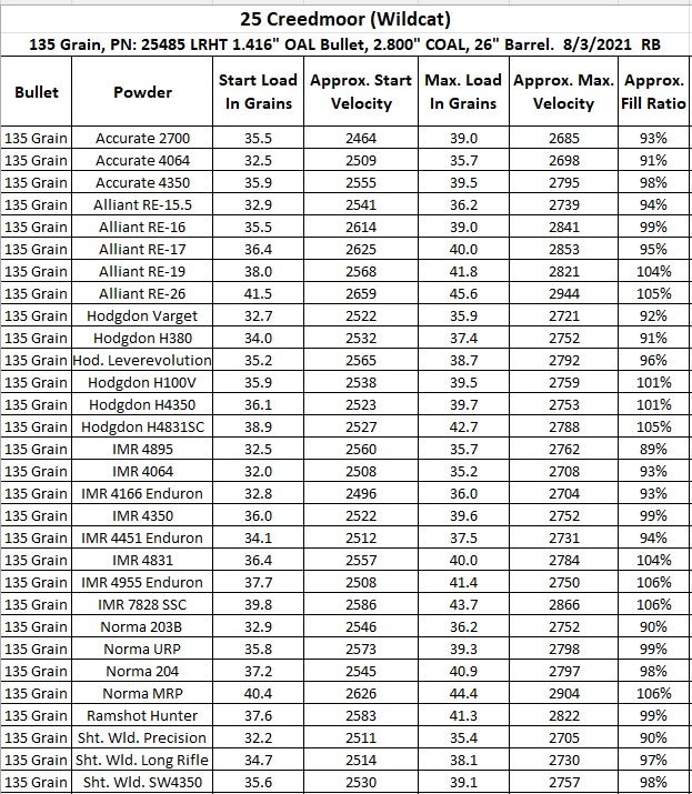

I’m attaching a load data sheet Berger sent me. I hope it helps. I built 2 25 CMs. 1 heavy PRS type rig & 1 NRL hunter type with CF barrel. I have less than 100 rds on both (built a 22 GT…..it’s getting all my attention). I haven’t loaded as heavy as you have with the h4350 & am getting speeds with the Berger table. I’ve switched to RL26 in the lightweight hunter & plan on trying h1000 also. I’ll post results when/if I ever get back on the 25s. Good luck…..
That information is much appreciated. 👍

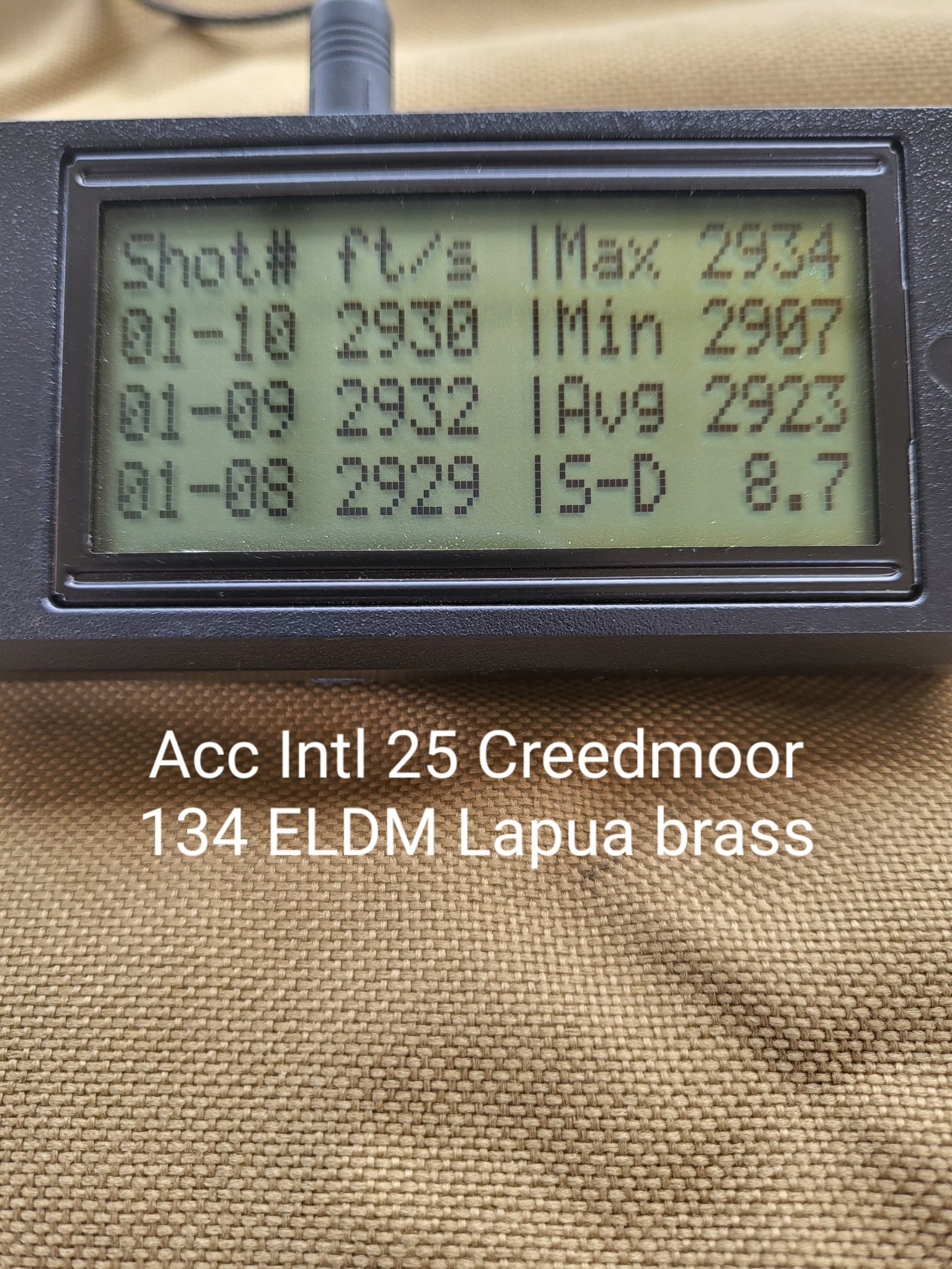

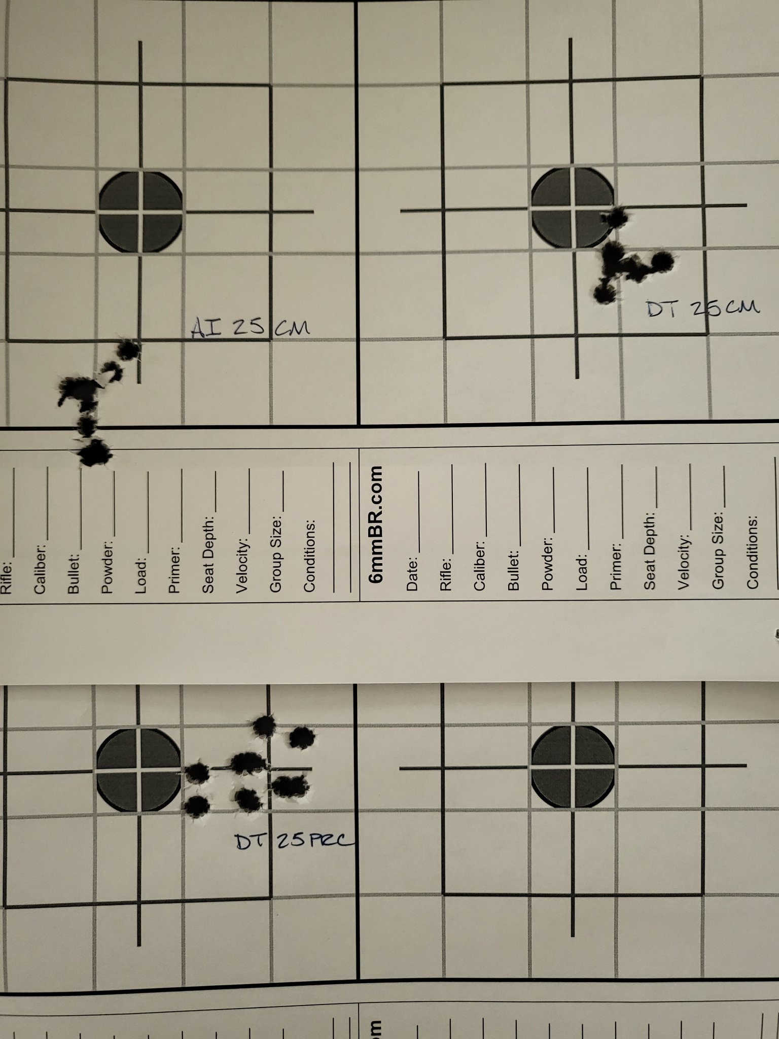

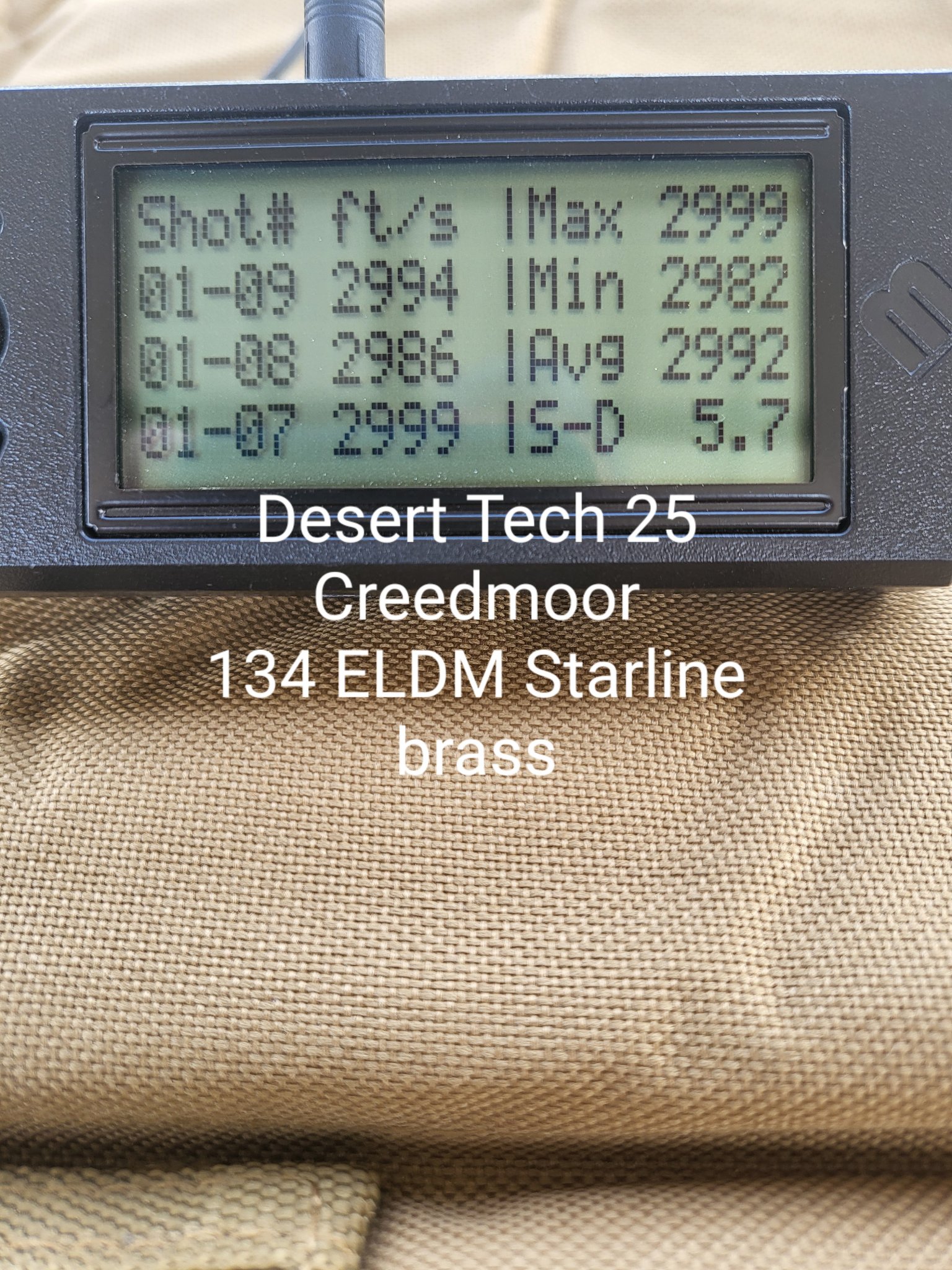

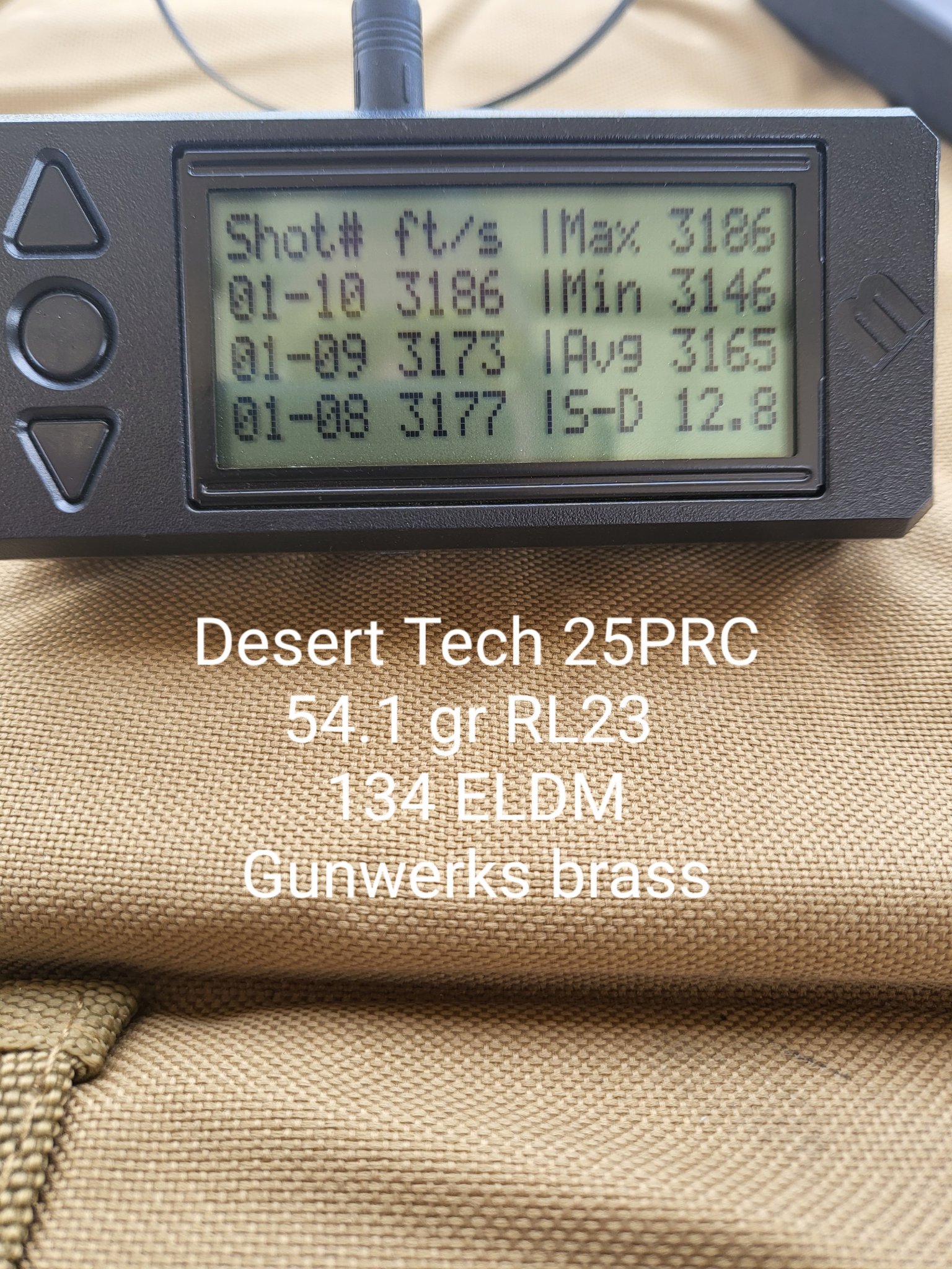

I posted this under the Hornady 134 thread, but I figured it deserved to be here too
I just ran the 134s, 10 rounds each, through my AI 25 Creedmoor barrel, DT 25 Creedmoor barrel, and DT 25 PRC barrel. Accuracy was ddecent My DT 25 Creedmoor barrel seemed to like them. I need to play with seating depth on the PRC and AI to tighten up the group. I also need to lower the charge weights. These were the loads for my 131s, so velocities were pretty high.

View attachment 8159108View attachment 8159109View attachment 8159110View attachment 8159111
You got that creed load smokin!
