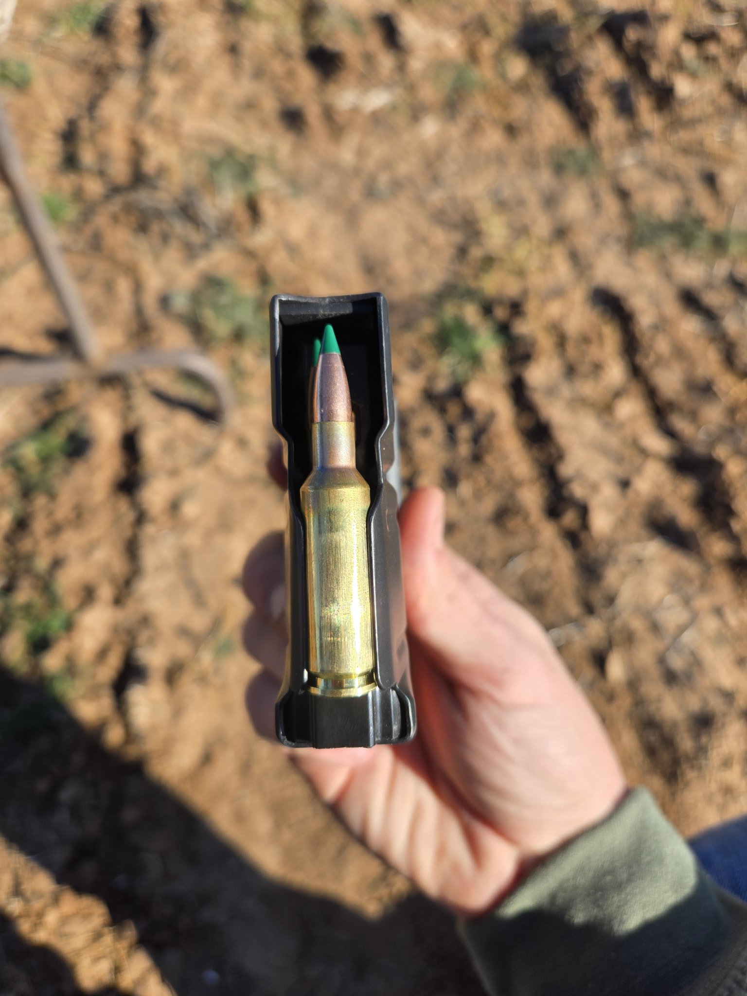

    For anyone looking at the 25GT, I started using one a couple months back. I got around 500 rounds on it now and a match under its belt (4th place finish at a regional 1 day prs match)
    I haven't seen much in the way of load data so I figured I'd share what I've found so far. I keep this intentionally slow but it should give you an idea of where to start.
    Barrel is a 28" Benchmark chambered by TS Customs with the alpha .180 reamer and installed by me on a Impact 737.
    in the below image I am fire forming new 6mmGT Hornady brass and velocity tends to be about 15-20fps faster after the first firing.
    Bullet being used in the above is a 135 Berger Hybrid jumping around .055", range notes 76 degrees, 67% 29.14 station pressure, little to no wind and time of day was 10 minutes before sunset through 20 minutes after... Limited on time, I had some pretty wicked mirage while shooting H4350 and RL-TS 15.5 coming off my shielded maverick and I know groups were affected but I was really more interested in velocities anyway... by the time I got to the loads with StaBall Match & 6.5 I had so little light left that I stopped for the night.
    Garmin Xero used for velocity collection.

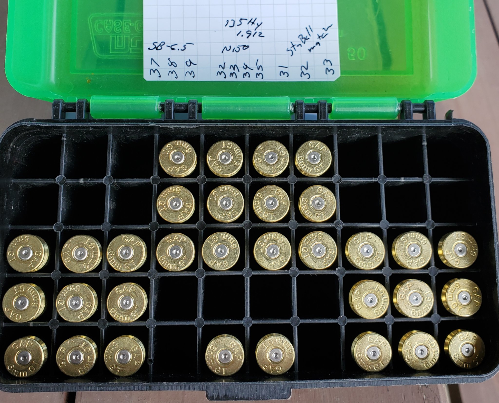

    Same but with StaBALL Match (hang fires on all, just enough to hear the striker impact separate from the muzzle report)
    31.0= 2480,2495,2492 =2489.5 6.3/14.4
    32.0= 2523,2573,2554 =2550.7 20.5/49.8
    33.0= 2609,2649,2629 =2629.3 16.0/39.3
    I had hang fires on my 6mm GT with StaBALL Match as well and figured the temps may have played a roll as it was near zero degree that day, today it was 67 degrees.
    @762 ULTRAMAGA below is a pic of my brass, the three with the 35 grain charge show a very faint ejector swipe. On once fired brass I have been gaining about 20ish fps on other loads so this could put you into that 2800 zone. keep in mind this is a 28" barrel. I do feel that the 25x47L would be a better fit for 2800+ though.

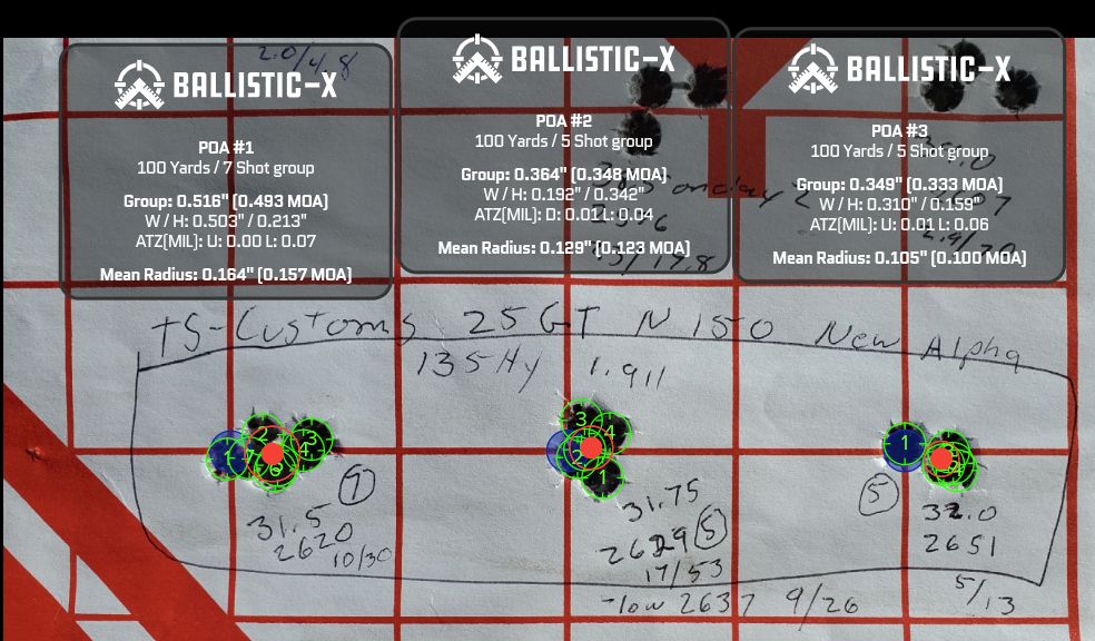

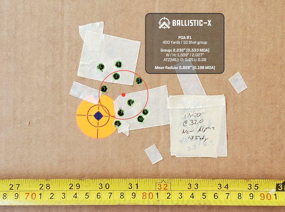

    New Alpha brass is in. Used N150, 135hy at 1.911 and CCI 450'S
    31.5 = 2609, 2618, 2638, 2613, 2621, 2633, 2712= 2620 sd10/30es
    31.75= 2599?, 2635, 2651, 2636, 2625 = 2629 17/53... without the odd ball = 2637 9/26
    32.0 = 2656, 2648, 2658, 2644, 2646 = 2651 5/13

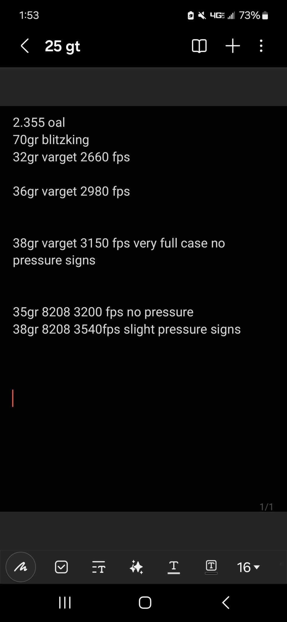

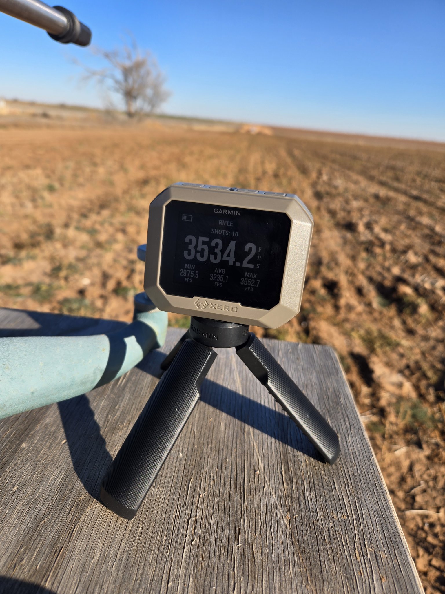

    I just finished doing mine. After testing H4350, N550, N555, N160, RL16 and RL15.5, I decided to go with RL15.5. I also tested the ELDm and SMK. The 131 SMK shot better, more consistent. Group is .155" velocity is 2759. Load is 34.2 with 131 at .035 off lands. 4 shots at 100 yards.
    View attachment 8546423View attachment 8546424
    Would you be able to share your data with N555?
    You can run a full case without pressure. I did not see the results I was looking for, which was disappointing as I run 37.5 in my 22 and 6gts with great results. It starts to compress around 38. All the other powders produced better results in the 25gt. I may try it again now that I have some rounds down the tube. But you can run 36 to 38 and see if it shoots for you.
