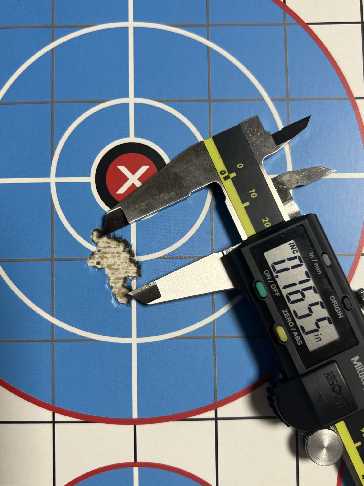

My go to load is 36.4 gr varget with Alpha brass and 135gr hybrids. 2759 fps and SDs under 5. This is a ten shot group. I have shot several 3-4 shot groups with this load under .25”. It’s a little slow compared to what I see others posting but I am happy with the consistency.

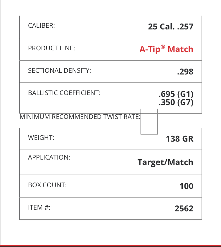

Drank the koolaid and starting a new build, CRB barrel on order, Dies picked up on the PX. Im really interested to see if/when the new 138 atips become available if they are going to be worth the $$$. Ive seen the new "aeromatch" start to ship but Otherwise ill probably stock up on the 131smk.

Don’t know anyone that has hands on but paper puts them above bergers….just curious if the extra $10-20 a box is gonna be worth it. But supposedly they are going to be bulk packaging as well to cut some costs as well.
I dunno if the chase of .33 to .34 or .35 is worth it? I know Sierra is now selling the 131ace directly as the 131 smk. It is not the best price, but.. I know those things shoot.

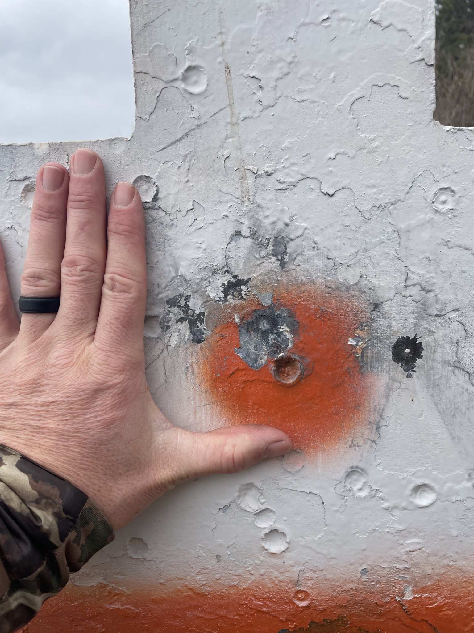

@Fat Dark Earth That was shot numbers 31-61 through the barrel.
Jumping forward now

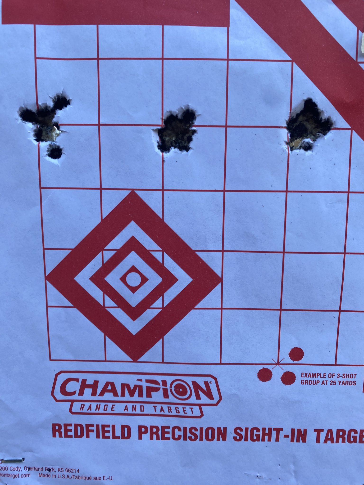

I took 33.0gr of n150 with the 135gr hybrids to a match last Sunday first pic was before the match minus the cold clean bore... second pic will be after 110 rnds were fired. Temperature from beginning to end was in increase of about 20 degrees. And the barrel had just under 180 rounds on it at the start of the day... also, this is with Virgin brass. So I expect sd to tighten up on the next firing.View attachment 8386048View attachment 8386049

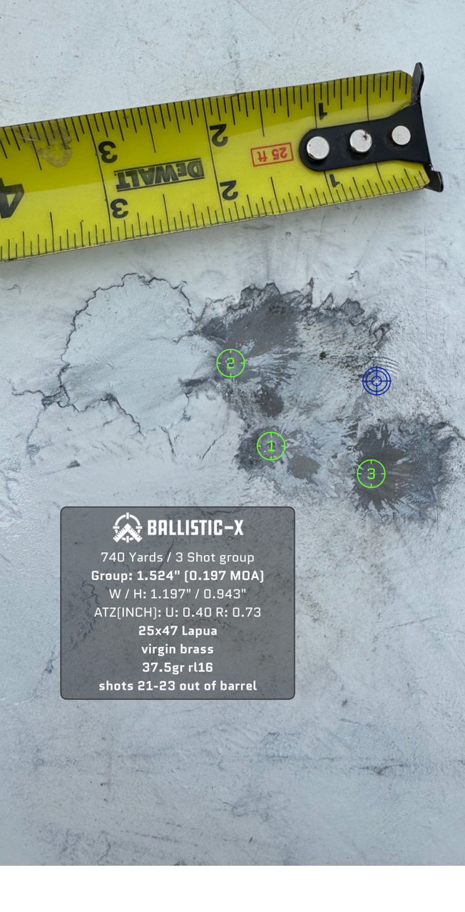

My 25x47 Lapua just showed up 2 days ago and I managed to get out yesterday. Loaded a random load of rl16 to just break it in. First 3 shots out of the new rifle
Ballistic-X-Export-2024-11-14 08:45:55.439100.png
Took it too 740 yards and second group at distance

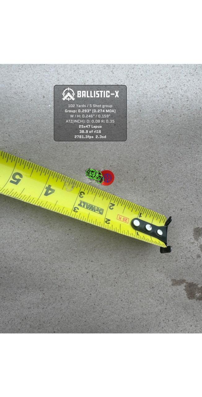

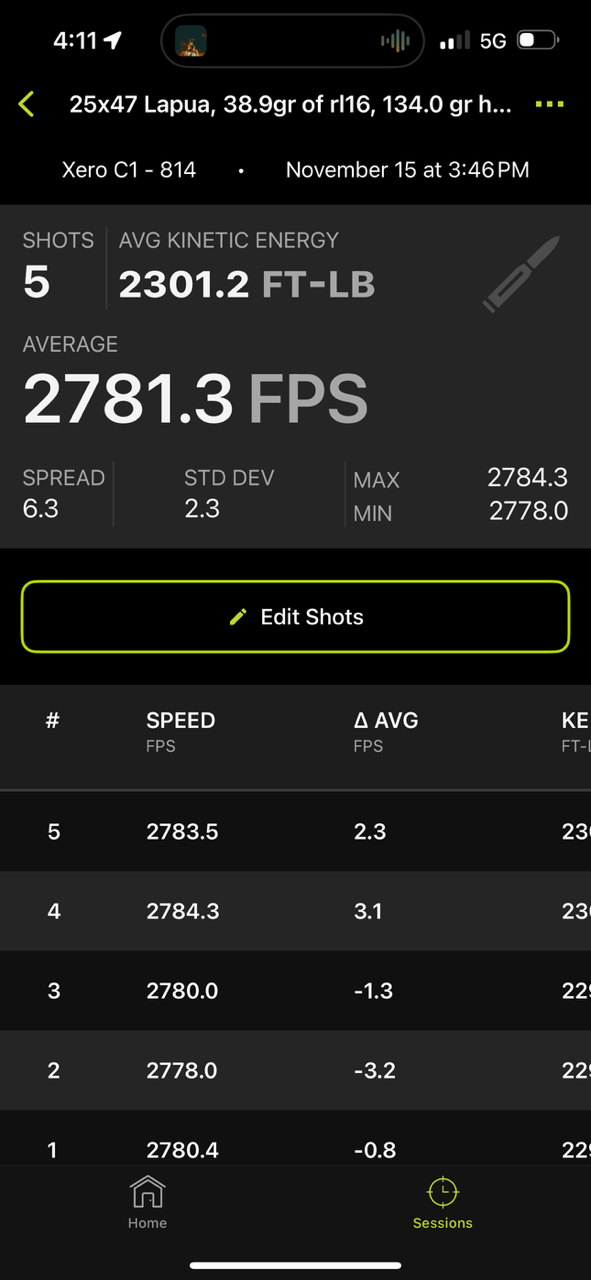

Performed some ladders today and picked a node to test and got these results
Ballistic-X-Export-2024-11-15 17:50:27.633764.png
So far loving this caliber

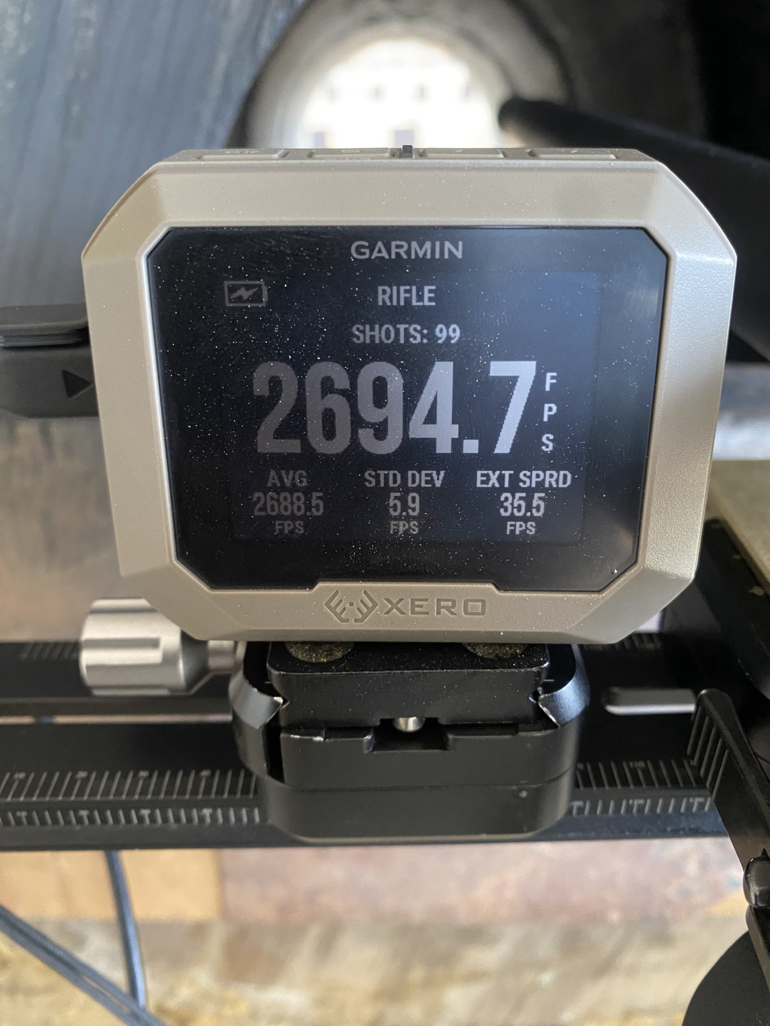

Just put mine together this weekend. Barrels has 200 rounds on it now. 3 different powder charges separated by .5 grains. 10 shots each and all under 9 fps sd. I think this is gonna be a good one.
Reactions: R_A_W
Shit, no idea. I didn’t measure it, just started seating it til it shot good enough. Getting around 2690 fps with pretty minimal recoil, good numbers, and decent enough accuracy. I’ll probably shoot it this weekend, Well see what happens.
