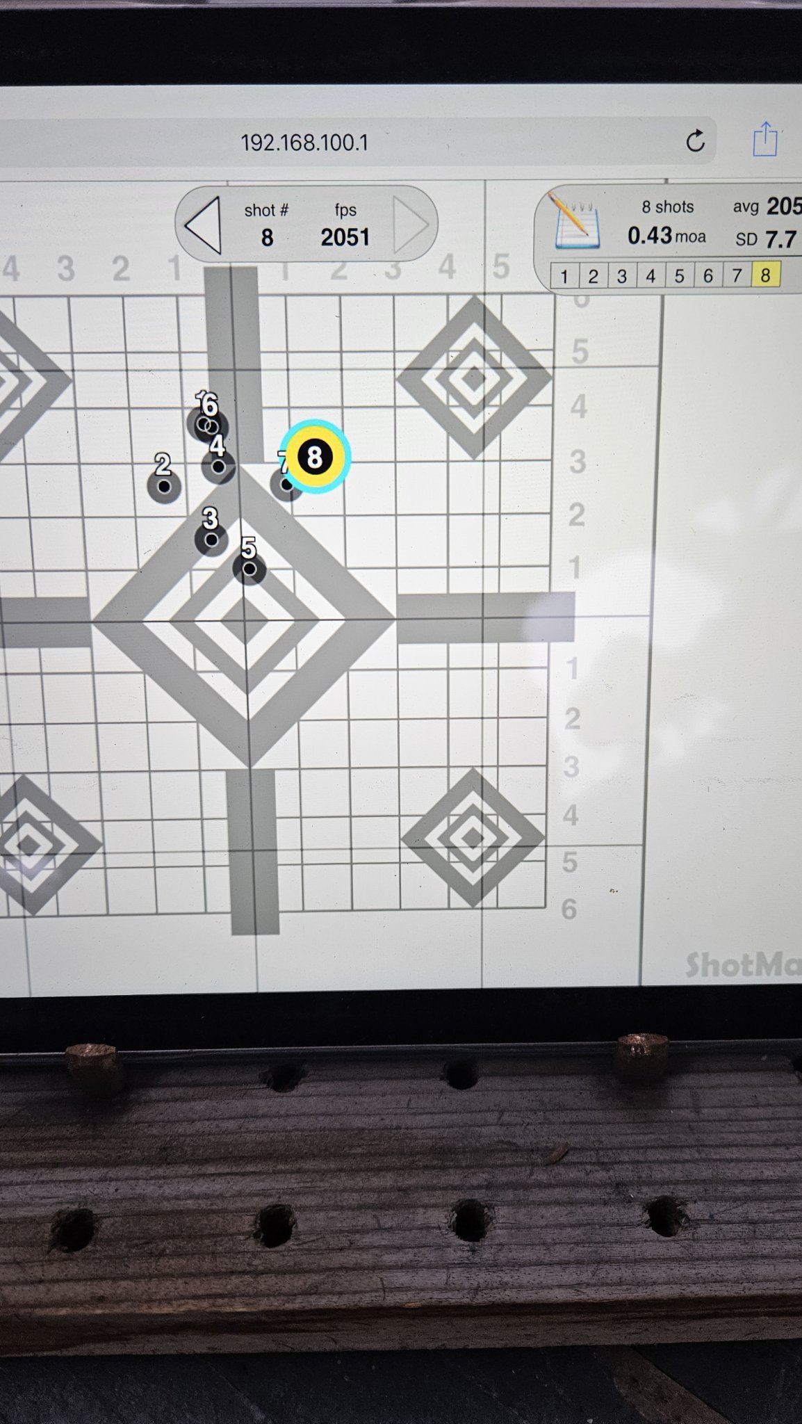

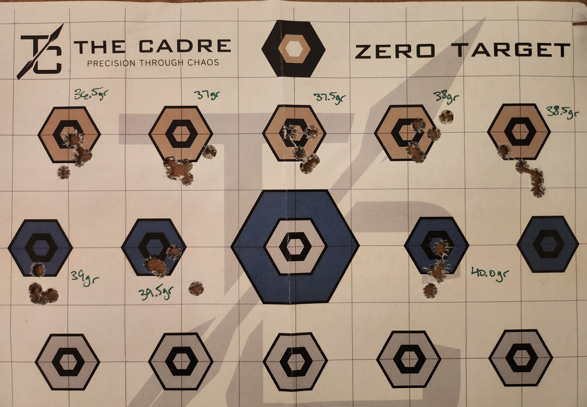

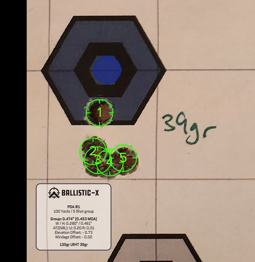

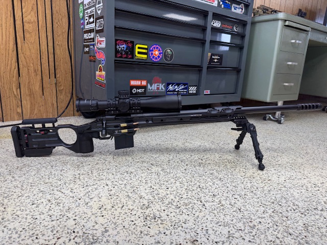

First 60 rounds through the new barrel with 131gr Sierra and 135gr Berger doing ladder testing.
Accuracy International AT-XC
24" Bartlein barrel ordered through Bugholes / Southern Precision Rifles
H4350 powder
Federal GM205M primers
Alpha Munitions brass
135gr LRHT Berger, 0.055" jump, tested for 36.5gr - 40.0gr at 0.5gr increments
131gr HPBT Sierra, 0.055" jump, tested for 39gr - 40.5gr at 0.5gr increments

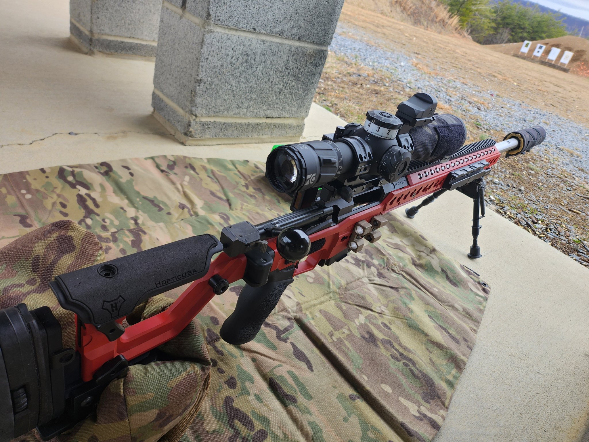

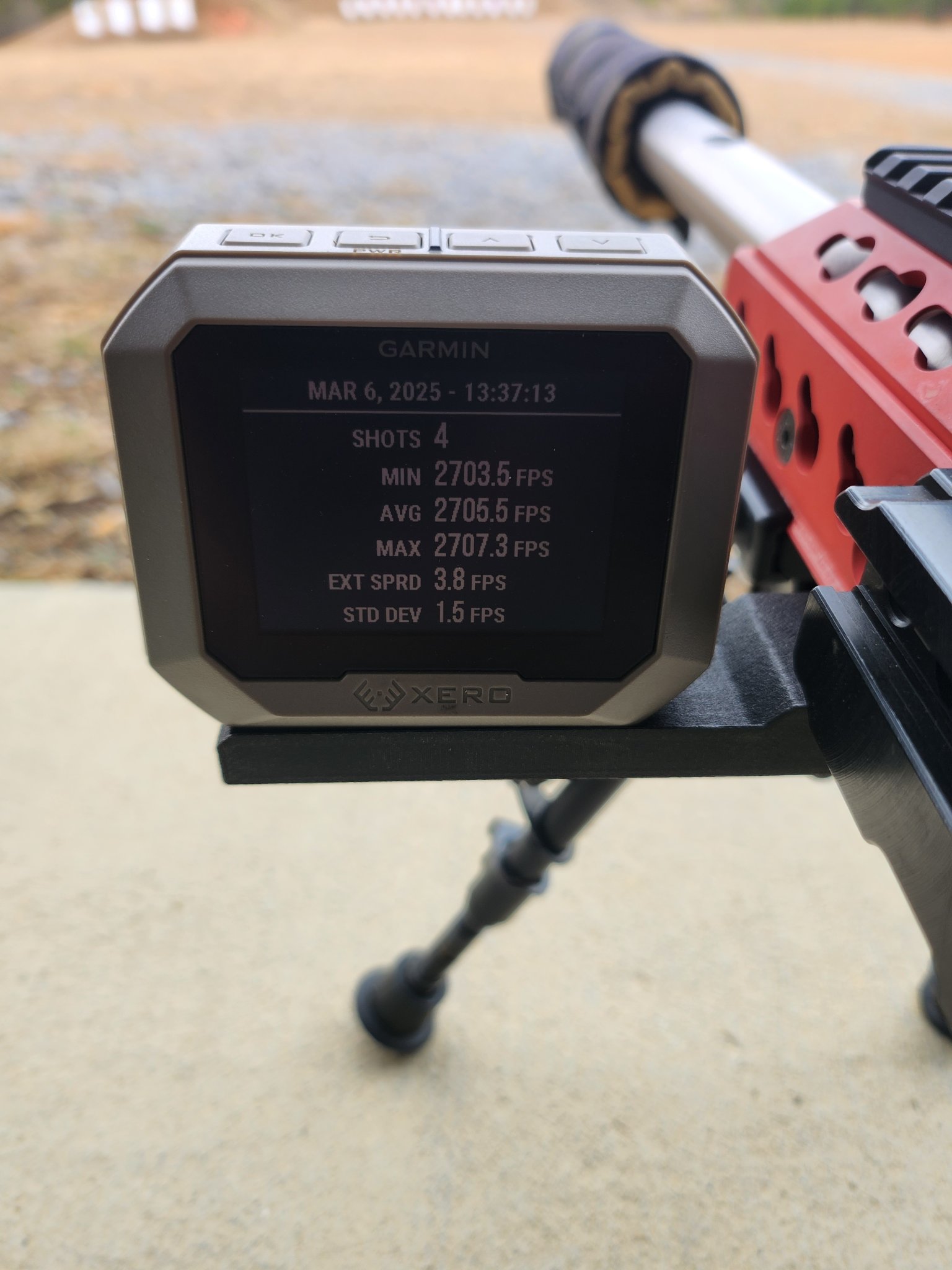

Finally got around to shooting the 25x47 some more. Got 150 pieces of brass fireformed.
28” CRB Comp 7.5T
135 berger
Alpha SRP Brass
BR4 primer
Jumping .025.
38 GR of 4350 I’m right at 2750. Shoots great.
It did shoot slightly better with new brass, I was at 38.4 grains of 4350-2715 fps and getting a bunch of single hole groups. I may back off some powder to get it to the 2715 again and see how it performs fire-formed.

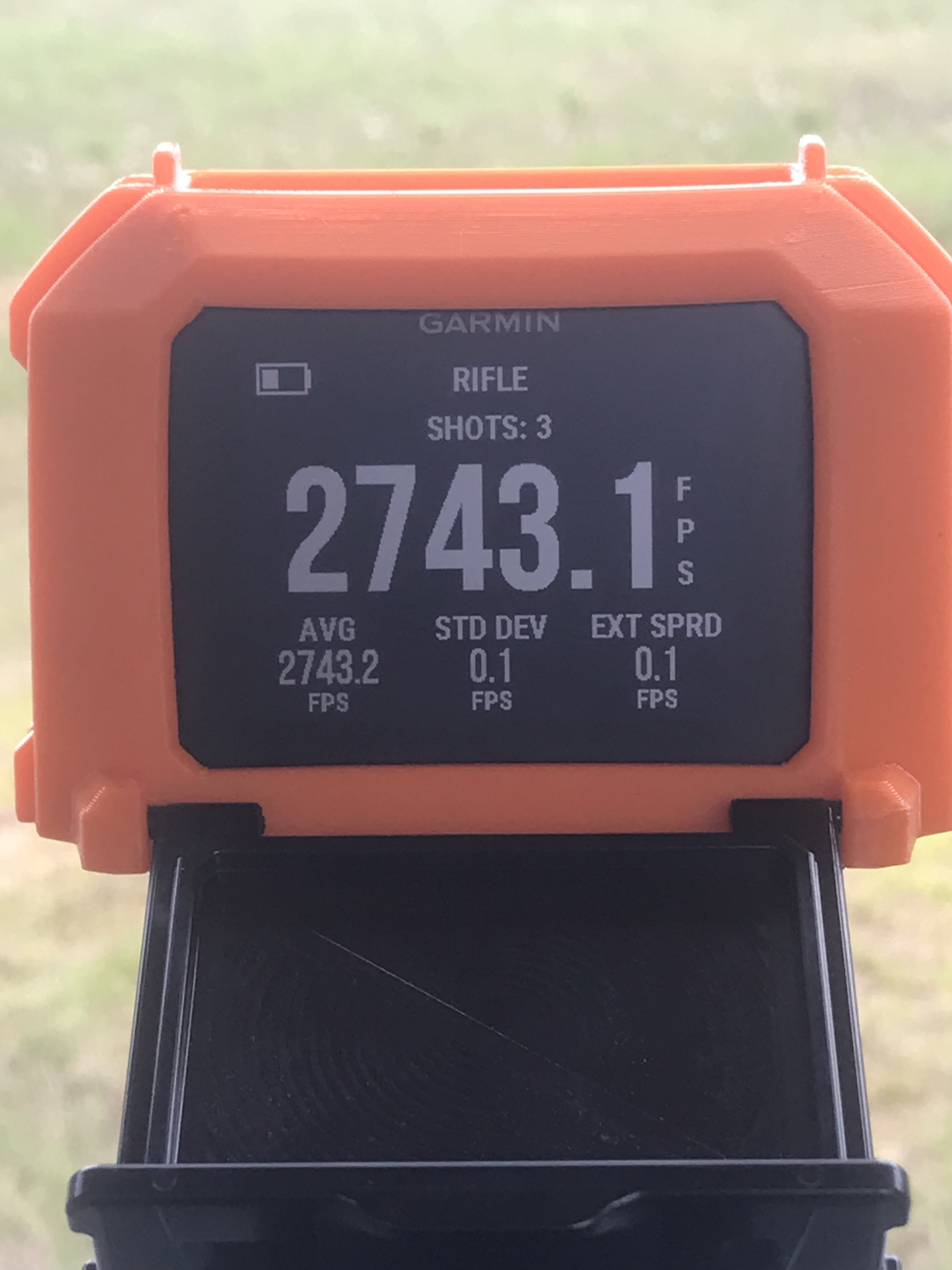

All my data logging has shown 0.1gr of my H4350 is worth about 6 fps. 38.8 is now at 2775-2780 avg. I'm going to slow it down, it shot more consistent at 2720.
Gotcha. Ya that is what I noticed too right at the 2715-2720 range. Im guessing ill be right around 37.4 gr to get back down to that.
She gets punchy at 2820. That’s for sure. I’ve been shooting fast stuff the last few months, like a 6 creed. Slowing this down to 2700 for 150 rounds, then bumping it to 2820 made a heck of a difference.

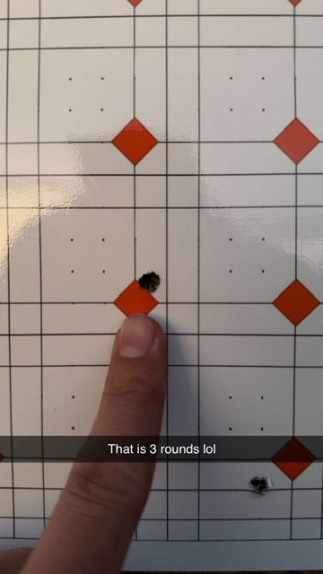

Here is 3 at 100Y at 2715 FPS during fire forming. SD was 8 over 20 rounds.

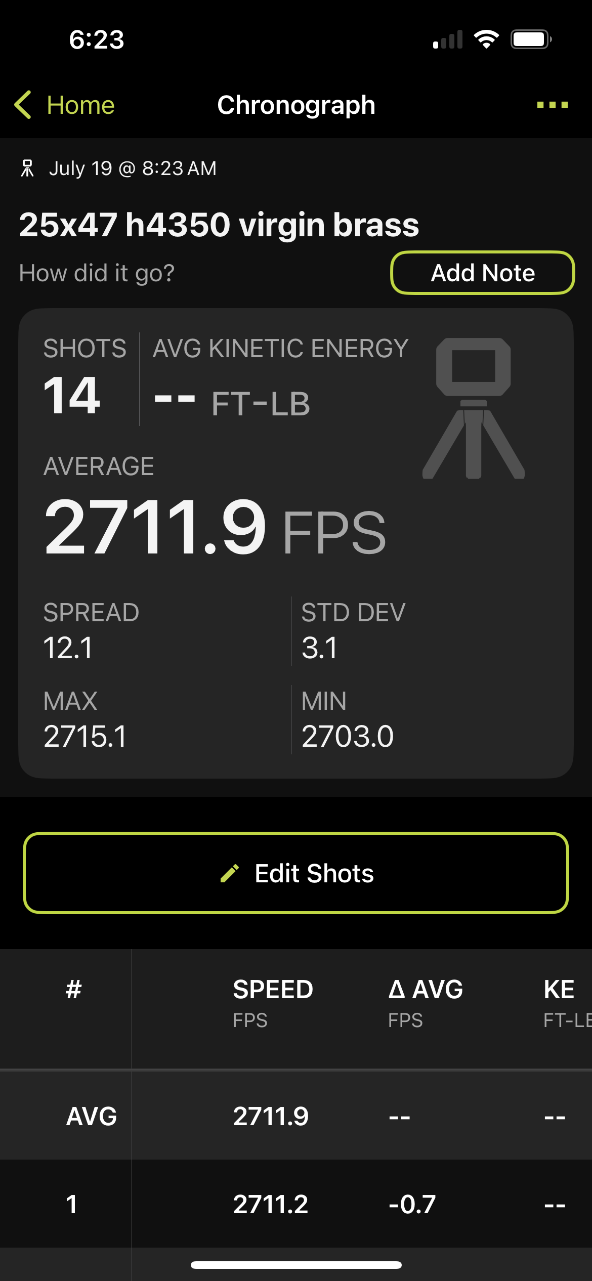

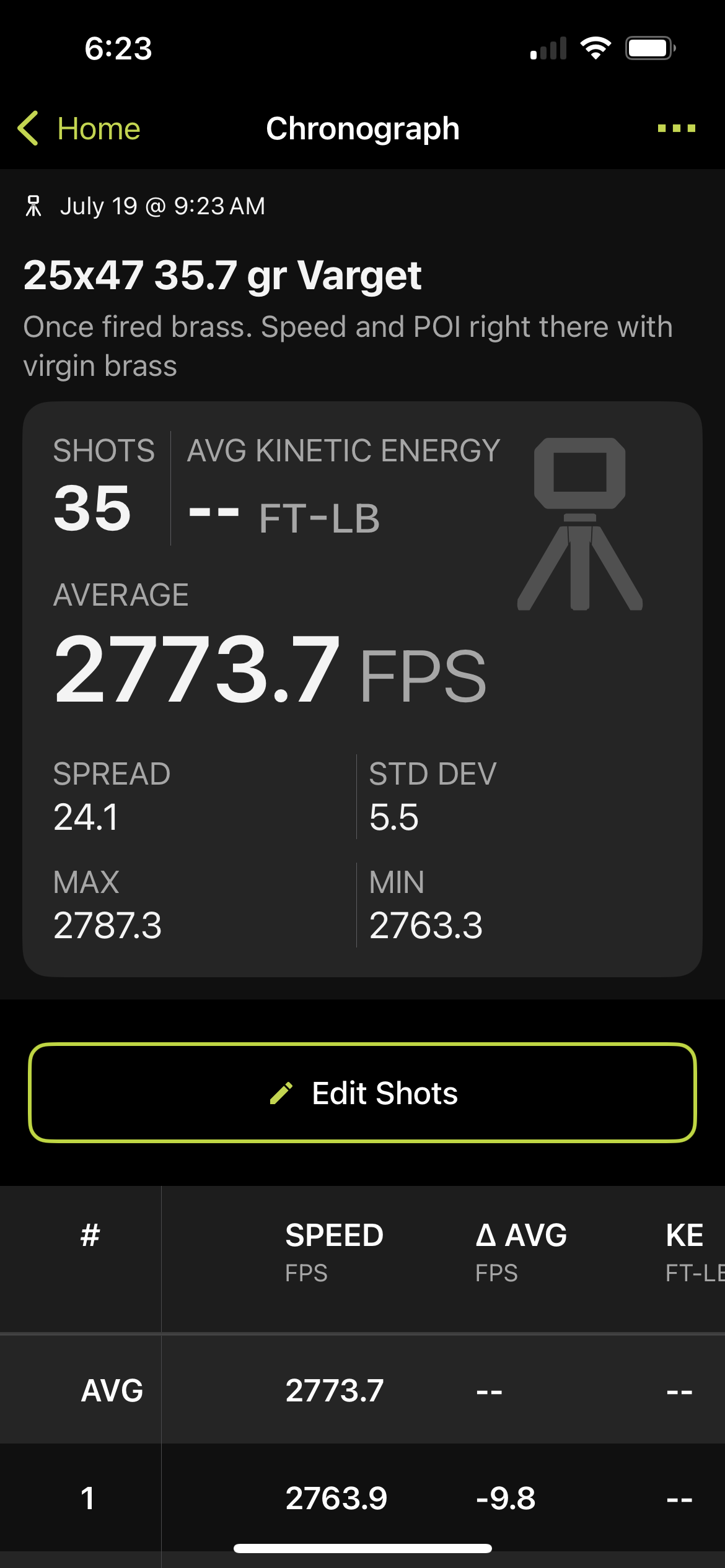

This thread helped me out a lot. It’s been a real easy round to load. It shoots great with no real load work up. The recoil impulse, especially with Varget, is really nice. I shot the first match with it and was able to see every impact/miss (coming off a 260 running 130s at 2820 where I saw a lot but not everything)
26” PBB MTU
35.7 gr Varget
134 ELD-M
Mag length minus about .015”
2770
It likes 4350 too
