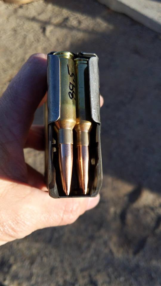

Got some great messages from an AR10 shooter today.

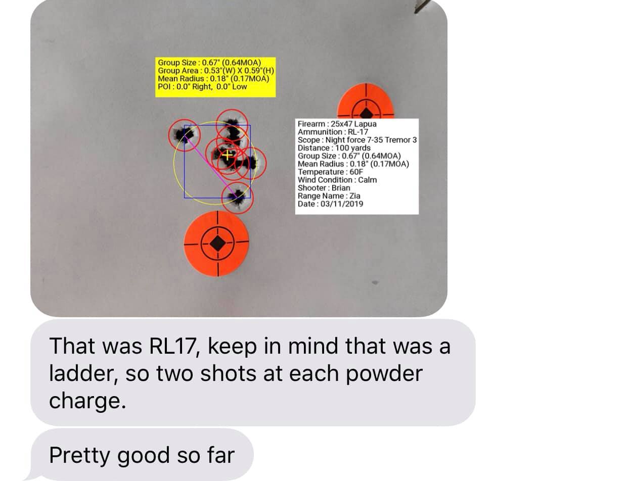

25x47L running 2850 - 2950 from 24" tube.
131 ACE at 2950 fps yields about 1640 yds Supersonic at 0 DA and 1760+ yards at 2300+ DA. Not bad for a little cartridge and little bullet.

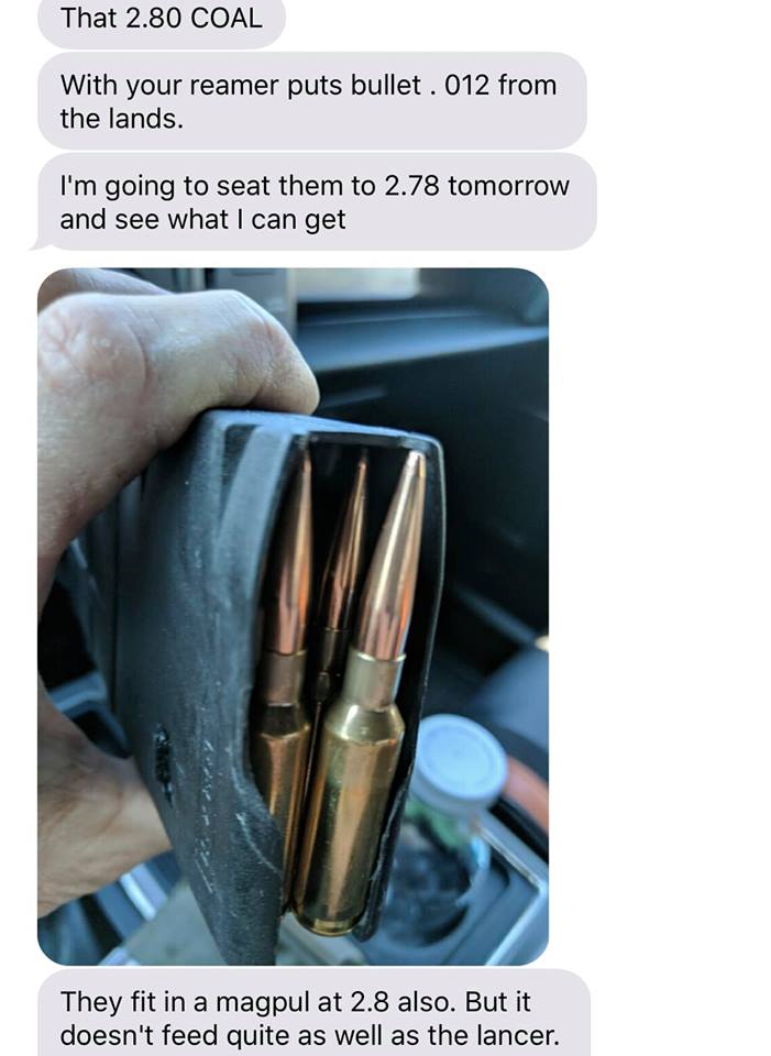

General feeding testing and powder ladders today. Shooter said with a little tuning to Lancer Mags they are flying into the chamber without a hitch.
I'll be sending out my 6.5 Creedmoor AR10 to the chop shop for a 25 Cal upgrade very soon. Been meaning to do it but this fella worked out a lot of the kinks before I got around to it.
Now that he's lined out feeding and general pressure windows, I can't wait to see what kind of load tuning he can wring out of this type of setup.
