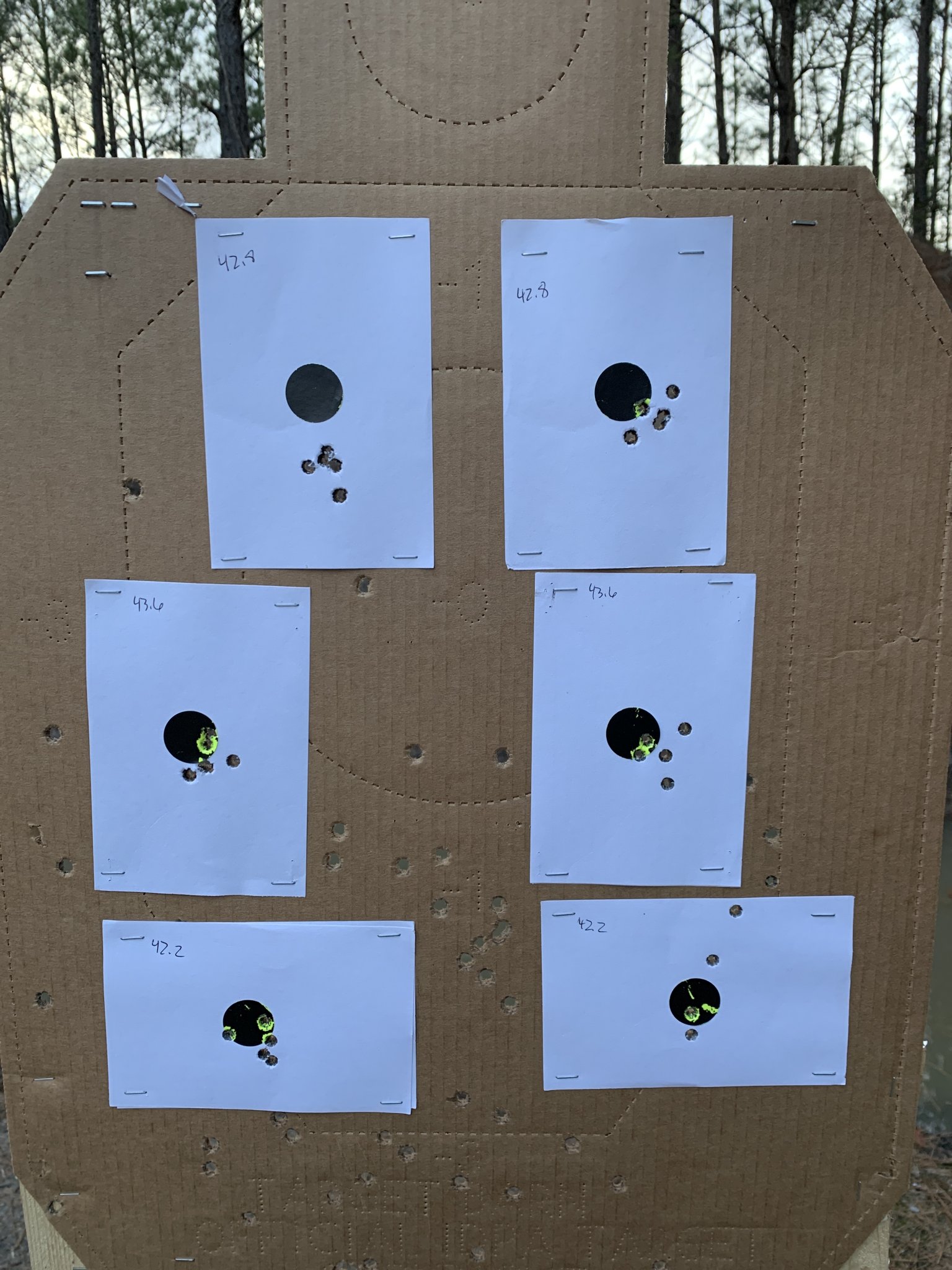

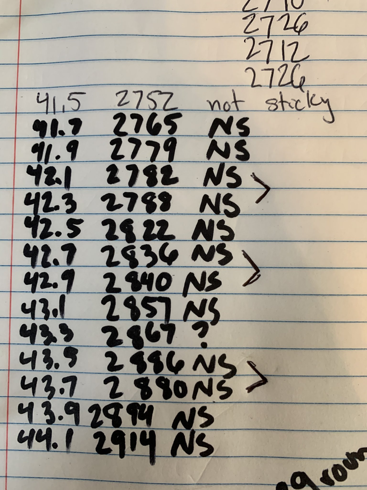

Got down to the range yesterday. Went through barrel break in, and then did a ladder test. This is what I found. I’m going to load 15 at 42.8 and 15 at 43.6 and head back down. This was all without the can. This is lapua brass, gm210m, h4350, 140 ELD-m. 26” barrel. Only 29 rounds so may speed up.

42.8 looks the best, I was moving around and writing down velocities (hence the shitty groups) It gave me an ES of 4 when I got my chronograph working correctly. I wanted 43.6 to be much better than it was. The bottom right target I was zeroing the rifle so don’t pay attention to that. Any advice? Should I trust my old school chronograph? Lol
Have you tried playing with seating depth?
Honestly, I’m not convinced that 43.6 was a node. Just because you are close in velocity doesn’t mean you are near a node. Notice how it drops down at 43.7 and then jumps up at 43.9? If you were to chart that, it would not be a plateau.
And personally, I’d wait to do serious load work up until you have a few more rounds on the barrel. Until then, shoot 42.8 and be happy. 2850-ish is plenty fast for a .260 without entering barrel burning territory.
After this afternoon I really don’t trust my chronograph. I had some readings around 1700 and one string where my ES was 4. I’ll be investing in a better chronograph shortly.
