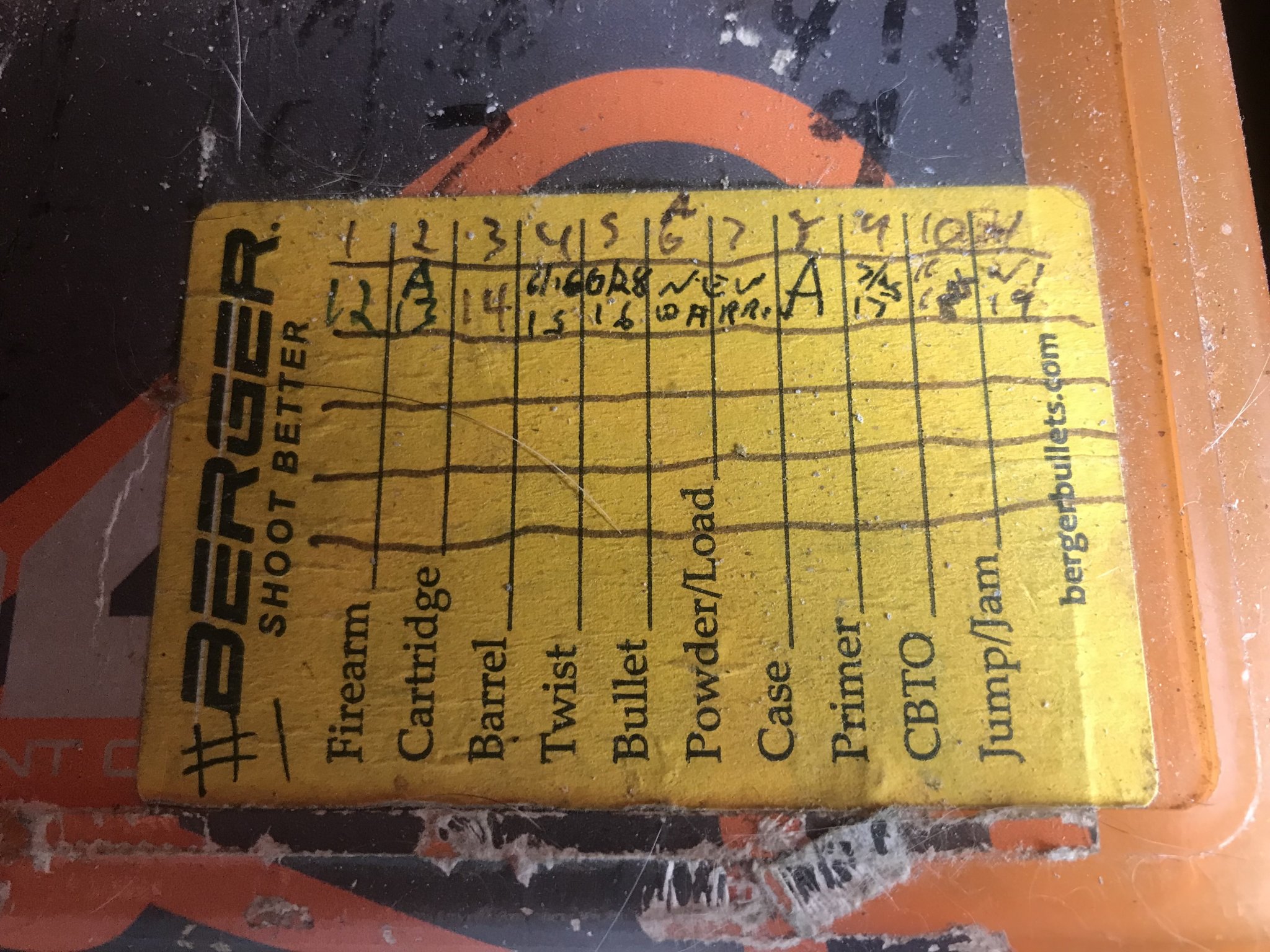

An Old BR guy told it to me about 8-9 years ago and it’s worked for me over the years.
recently a quite accomplished F class did a video snd he said the same thing.
Something must be working because this is some of my 7 saum brass.
It’s on its 19th loading.
Man if I could get that many I would be a happy camper. I have with 308 but not with the 260.
