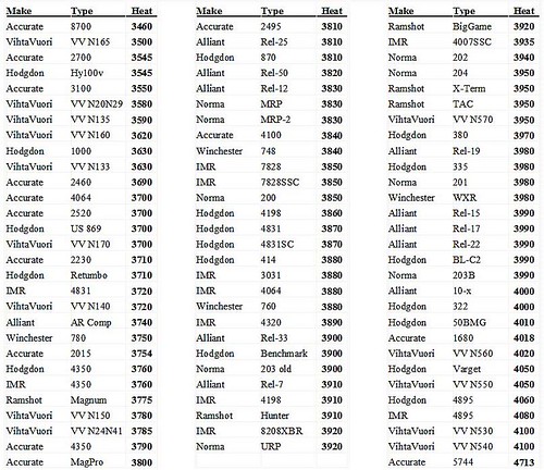

Not all is lost. You have two data point temps and their respective velocities. They show an average of 2fps per degree of change. An easy calculation that can even be entered in many ballistic calculators.
You can even verify this by shooting at another data point temp and seeing how close that gets you.

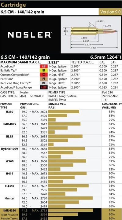

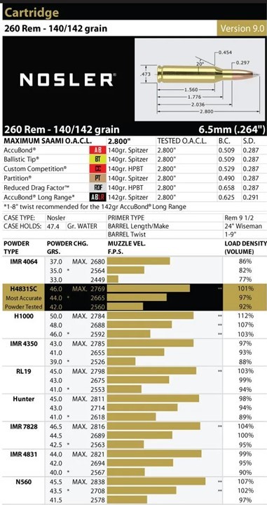

My point was to gently suggest you may be loading too hot. Nosler load data caps out below what you tested for the 142s, and they tested in a 24" barrel, which adds about 20fps in speed per inch over your 20" barrel as the powder has more time to be fully consumed.
There are several variables affecting QuickLoad outputs, and the QL data tends to be conservative, but I'd suggest you're chasing speeds you may not attain in a 20" barrel (even after it speeds up) and to offer that your loads could be overpressure.
Recheck your Garmin settings as there are probably tens of thousands in the field and I've not seen any reports of faulty speed captures. You could move the unit from one side of the rifle to the other, or over the barrel to try to confirm consistency.
