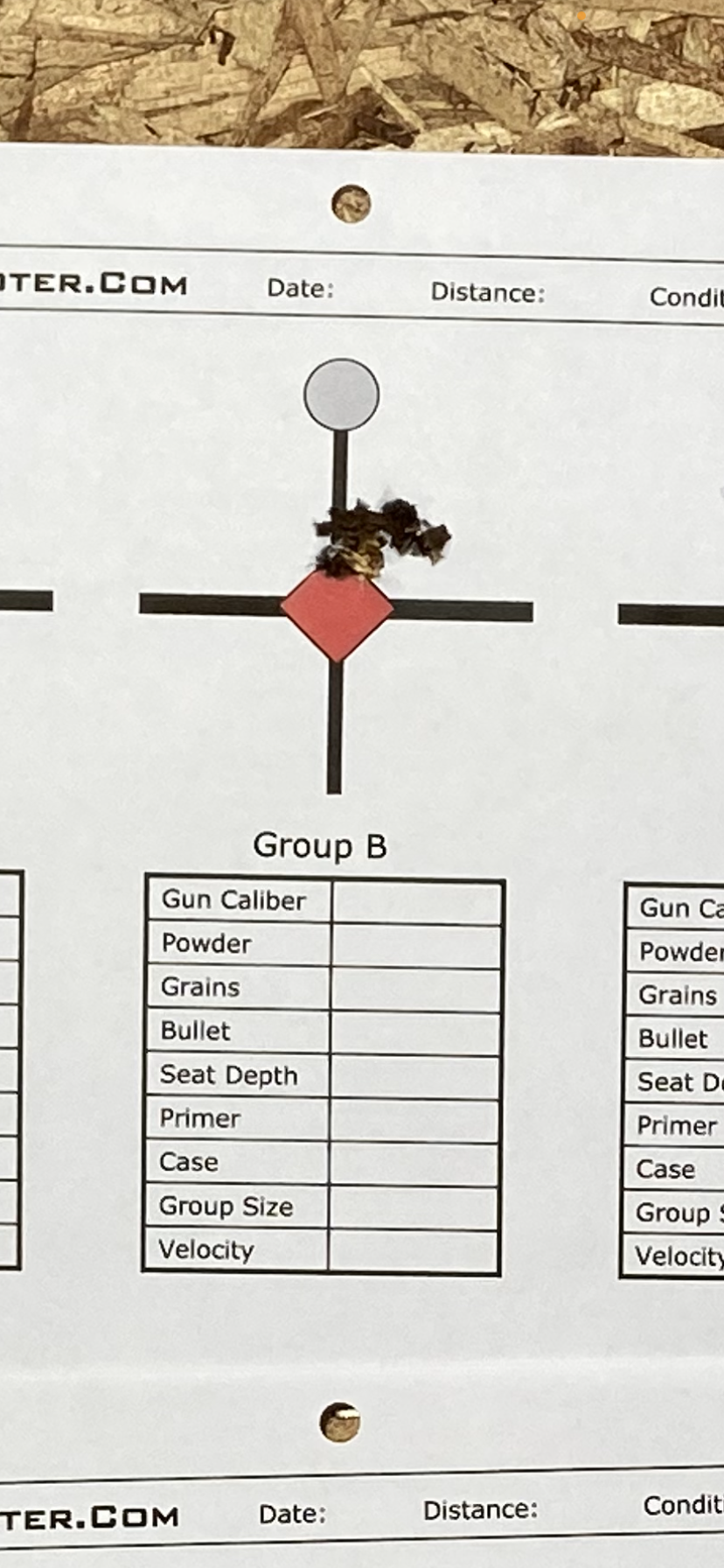

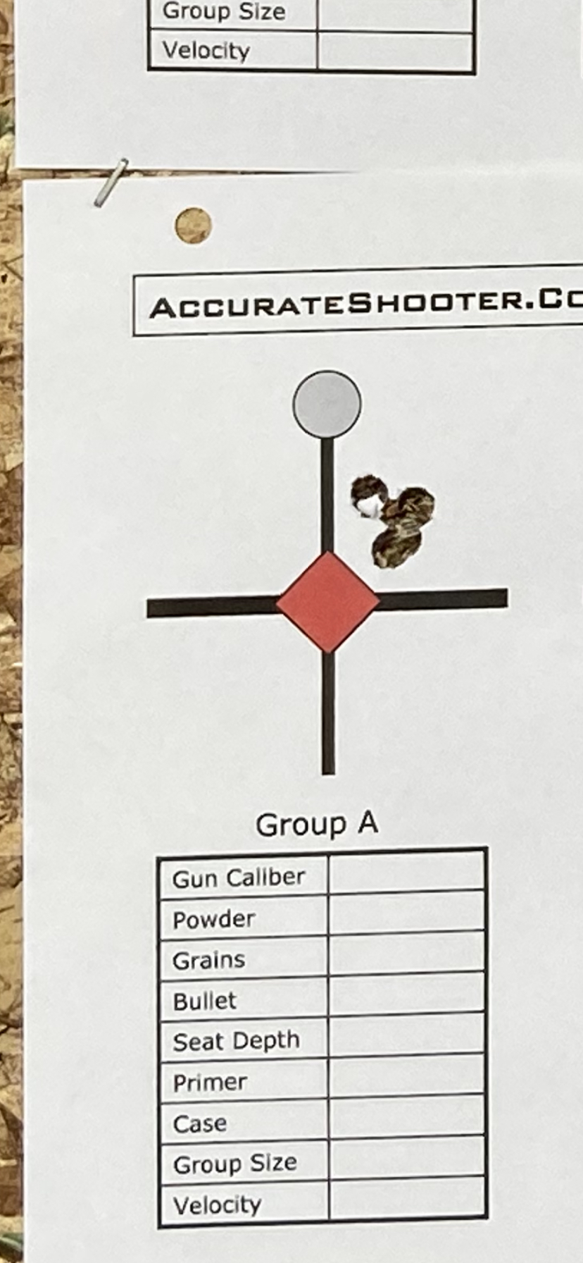

Did a seating depth test with the 162Amax. Same load as above:
<ul style="list-style-type: disc">[*]
5 rounds @ .025" jump
5 rounds @ .020" jump
5 rounds @ .010" jump
5 rounds touching...[/list]
All the groups are "good", haven't measured them yet, but will this evening and re-post with picture. It appears "touching" the lands with the Amax is the best. And I noticed a velocity increase the closer the bullet got to the lands.

Pics of the seating depth test above^^^^^^:

280 AI (27" Barlein 1/8.7 twist)
57.5 grains of IMR 7828SSC
Fed 210M
Berger 180 grain Hybrid
0.025" off lands
Nosler brass
2793 fps with ad SD of 9.0
0.25" x 3 shots at 100 yards
Most recent load developments using Alliant RL23 (really liking this powder in the 280AI :)).
168g Berger VLD Hunting
Nosler Brass
F210
58.7g Alliant RL23
Vel = 2969fps
180g Berger VLD Hunting
Nosler Brass
F210
56.8g Alliant RL23
Vel = 2842fps
