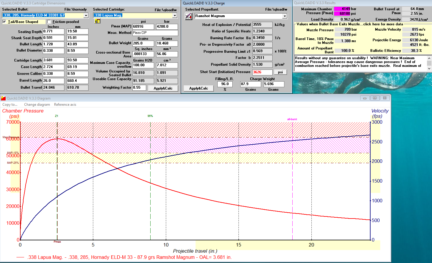

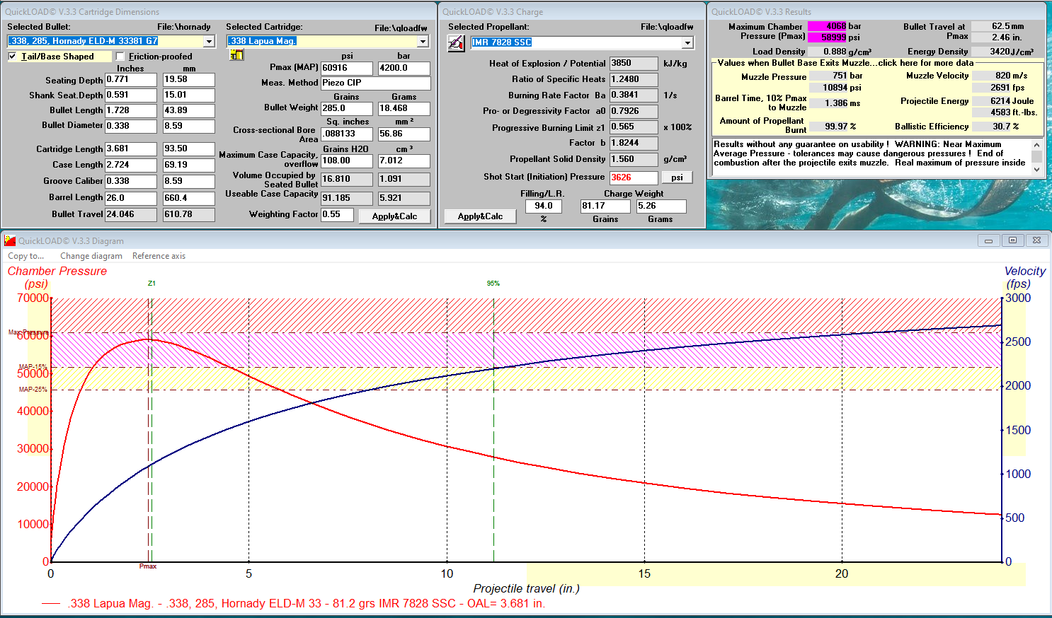

I ran your powders through Quickload to get ballpark numbers for you:
IMR 7828SSC is a tad fast, but you could still get decent velocity. You should start seeing pressure >91gr
Ramshot Magnum is similar, with pressure probably showing up > 87gr
