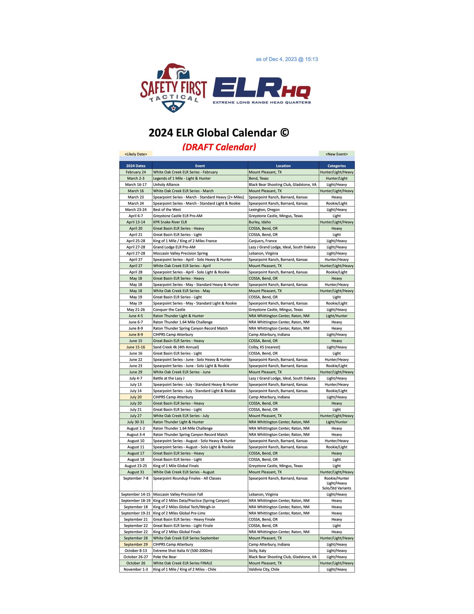

I live in the Charleston SC area. I am not on Facebook. It seems like the only way to get location and dates for ELR events is through Facebook. Does anyone have recommendations for getting access to ELR calendars and any recommendations for an even close to Charleston SC?
I am also new to ELR (lite). My 300PRC build is about complete. It is based on the Rukus LA and 30" Bartlein.
Facebook seems to be the best way. I hate it also but it seems to be what goes, it's even that way for a lot of other matches, hard to find out about with out just accidentally coming across it. Here is the current projected schedule from Safety first ELR
