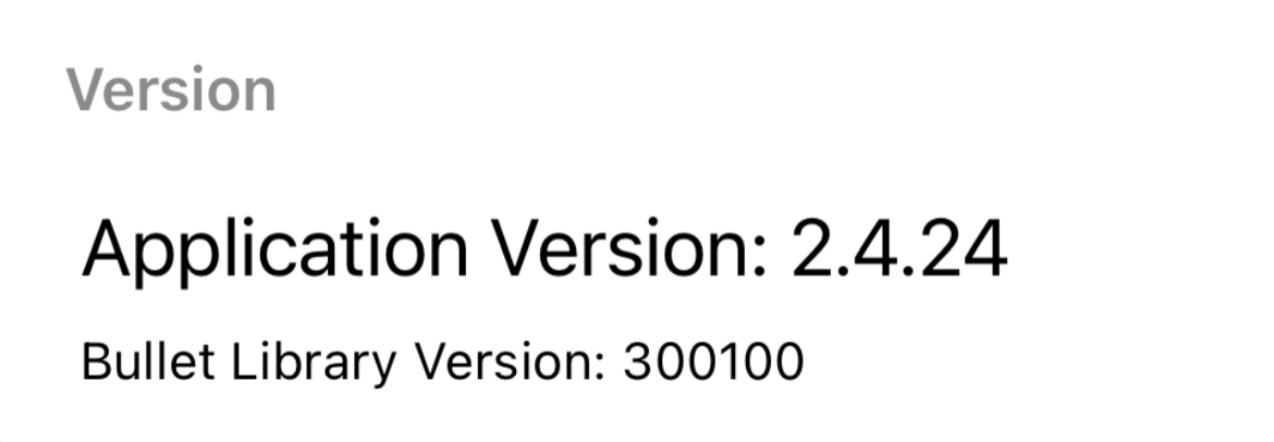

Here are the versions on my iPhone.

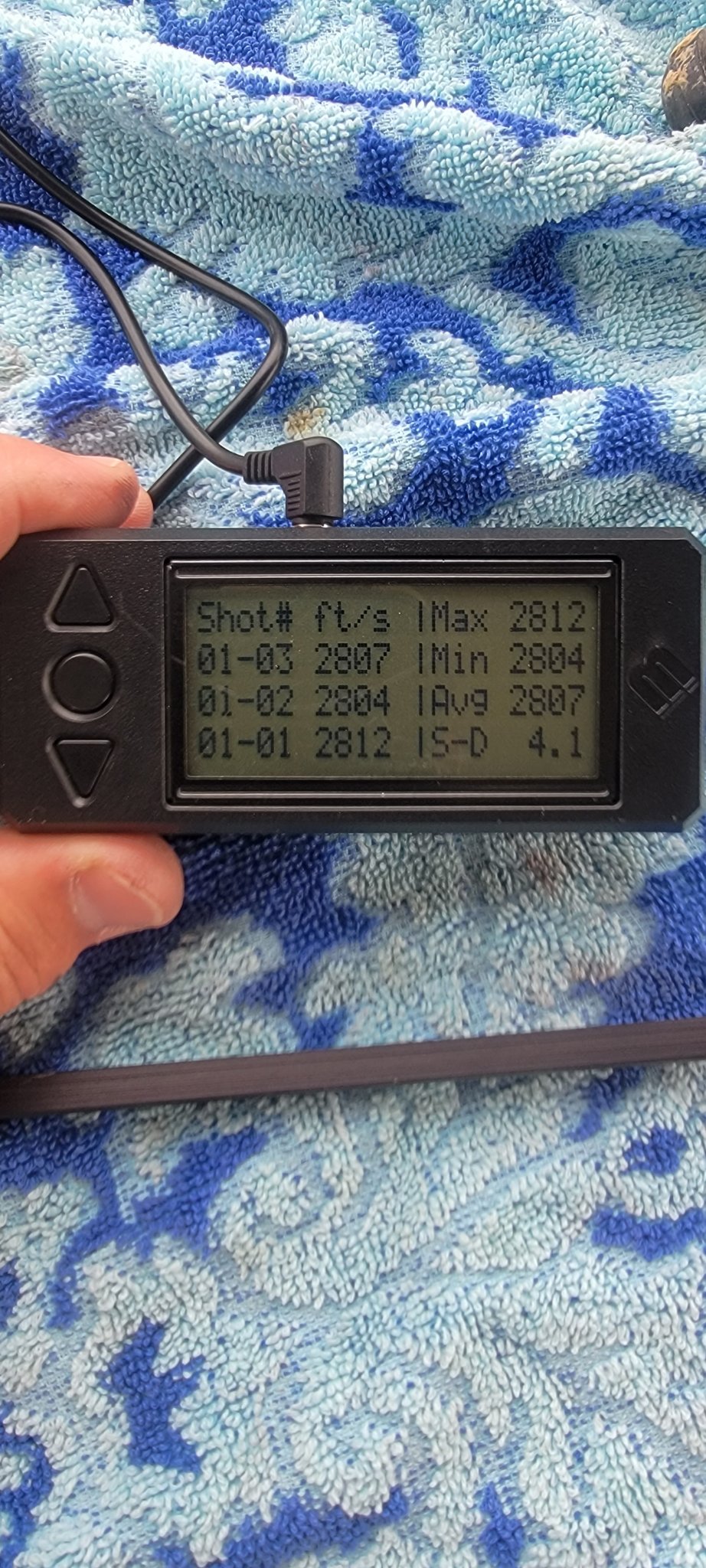

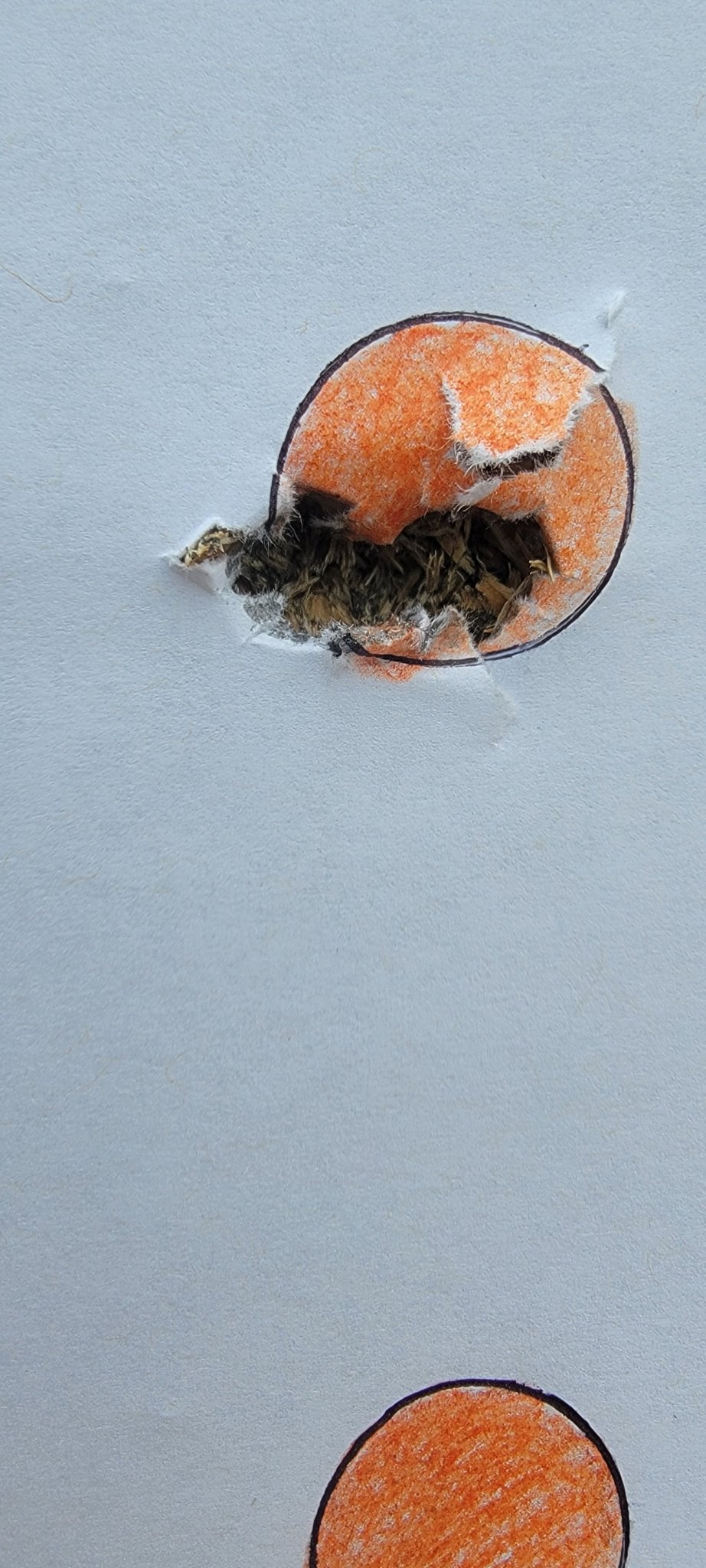

Did a little test with the 250s this morning. This barrel isn't with my reamer and not the barrel I plan on using. I had easy bolt lift but a click at top of bolt throw.
76 grains n565
250 a-tip 3.740
3 shots
Really need some n570 for more speed.
76 grains n565
250 a-tip 3.740
3 shots
Call Salida Gunshop in Salida CO. they had N570 last week and I believe they ship. How long is your barrel? twist rate?
