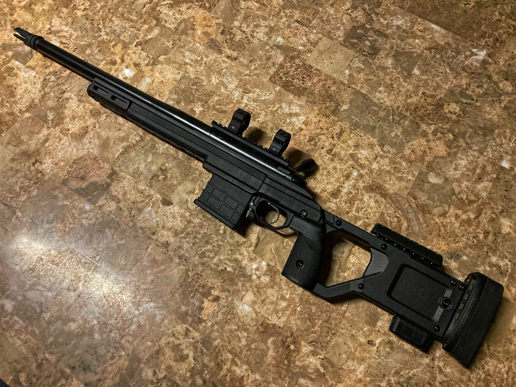

I had Caleb over at Alpha & Omega spin together this one for me last year.
16.5” 300 Blackout
Zermatt Origin
KRG Xray
Topped it with one of the Crimson Trace 1-5 scopes.
It does everything I need it to do.
Reactions: FuhQ

I like the 308 for its multiuse capabilites, could keep a mag with full power loads and select a different zero in the thermal scope for coyotes that hang up. I do not know the case fill with some of the powders used in 308, really dont want to play around with possible double charges or hangfires.
Pros for the 300 BLK is I a have a Howa .223 bf action sitting around and a couple thousand .223 Lapua brass laying, and plenty of CCI 400s. Would have to find powder.
Either rifle would be cut at 16.5, running a TBAC Ultra 7, and a chassis. I will need a chassis that can collapse to a very short LOP for a dedicated thermal scope, but can extend out for daytime plinking with a day scope.
What direction would you go for the cartridge and chassis? Any holes in the build I haven't considered?
Subsonic .308 Win is a tricky beast. I've been making them for years. For case fill, use Trail Boss powder (large donut grains).
Prefernce over the 2 for mostly subsonic and plinking, I'd go .300 BLK. It utilizes all the powder and potential with subsonics at subsonic velocities, and isn't wasting any potential. Running the .308 Win with subs is a whole different beast. Like I said, for ease of use, I'd just stick with a .300 BLK and H110, CFE-BLK, Lil Gun, or 300-MP powder with subsonics. Because a .308 caliber bullet being pushed to 1,050 FPS will function the exact same, regardless of whether it's being shot from a rifle chambered in .300 BLK or .308 Win. Best efficiency is a cartridge designed to do that from the start... Like the 300 BLK.
