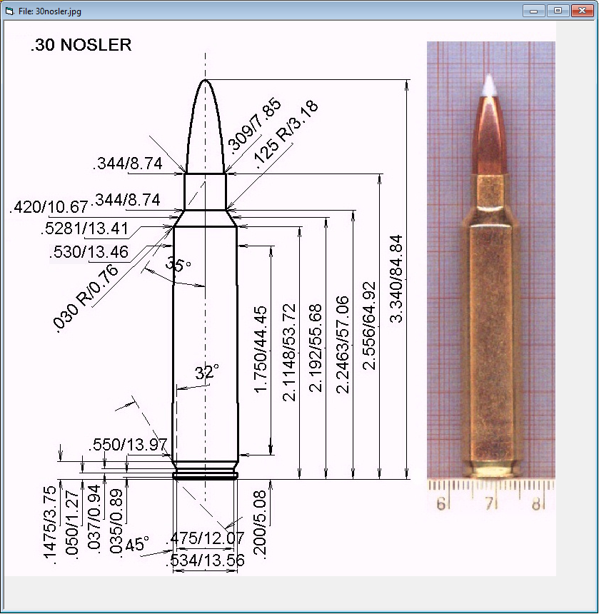

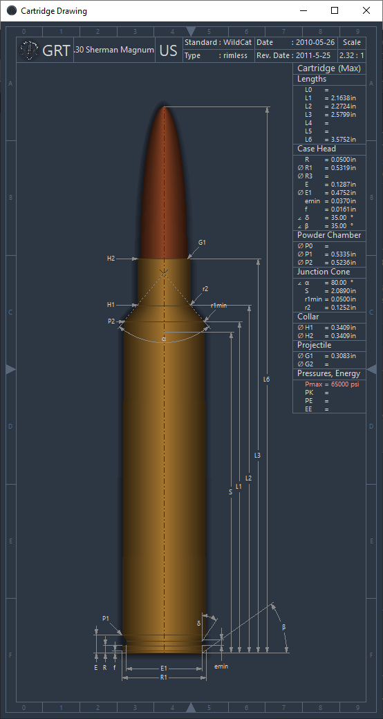

    So not trying to pick fights or start wars, but I am trying to objectively understand what the differences are. If I have my dimensions correct (if not correct me please), everything is so close, that you can almost fire one round in the other's chamber (I am not condoning this, its a bad idea, but you get the point).
    A little backstory, I was looking for my next big 30 magnum and came across the 30 Sherman magnum. Seeing at it was a AI version of a 300 PRC, for which factory 300 PRC ammo shoots great in its chamber, I started my journey of reading all the different forums on it. I saw that its H20 capacity was similar to 30 nosler as well as MV with similar brass/bullets/barrel lengths, so I started looking for the differences to see which one made more since for me. Note: I will have a barrel spun up and I reload, so no need to bring in the factory rifle crowd.
    I found the SAAMI specs drawing of the 30 Nosler on Quickload as well as the 30 Sherman Magnum's drawing on Gordon's Reloading Tool (neither program one had the other's cartridge so couldn't do a proper comparison of loads in the programs). Here are the images.
    First of all, does anyone with experience not agree with these dimensions? If so, no need to read the next paragraph...
    If not, what I found was they both have a magnum bases (.534"). 30 Nos is slightly rebated with a base diameter of .550" and 30 SM stays at 0.534". The Nos has a little more taper but due to the wider base and shorter case/shoulder junction, the Nos has about the same case diameter at the shoulder - 0.004" larger ( 0.528" vs 0.524"). The case/shoulder junction occurs at 2.115" for the Nos and 2.164" for the SM (so 0.050" difference) but with the 35 degrees (Nos) vs the 40 degrees (SM), the neck shoulder junction is closer to each other at at 2.246" vs 2.272" (Nos vs SM), a 0.026" difference. The SM also has a 0.024" longer neck so the SM has a case length that is ~ 0.050" longer. Throw all this into the regonculator and they have the same case capacity, and for the same bullet they are within 0.050" in COAL (for example, a properly seated 215 Hybrid is just above 3.600" for Nosler - just choose jump to get your needed freebore).
    I know the standard 30 SM reamers have a nominal freebore setup for the heavier bullets so a 215 Hybrid will be higher in the neck and COAL will be up around 3.700+", but you can get the Nosler freebore'ed to do the same. I am just now figuring out that all of these cartridges are the same if you get to choose your freebore? Am I overlooking something or not giving something enough credit/weight?
    So my question to all - does everybody agree that if I hand you two rifles (one chambered in each), that you could not load one better than the other, know which one you were firing if given to you blind, or even giving you one round of each could you tell me which is which (no peeking at the headstamp)?

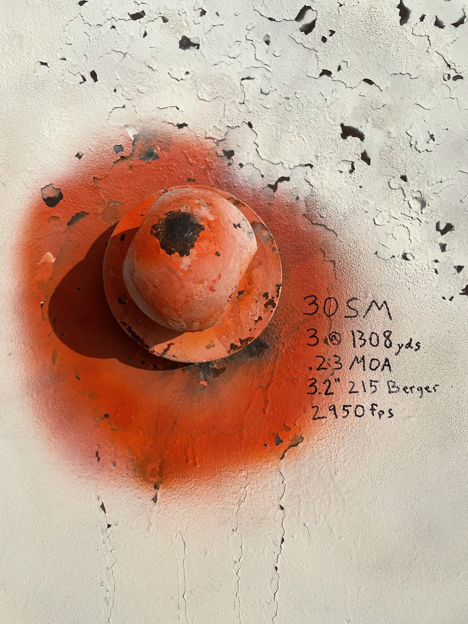

    I have a 30SM, it pushes 215s 2950 in a proof cf 20” barrel with n570. I know of 2 other 20” 30 noslers pushing ~2975 with 215s and n570. The 300prc 225 eld m factory ammo shot terrible in my gun. I even tuned the seating depth on the factory 225s and they still shot bad. The 212 eld x factory ammo shot ok as is, but I reload so it doesn’t really matter to me. I like the 30SM and have no complaints but when I rebarrel I may just go with the 30nosler. 30 Nosler is the easy button if you want a little more velocity than the PRC and adg brass is good. With the 30SM you have adg and lapua but I have not tryed lapua because Rich set up the reamer and dies around adg brass.

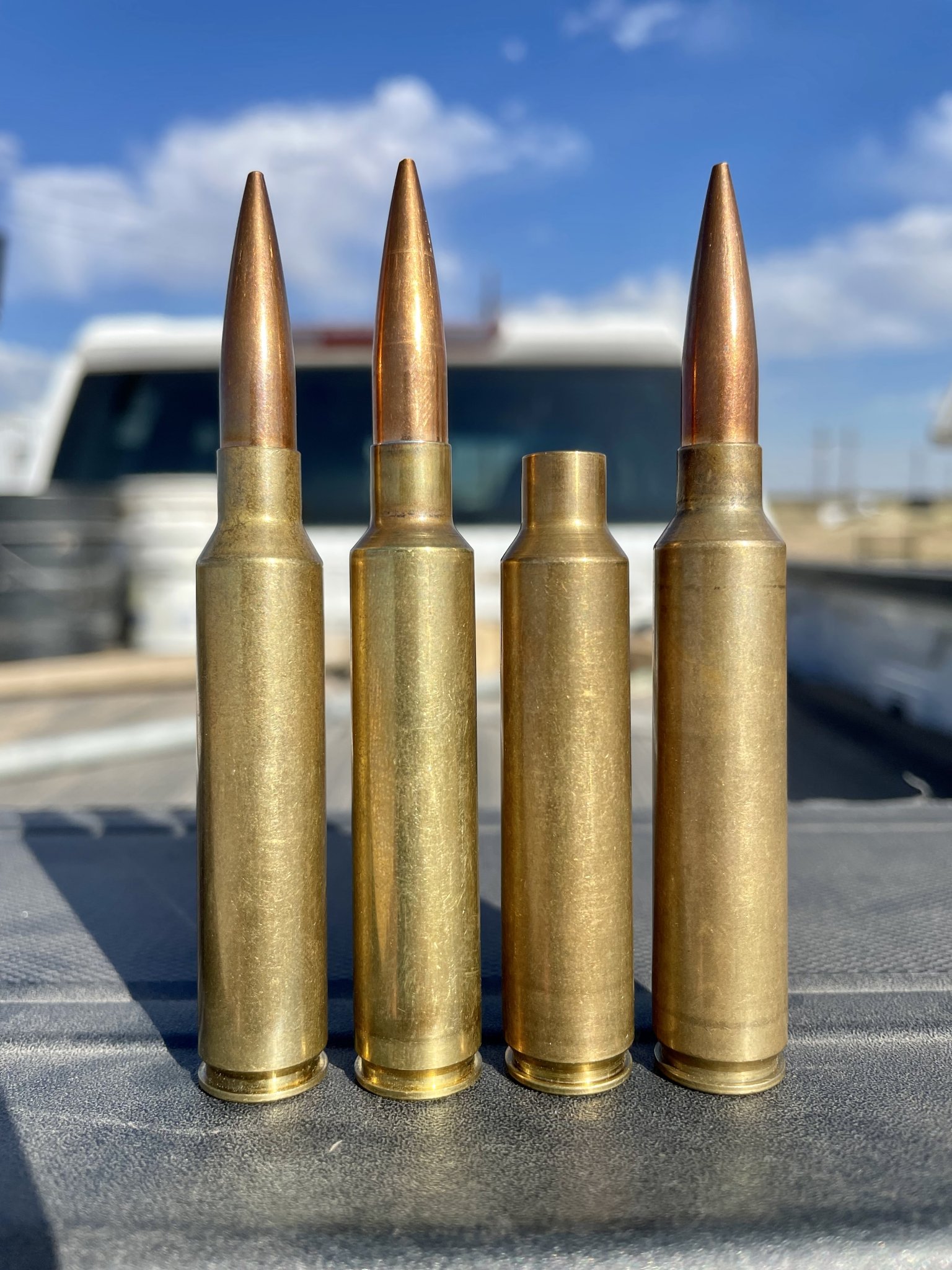

    As requested by the op here is a non labeled pic, although it’s easy to tell. 30-28 Nosler, 30 Nosler, 30SM, 300PRC with 215s

    2950fps is where I saw accuracy.
    I will do some explaining though before ppl start coming in bitching and crying that this is another example of running a Sherman at 90k psi.
    I see a lot of hate for the Sherman’s and I get it. Most of the time the max velocities posted for Sherman’s are higher psi loads.
    I wouldn’t expect to build a 20” 30 Sherman Mag and run 215s where I am. 2850-2900fps with n570 is more realistic. With n570 I start to see a faint ej mark at 86gr 3000 fps and my load at 2950fps is with 84.9gr and is a warm load no doubt. I have over 600 rounds on the barrel and have run 5 shot strings with this load in 105* summer temps and never experienced any typical pressure signs, but it is pretty warm like I mentioned. This is with adg brass, n570, 215match primers and a proof CF barrel. I have 6 firings on 100 pieces of brass now and at 5 I started to get light clickers on brass not because I have a die issue, simply because it’s a pretty warm load. I realize with brass like alpha, adg, peterson, and lapua you will be at higher pressures before you see typical pressure signs. I wanted to run these at 2850-2900 but after testing they shot best at 2950 with 84.9gr. Just for a test I loaded 1 piece of adg brass at 85.5gr and shot and reloaded it 8 times but could have gone more. After resizing that piece the last time the base above the extractor groove measured .5326” so that was obviously hot but I was just pushing a piece of adg brass and it shows to be pretty tough stuff. My current load of 84.9 has the base measuring .5315”
    If I were running a custom action I would probably continue running this load because it shoots so well. But I’m running a Rem 700 action so about a week ago I decided to drop down and test around 83.4-84gr at 2870-2900 fps just to give me a little more margin for error in case water or dirt get in the barrel as this is a hunting rifle. As I experienced in earlier testing it will shoot some great groups at slower velocities but they are not as consistent. So now I have ordered some more bushings to experiment with different neck tensions and see if can find a consistent accurate load around 2850-2900fps with the 215s.
