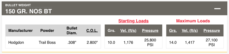

For those using Bullseye in their sub rounds, is anyone using it in 308 or is it only used in 300 BO? Is there a good source of reloading data for Bullseye in a 308 sub? I know Hodgdon published a 308 sub loads using Trailboss.
7101482
Source: http://www.hodgdonreloading.com/data/rifle
