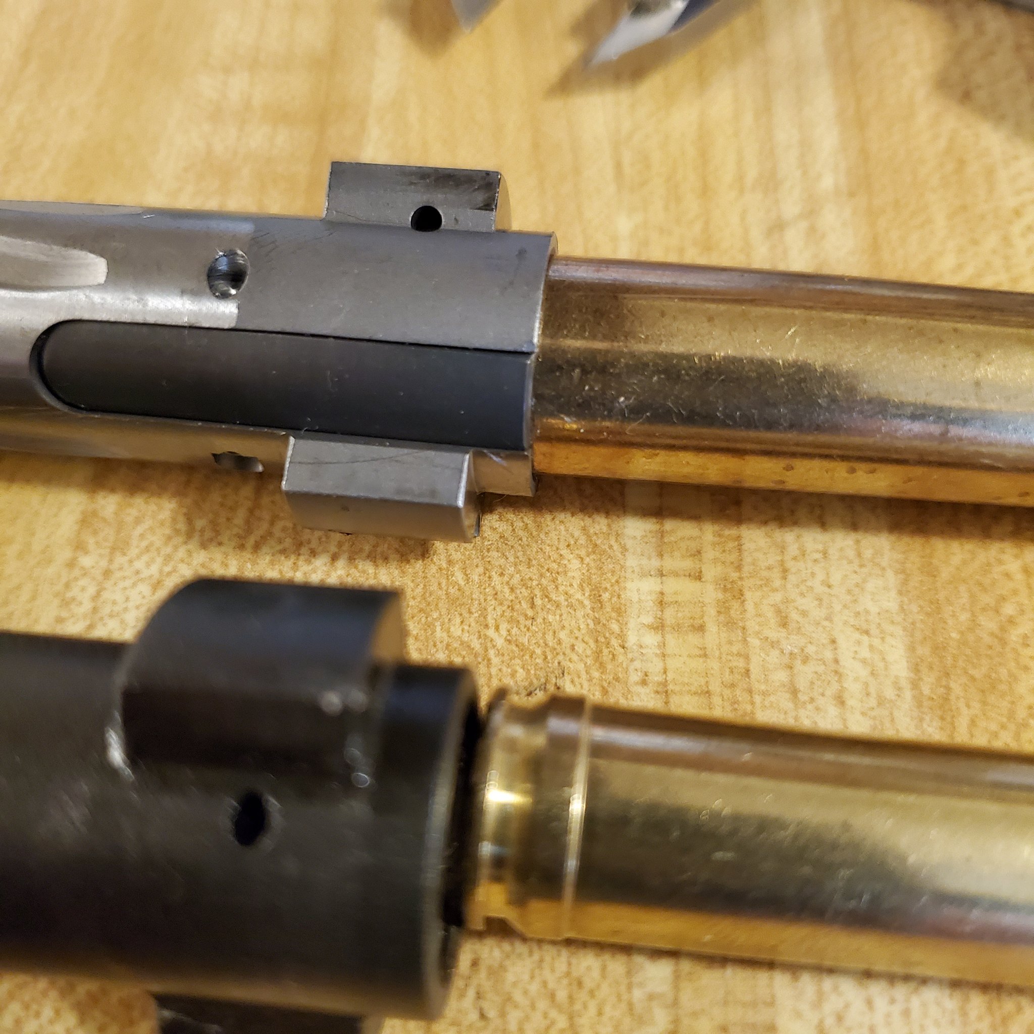

    So here is a 300 NM in Remington 700 bolt with m16 extractor, which allows the counterbore clearence, with the case in place,... its below the bolt diameter, as pictured.
    It works...but it's not for the average guy, as the parts need fitted. So a lathe and milling machine are handy to own. Other than that it aint hard to do. True the action, increase the thread dia, then increase the barrel thread dia to match, the trued action. Chamber and thread for muzzle brake, drop in aluminum chassis, MDT mag for longer COAL and you're good to go...a cheap 300 NM that will shoot accurately.
    A factory 300 WM bolt for comparison.
