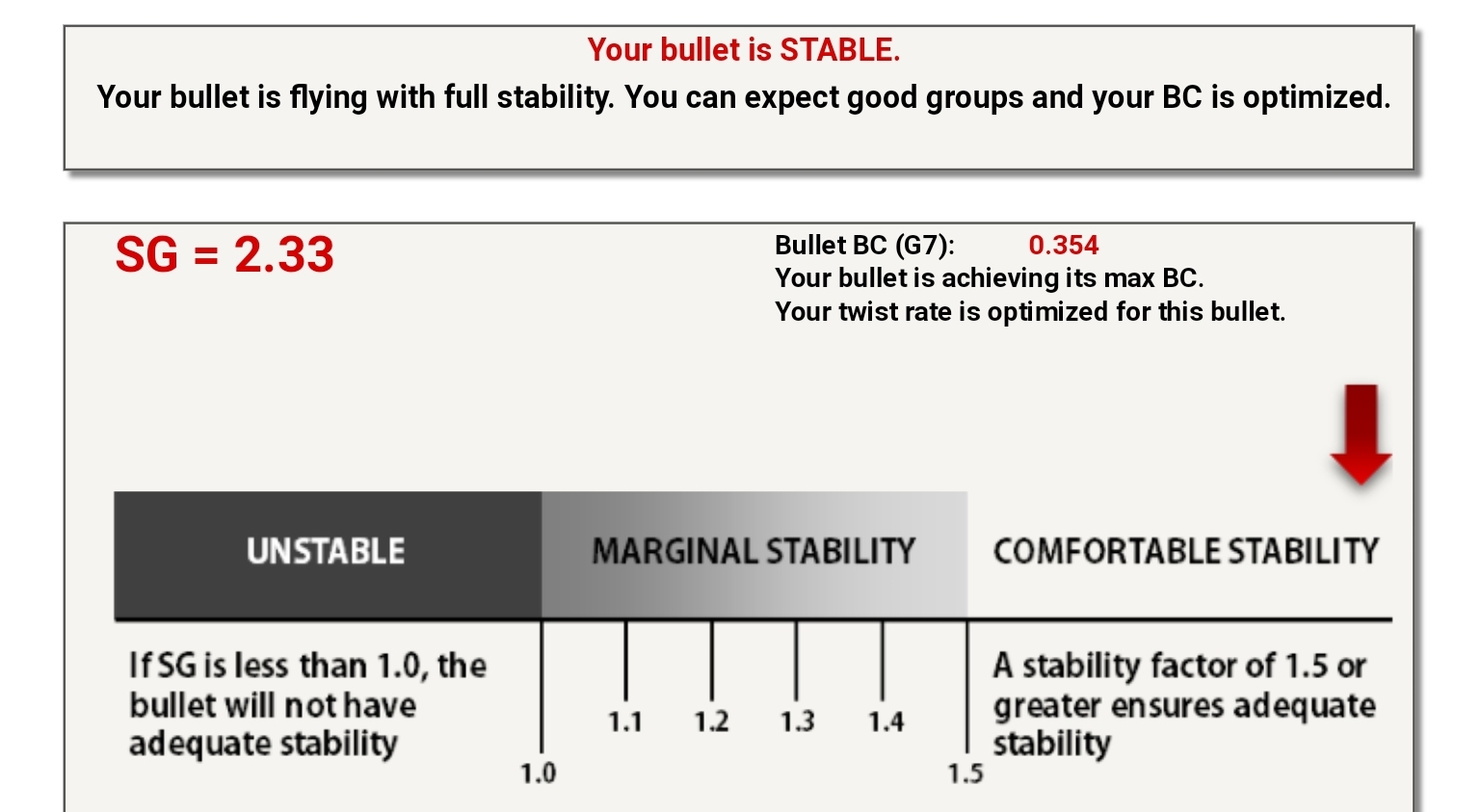

Join contestI went with a 10 for a hunting build. When you run the calcs the 10 is just fine especially at the altitude I hunt at. I did go 9.4 on the gun DT rebarreled.
Punch in some calcs here... http://bergerbullets.com/twist-rate-calculator-3/
Using the 215 Berger hybrid at 3k fps. A 10 twist is 100 percent stable at 0 degrees at 4k ft altitude. The 9.4 twist barrel I have is 100 percent stable at 0 degrees at 500 feet altitude.
Unless I'm doing a long range coastal bear hunt in 0 degree weather at sea level, I don't think I'll ever have the slightest issue. Even then your only losing very little BC. For the extreme weather and low altitude the 9 or 9.5 twist may be the best choice.

What is the negative effect of SG's into the 2's?

Many times nothing at all. Lately it’s been the in thing to do, as it’s been shown to increase BC slightly. It’s pretty hard on the bullet though. What may work initially on a fresh barrel, may start showing issues as the thoat become rough from erosion. There’s also a chance the core could shift in the jacket.

I get that ppl state bullet busting loose at the seams from over rotation...
Its does seem to be the direction things are going with faster rates...
partly my question..ppl talk about over rotation and the issue of it...what are the issues and why...
Will a throat kno the difference between an 8" twist over a 10"..? And if so how? Normally pressure doesn't change with twist rates, correct?
Forcing the projectiles to twist faster may put more strain on everything...in my mind...I dont kno...
I read Dave's post and understand his liking is a 1.5.....that's what lead me to the question....I'm looking for an explanation...some science or something as to why over 2 is not a good thing....or might could lead to not a good thang...

Nice...thank you...good stuffThere are far too many variables to nail down exactly what you’re looking for. Also, there is no wall, no threshold, that delineates exactly at what SG things may go bad, because of all those variables. Adding twist has a negligible effect on pressure. The physical forces obviously go up. Going from 10 to 8 twist adds roughly 50k rpm for example.
The throat doesn’t “know” anything, but it’s surface finish changes due to erosion. Between a fresh throat, and a hammered throat, it’s easy to imagine that the bullet is going to have a harder time engraving the hammered throat, and the bullet jacket is probably going to take some additional damage. Lots of evidence to support this. Many here have talked about combinations working well, then late in the barrel’s life, bullets start vaporizing, or behaving erratically. Generally those are hotrod cartridge combinations. I shoot varmint bullets out of many of my rifles, and they’re all fast twist. Some of the SG’s are well into the 3’s, and I don’t recall ever having a bullet blow up, go figure.
