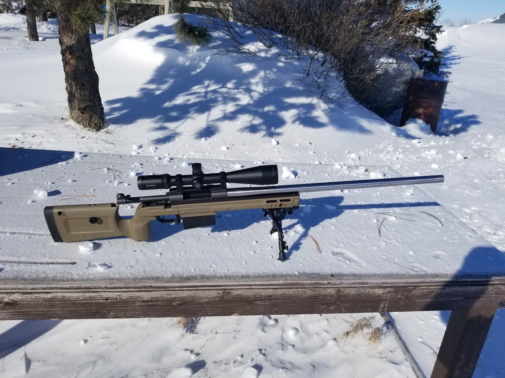

This is my 300 PRC that we assembled last weekend. Started life as a Remington 700 300 win. Green mountain barrel 1in 8 twist, KRG Bravo stock, Vortex Viper HS LR. She was easily ringing steel at 832 yards. Was shooting factory 225 eld Hornady. It was 5 moa flatter than my buddies 338 LM with 300 grain federal ammo. Love the cartridge so far.

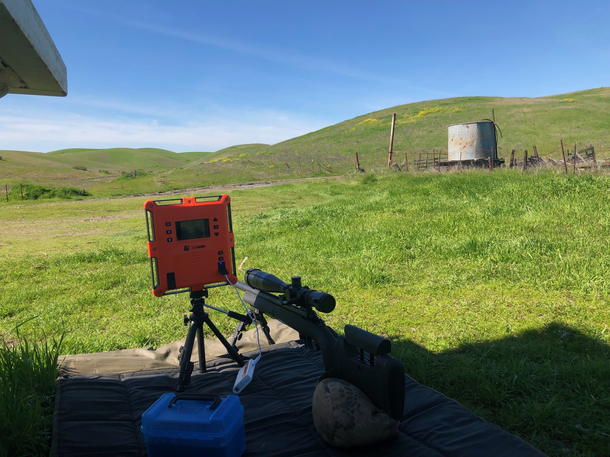

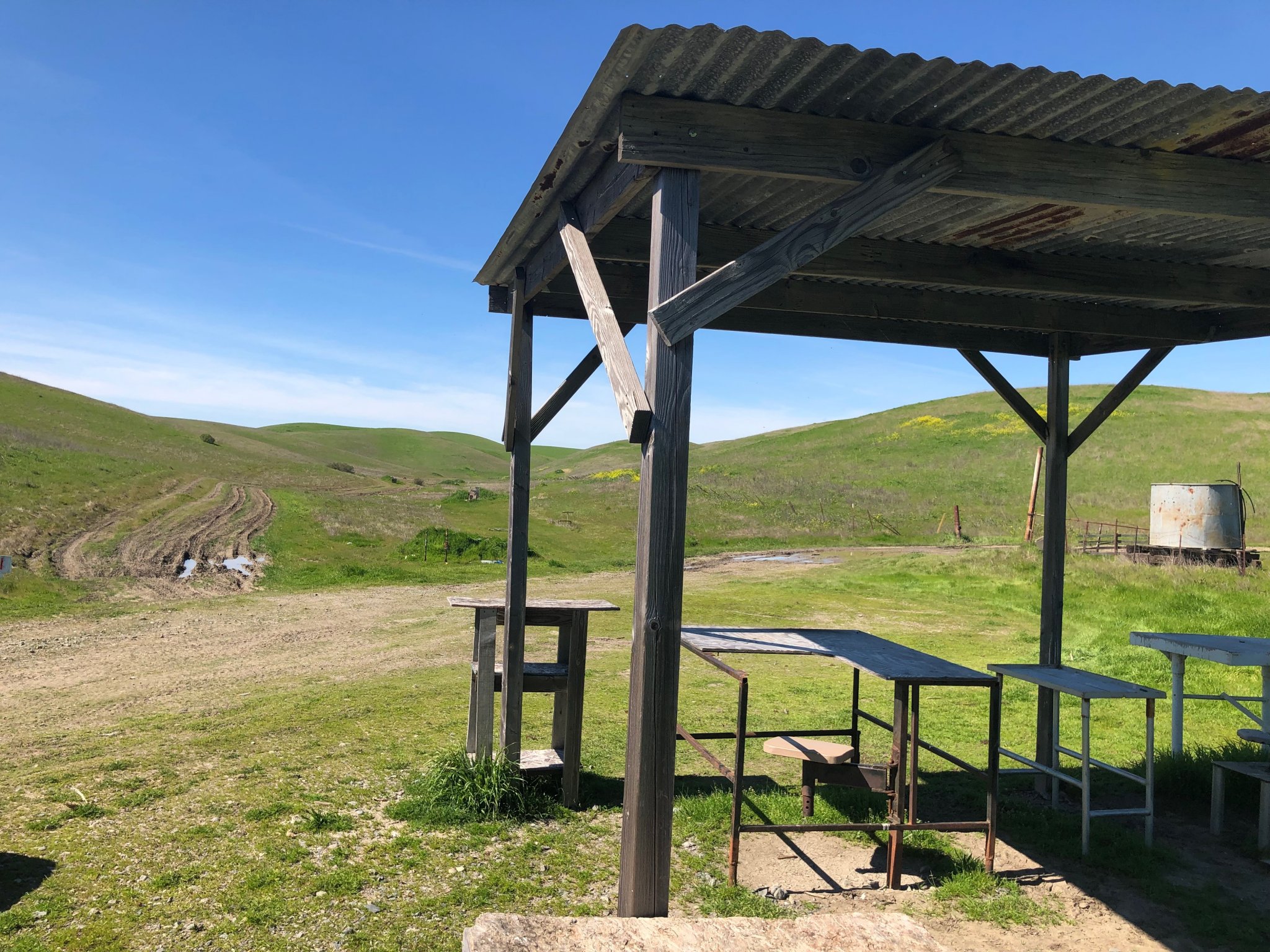

I went to a private range today for some load development. Good and bad on this front.
Bad:
I am having serious consistency issues on full length resizing. I've never had this before and am not sure what's causing it. Lengths are varying by as much as 6 thousandths. As such, I was only able to have 15 rounds that were consistent. I did 5 3-round groups at 75.5, 76, 76.5, 77 and 77.5 gr of H1000 with the 225 gr ELD.
Good:
It was 70 degrees today, not a cloud in the sky (ok, a few whispy ones), and I was in the hills by myself popping off rounds (after LD and also with my 6mm CM) at 600 and 850 yard steel targets. The operators also said there are places where they think I can get out to a mile after things dry out a bit.
Anyway... here's what data I could collect. All groups shot at 200 yards.
77.5 gr - Group Size: 1.32
2858 fps
2873 fps
2879 fps
77 gr - Group Size: 1.25
2873
2862
2871
76.5 gr - Group Size: 1.09
2834
2845
2835
76 gr - Group Size: See attached pic
2826
2807
2842
75.5 - Group Size: 1.41
2781
2814
2791
I'm loving the spread on 76.5 and 77 grain loads, and am surprised at the group on 76 with the spread it has. I'll probably do another load development day (hopefully I can get my consistency issue figured out) going from 76 to 77 at .2 gr increments. This range seems to yield the best spread, and groups were likely impacted by consistency, even after sorting.

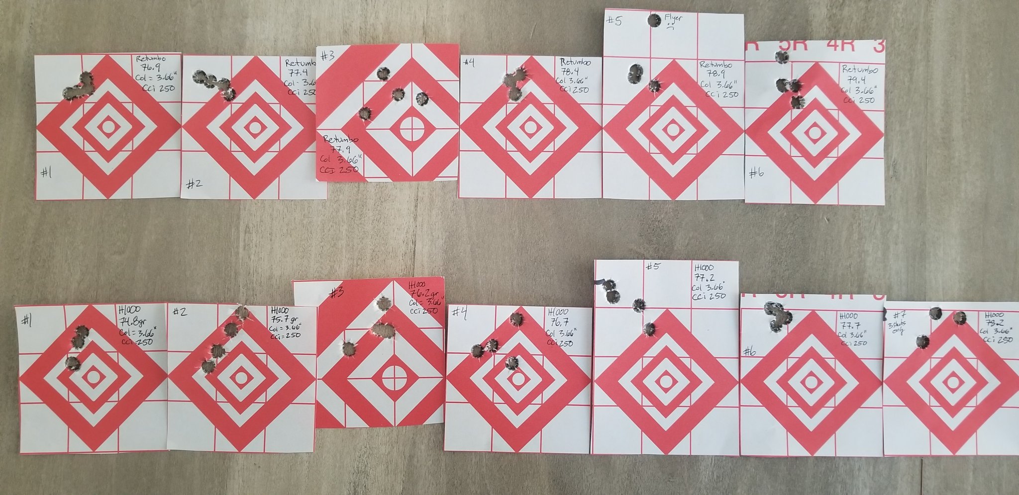

So I got to try out my 300 PRC. It's always a joy to shoot but I had a sticky bolt no matter the charge weight.
I loaded 1x fired brass from D. Tubbs that I bought. FL resized with the hornady match diet set.
225 eld pills
7045263
COL = 3.66"
Cci 250 primers
Top row is Retumbo bottom is H1000.
OCW ranged for Retumbo 76.9 to 79.4
H1000 74.8gr to 78.2gr
What say you? OCW charge and why the sticky bolts. I had to mallet every round out!
