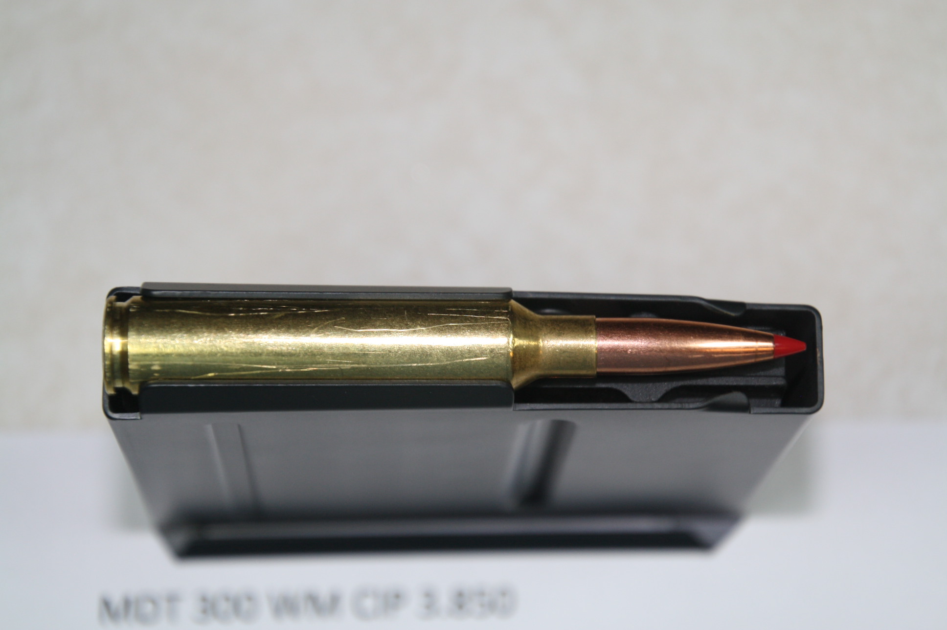

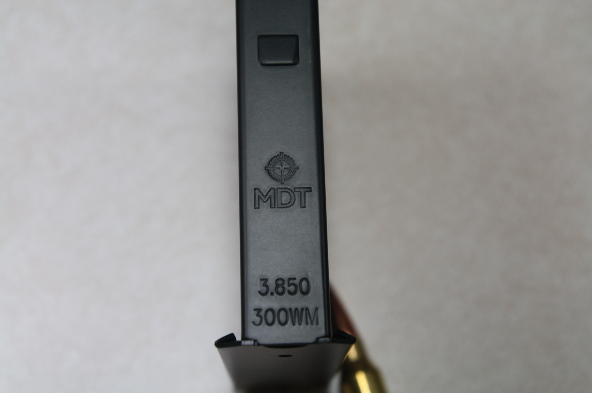

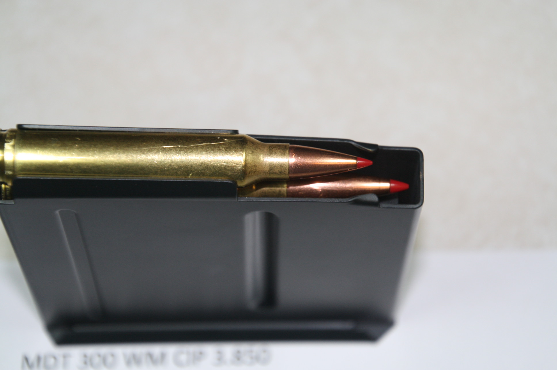

I understand that. Would it be long enough for the 300 PRC?
Nope. You ideally need 3.850 CIP mags to run to heavies. Or at least the 3.775 mags to fit rounds of 3.675 COAL. Hornady just seated them slighlty deeper with the 225 factory ammo to work with those 3.775 mags. But the 3.850 CIP mags that take the COAL of 3.750 are ideal.

You will want a 300WM CIP length magazine & bottom metal to ensure you have space with a 300 PRC.

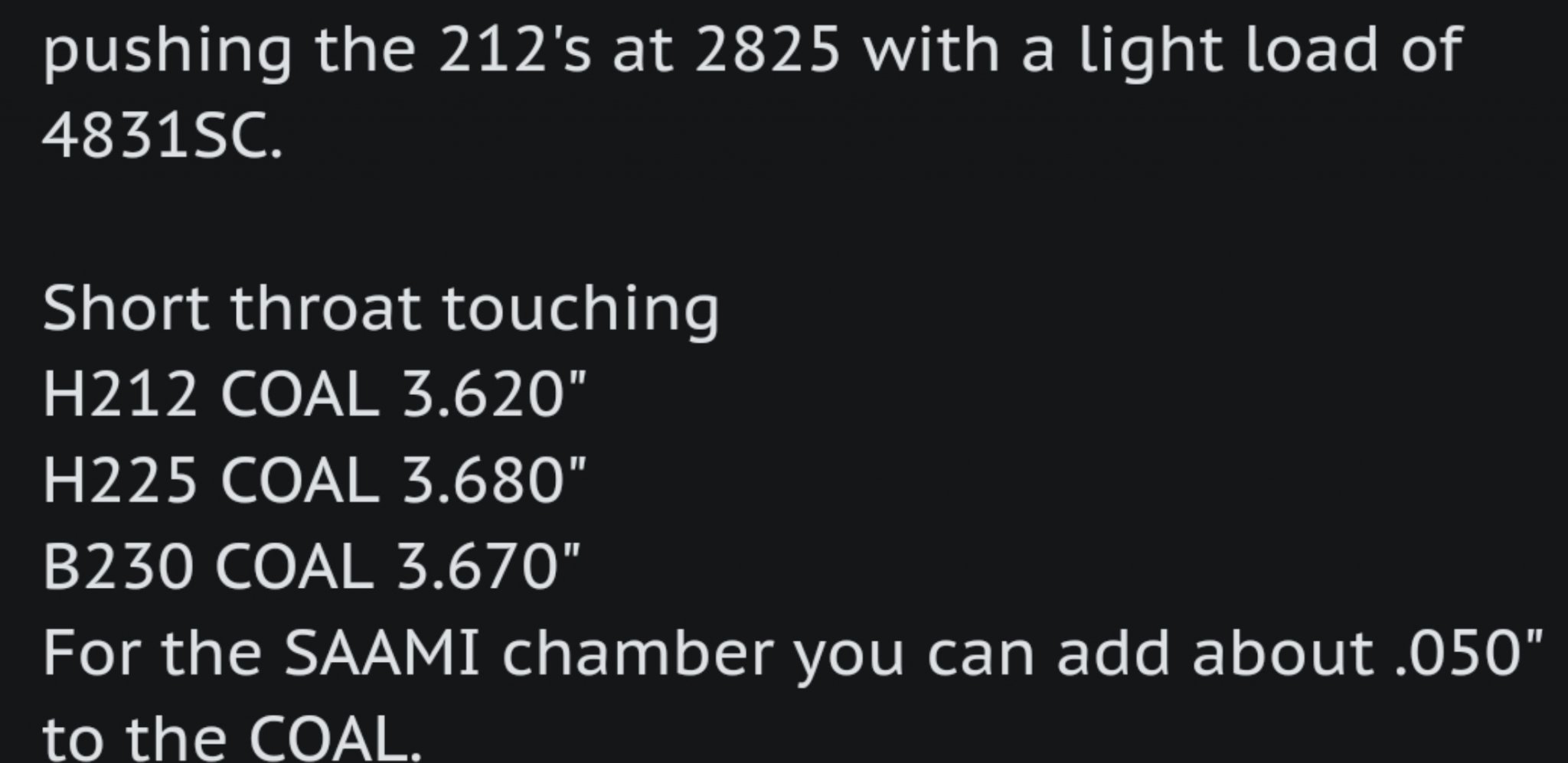

So am I correct in the consensus thought that the Saami spec is best for shooting factory ammo, and if you are a hand loader you want the short reamer Mr. Tooley has?
Why seat the bullets deeper if you don't have to? I wouldn't want the shorter reamer unless your limited to the action or rifle not taking CIP length mags. I personally would rather seat the pills further out as long as I have the mag length to do it.
If your switching from an existing 300 win mag, that only takes 3.715 magazines, the custom reamer is probably the best best. As your limited to COAL. At that point, yes you would have to reload.
I’m not a pro, just like shooting rifles but... From what have complied a shorter throat will minimize how much further out you have to seat the bullet to reach the lands.
Per Hornady load data H225 eld m 3.680” coal.
With a sammi thoat and H225 eld m,you would be at 3.730” coal touching the lands. .050” jump from 3.680”. You know to keep the lawyers happy due to factory ammo not always 3.680”...
Now if my notes are correct the 338 CIP mag has an internal length of 3.764”.
So if you seat at the lands with a sammi throat your left with about .034” room in the cip mag. Now as the throat erodes your going to be chasing the lands and encroaching more on the room you have left in the cip mag.
This cartridge was designed with the bullet seated out further in the case to achieve the velocity without higher pressures and seating a bullet way out in the neck like we do with our 300 WM loads to get the higher velocity.
So if Dave throats my chamber where the H225 bullet is touching the lands at 3.680” ill be able to reach the lands while maintaining the original design length of the cartridge and have plenty of room in my mag to chase the throat at it erodes.
Just my thoughts correct me if I’m wrong!
Your thinking is correct....
My Sammi cut chamber is at 3.700 with the 225 eld to the lands. 300 Win mag CIP mags can run a COAL of 3.750. Ill prob shoot out the barrel before I run out of mag length. If I am 20 thou off the lands making my COAL 3.680, I may never run out of mag length before the throat erodes enough to matter. We'll have to see with time. With the 215 bergers then maybe pending how you treat and shoot the rifle. If shooting the 212s you will never run out of mag length. Think it's a non issue unless your running them smoking hot and hard.
