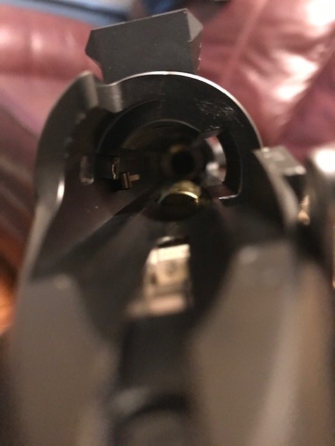

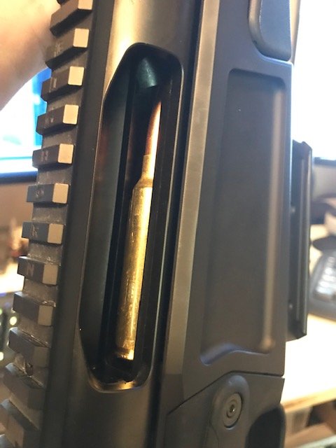

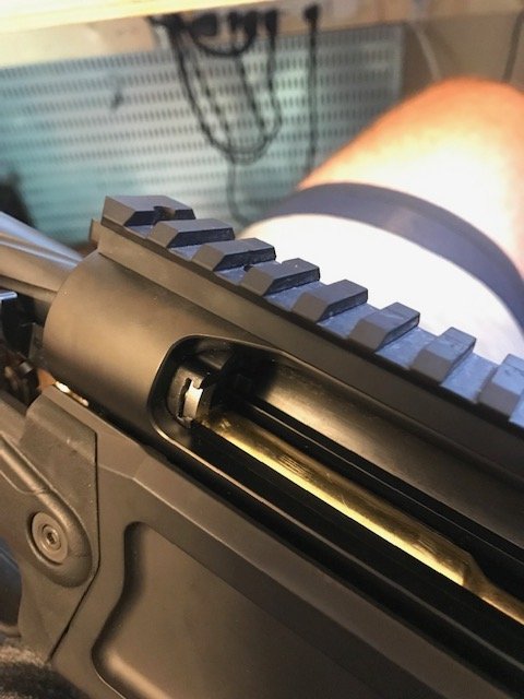

send picture with mag inserted. from the rear. bolt removed. that shows primer heightCan someone help this newbie idiot? AI AICS chassis and magazine, Bighorn TL3 magnum bolt and bolt face. The bolt is sliding over the round and not chambering. I'm assuming it has something to do with the feed lips but I haven't been in the game long enough to know.
300 PRC in an AICS 300 Win Mag magazine
@twh30
AICS and AX chassis magazines for the 300WM have different part numbers.
You need the AX specific ones... ask me how I know ;(

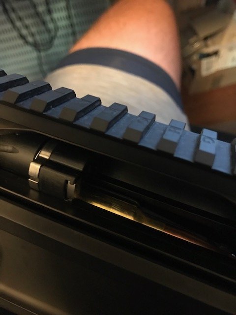

From what I can see/decipher I see no primer at all.@b6graham photo attached
That 225gr is off the self factory ammo and I’ve look at flat line loads they just put MCNice! What's the details on your 225 load?
I would try opening the feed lips some. But I'd also consider what tooley mentioned
Oh hell somebody has found me.Yep. Just ordered a new mag with a longer COAL that I think is going to work. I also only live about 15 minutes from @DAVETOOLEY so I'll probably drop the whole build off with him to make sure I'm good to go. He might be able to open the feed lips on that old mag to make it work.
Thanks for the input.

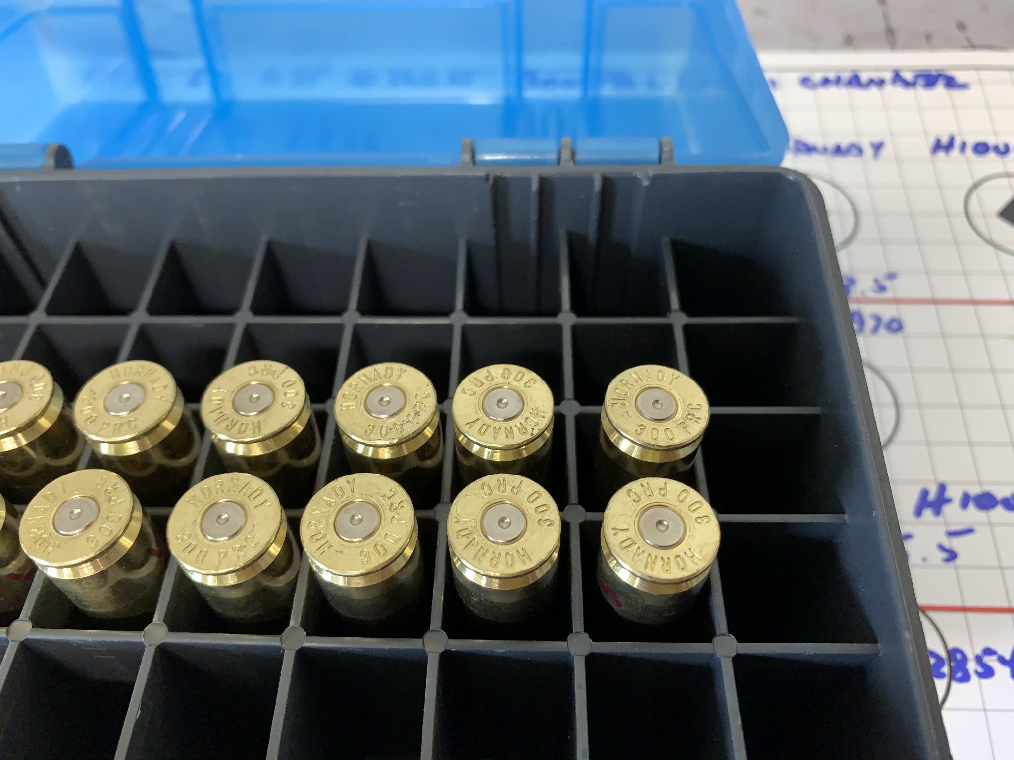

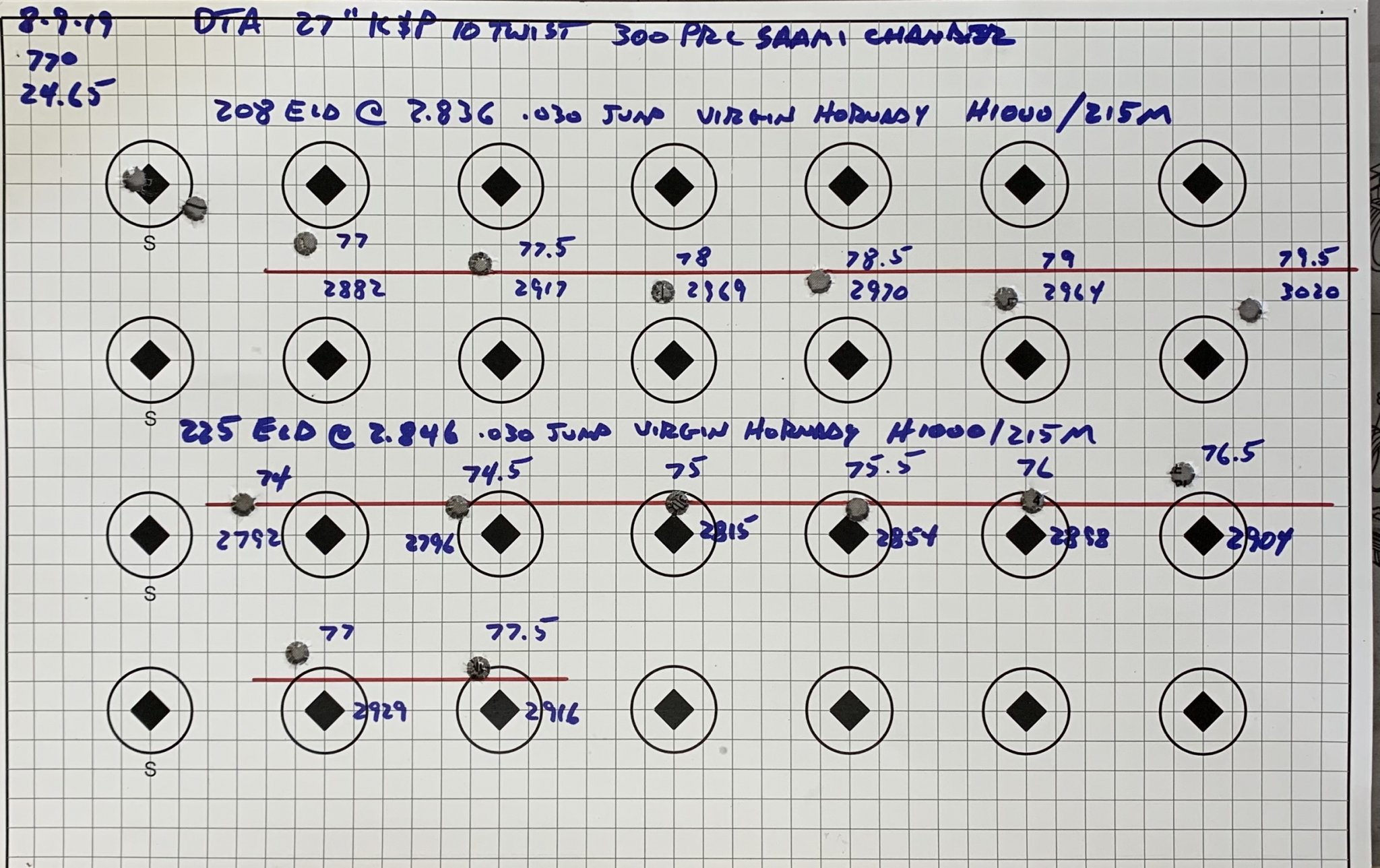

You've got ejector pin marks so you've exceed the yield point of the brass.Went out again today to do 208 and 225 eld pressure test with H1000. For the 208’s no sight adjustment was made from the last outing, but the barrel had been removed and fully cleaned. I dialed .3 up for the 225 test. Interesting how the 208 trends down through the charge escalation. .8” total vertical through the whole range. The 225’s had almost exactly .36” of vertical through the whole range.
The my DTA bolt makes these little halo ejector marks even at the lowest charges. Here’s the high end of today’s loads. 208’s on top. No sticky bolt for any of these.
Other than finding zero, I normally wouldn’t do any of this at 100 yds. 500 and beyond is more useful. With my day job schedule though, I’m a little squeezed for time to set the long range tests up.
Normally I’d agree, but everything does it, even the lowest starting charges and factory ammo.You've got ejector pin marks so you've exceed the yield point of the brass.
