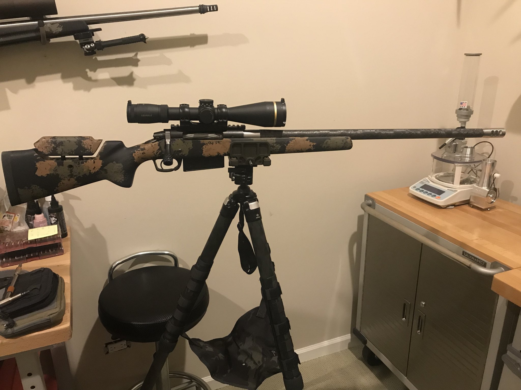

Just got my 300 Sherman mag back from the gunsmith. Barrel is 26 inches with a 1-9 twist. The picture is a 215 hybrid with the start of the boat tail at the base of the neck to fireform the brass next to a 300wm with the 215 seated .020 off the lands. Quite a difference and I’m excited to try the 230 otms and SMKs
How do you like the automated powder measure attached to your FX 120 scale?
It’s the best investment I’ve made outside my CPS and giraud trimmer. I’m going to a two day match next weekend and was able to throw powder and seat 400 rounds in 2 1/2 hours two nights ago. The best part is variance in charge weight was within .04 grains for the whole batch.

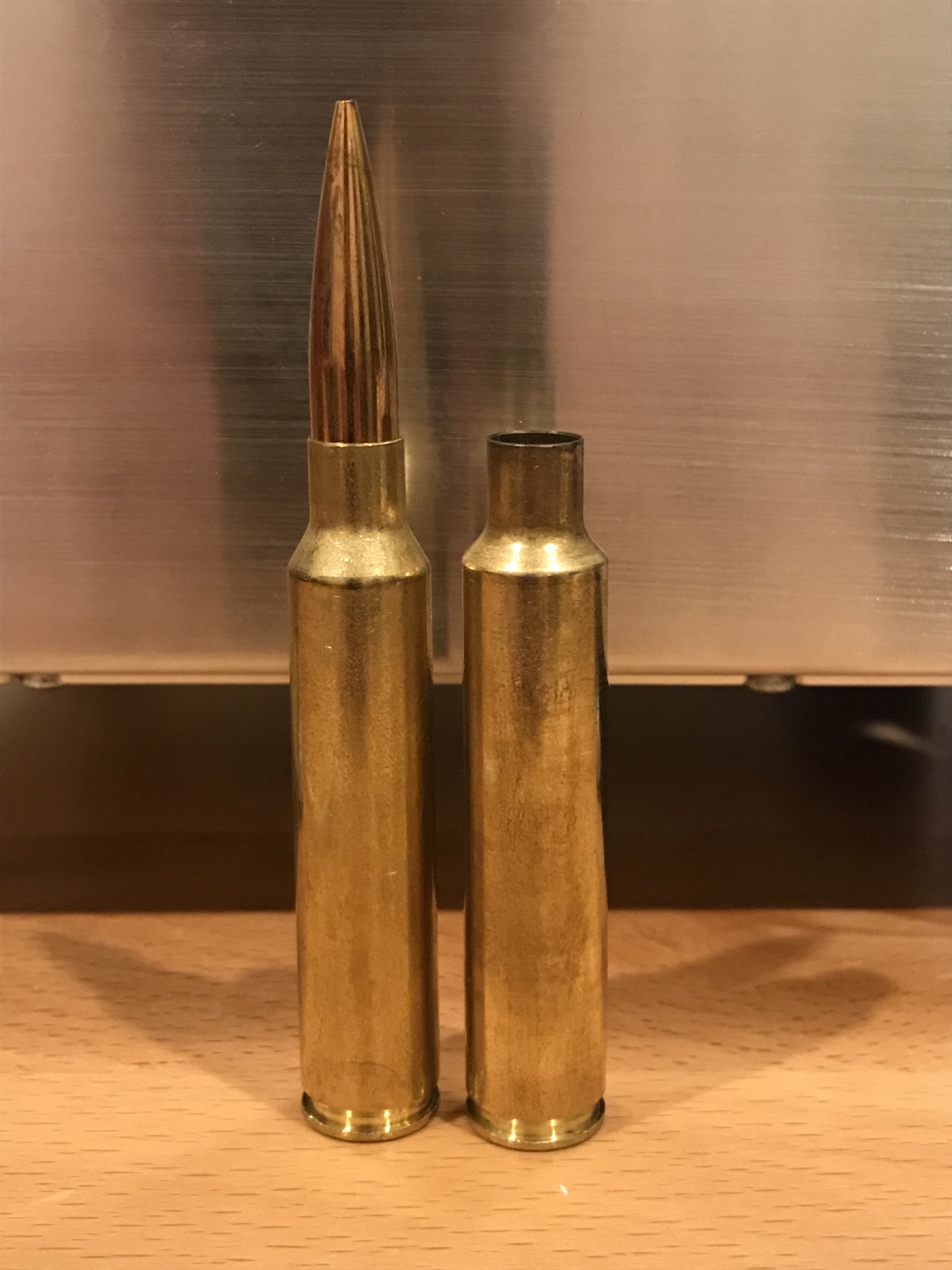

This is a picture of a new 300 PRC next to a fire formed 300 Sherman mag. It’s got a decent amount of taper taken out and a 40 degree shoulder

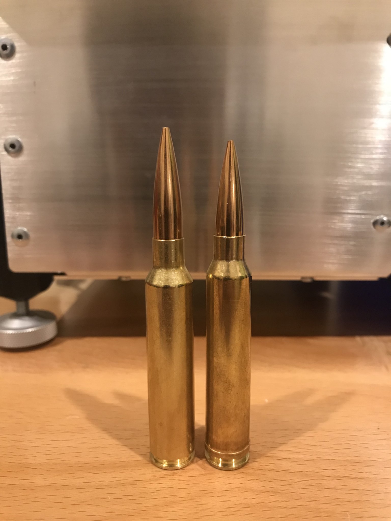

I’ve posted them before but attached are pictures of a 300wm vs a 300prc and a 300prc vs an unsized fireformed 300 Sherman case.

That first round is perfectly acceptable and equal to normal 300PRC loads with velocity and accuracy. Just like a normal AI chamber or a dasher for example.
Higher case capacity from less taper and sharper shoulder equals more powder and higher velocity. Steeper shoulder less neck growth
AS for reloading, yea, I think it would be a shame not to learn how to get the most out of it. Thanks for posting the pics again, I seen them though. I have read this entire 28 page gem. What is the cost of those 100 fps? Is it causing a lot more pressure in the chamber and eating up the throat faster? I ask because you are fire forming brass to get your first round of Sherman cases, so that cuts into your barrel life. If I'm off base please let me know. I'm just trying to see figure things out.
B6graham said it perfect. You get 300prc performance for the first firing and then it’s good from there. I expect rich will get brass already formed before to long so no fire forming at all when that happens. I’m only doing 65 cases as it’s a hunting rifle and I expect around 1000 rounds till the barrels shot out so a very small margin will be at the regular performance.
