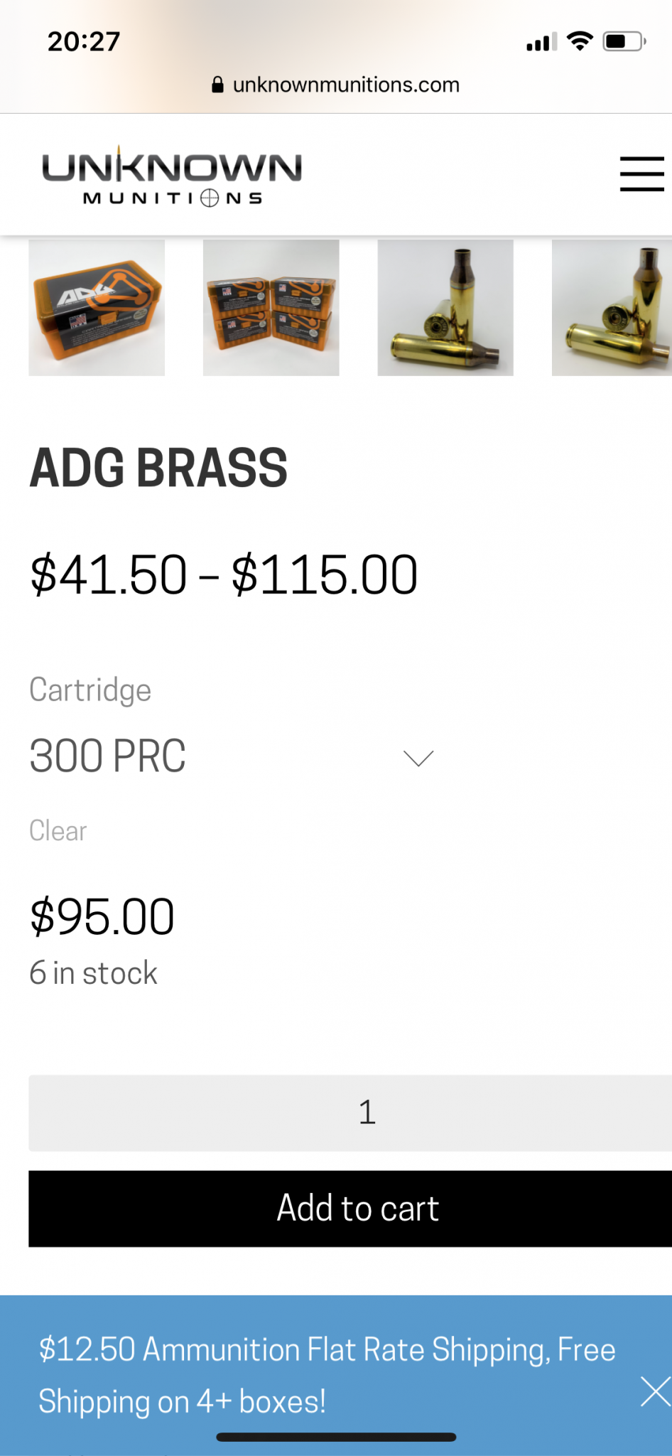

Correction....4 left in stock. I only grabbed two. I have pre-orders in with a few others....and I just bought another PUG 3D ELR bag with the light fill....and I still gotta eat this week....and I ain't missing a meal ;)
Reactions: NVScout

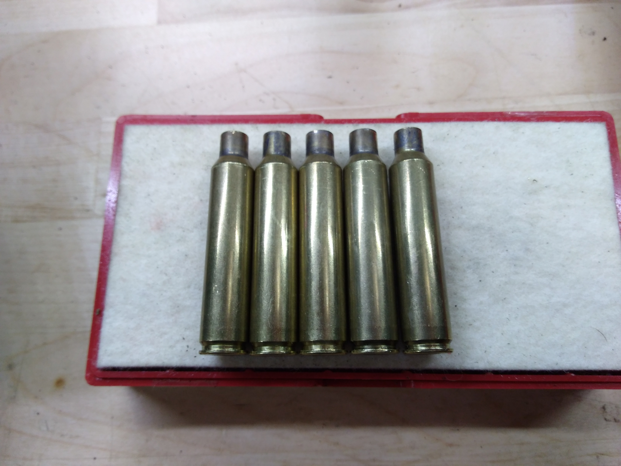

The picture of the brass below is in response to some of the pics I've seen of other people's brass with questions about loads and brass quality. I've seen some ugly stuff. Below is 8x fired Hornady brass. On these particular 5 rounds, they were initially fired with 225gr ELD-Ms with a stout Factory load. Each reload has been with 78.5 grains of N565, a 225gr ELD-M, and a Federal 210M primer. After the first loading I had a pretty good trim down to 2.565. After that I barely touched a 1/2 thou off of any one of them maybe once or twice. They simply aren't growing in my Defiance Deviant/Bartlein combo chambered by Greg and Russ at SPR...aka.. Bugholes.
These are uncleaned, unsized. You will see a little powder residue around the necks...and you will see some tiny dimples where it slung out and hit the ground...and you will see some verticle scraping from my tight MDT 300WM CIP mags. You can see where the sizing die stops and doesn't go all the way down to the head. When these are cleaned up...they will be so shiny they look like a brass pole in a strip club.
While I've lost a few to primer pockets failing....that was MY fault. They were pushed with 80+ grains of powder to as much as 3100fps in a 28" barrel. So, while Hornady brass may be 'sub-standard'...it has held up rather well....and given me the opportunity to shoot at distance with an accuracy I never thought I was ever capable of.
Now, in a few days....my journey with ADG brass will begin...and we'll see if I can quantify the difference between the two.
Exactly what I've seen. First, I did the 300 PRC over the Nosler for 3 reasons.
1) Nosler brass sucks!
2)Nosler brass is expensive
3)Noslers brass sucks!
I cleaned the necks on the PRC Brass, prepped it, and fireformed 300 pieces.
I have 50 pieces I've just used for load development and to see how many firings I'm getting. So far, I've got 5 reloads on it and haven't lost any yet.
It really isn't that bad plus, at 80 some cents a piece, I'm ok with it. I'll wear the barrel out before I wear the once fired stuff out. Maybe the ADG or Peterson stuff in the future. I'll see how it does for others. Will the groups shrink? Time will tell. But for now, the Hornady stuff is doing well.
It reaches out to the distances I built it for with good Accuracy. No complaints.
I loaded 1 piece of Hornady brass 8 times in a row 215 hybrid, 79.3 H1000 cci 200 and primer pocket was still tight enough to bring joy. Not feeling the need for more expensive brass at this point. Hornady brass got alot of it's bad rap from guys consistantly running over pressure in 6.5 creedmoor.
Just sayin......
