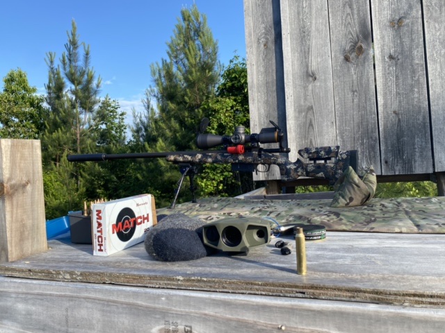

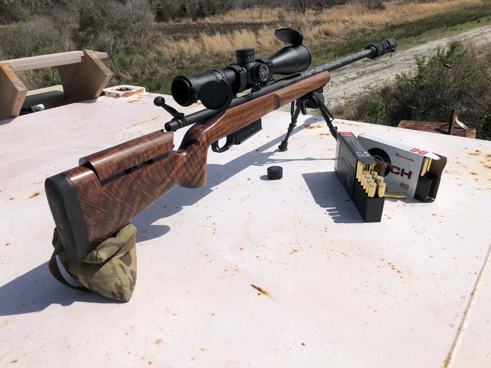

Last day at the range before loading up for the NF ELR Match. The 2850 range is a solid node for the RL-26 and 230 ATips, it's a little slower then I was dreaming about but it's shoots lights out, consistent out to 2000+ yards.
Also got a mod-ed http://adjustablebagrider.com/ for the MDT ACC which is pretty cool. With the PU 3D ELR Bag it's nice for getting that super fine adjustment just before you send it.

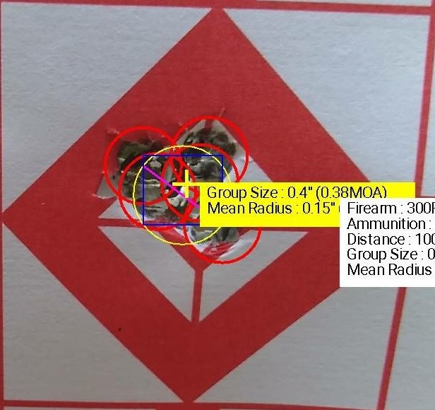

Well...today I shot a few groups just above 1/4"...in the .30 MOA range....one at .26 MOA....but the node may be too dangerous with Summer coming here in N. KY. It was only 78F when I shot today....and my RL-26 load was pushing 2990 to 2996 on virgin ADG brass and 230gr A-Tips.
It was more about dialing in my new ZCO 5-27 MPCT3 scope....and getting solid MV data since I started using a Sinclair carbide neck mandrel to open them up another 1 thou after sizing with the .336 neck bushing. I had 1 bad group today.... .75" Would have been the best group of the day...but I yanked the trigger like a newb and threw it left.
Will revisit the muzzle velocity next week with a reduced load and non virgin brass. I want to get my MV spread as low as I can....for some 1 mile work coming up at TVP.

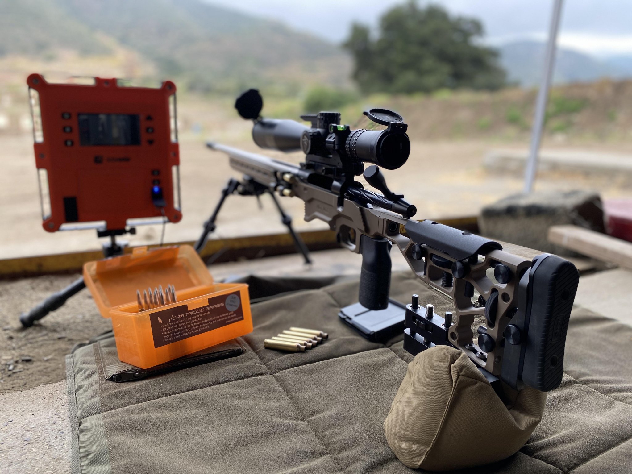

Had some good luck today with H1k, 230 bergers and 220 ELDX. Both loads @ 77.5gr were stacking them. Both loads were true @ 370yds based off labradar velocity’s. This barrel wants to shoot! It’s a 1:9 Bartlein put together by Aaron Roberts. Got to find a longer range to see what this sucker can really do. :-(

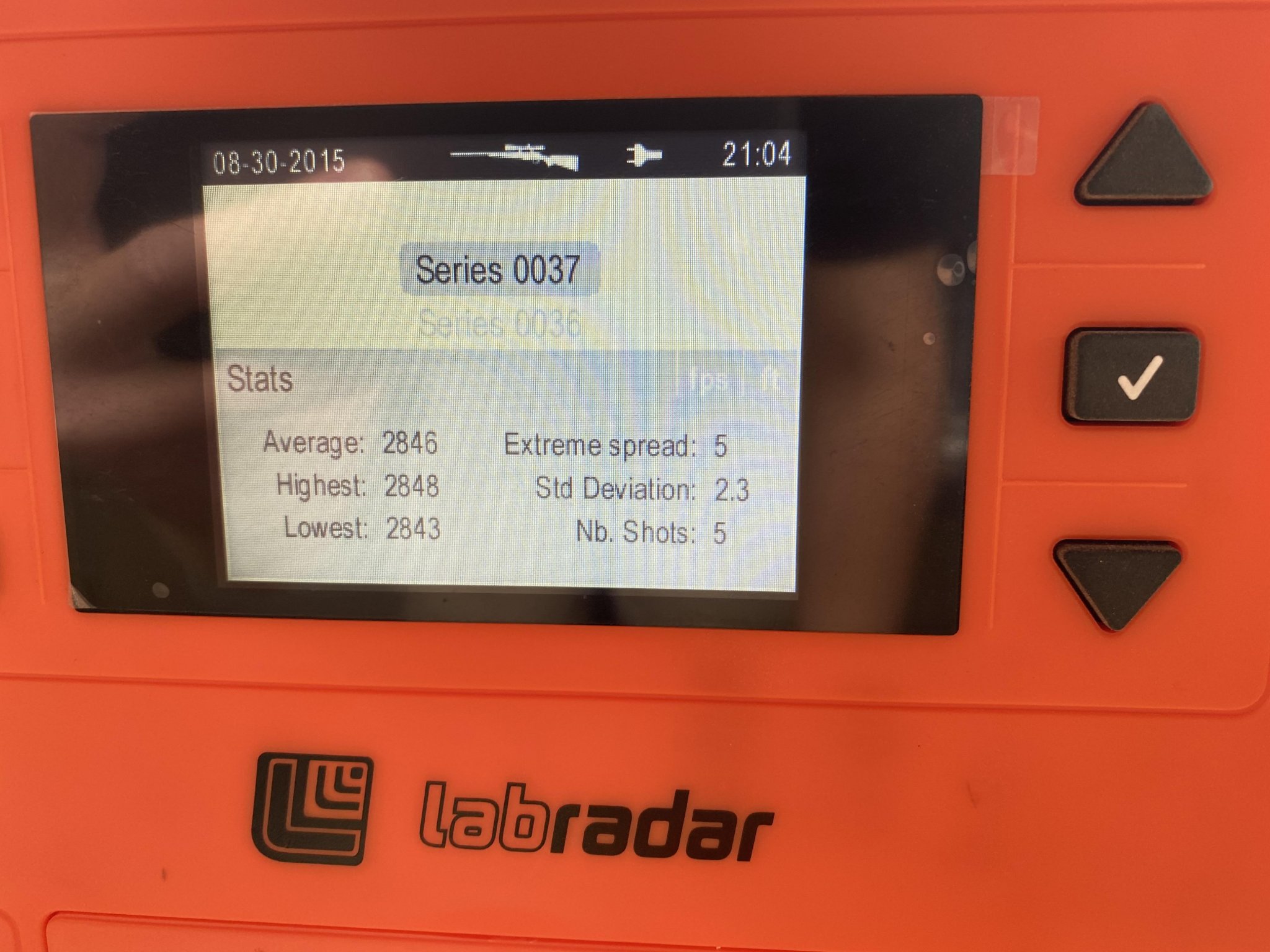

Shot a ladder and saw:
78.6gr- 2898
78.8gr- 2892
79.0gr- 2899
So I loaded 2- 5 rd strings at 78.8 and shot them over the chrony getting an SD of 17 & 15...... not as consistent as I want so I've got to get that dialed in next.
