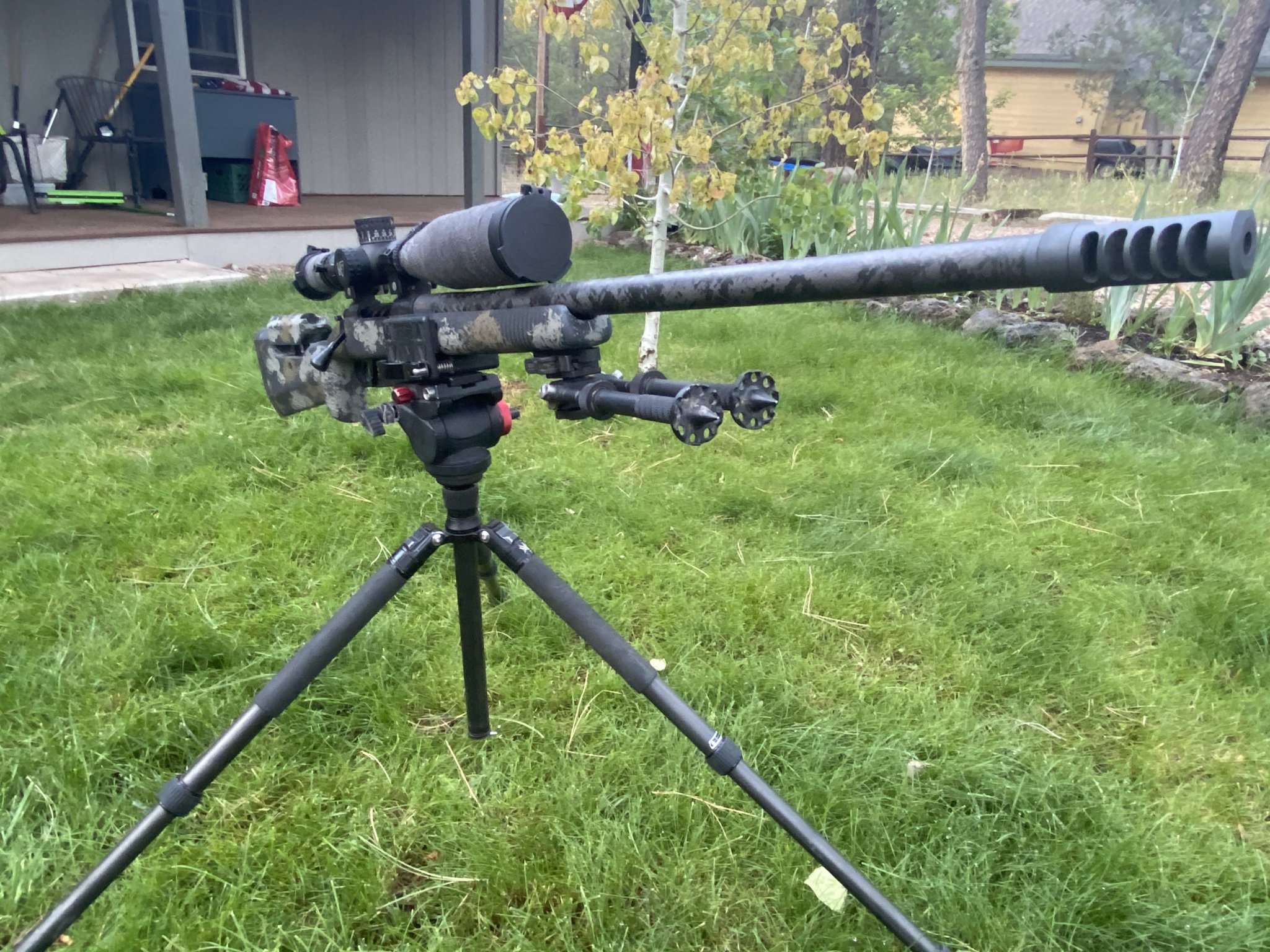

Owens Armory built this for me. Just picked it up. 12.6lb with scope and bipod.
Deviant action, 26” proof carbon sendero 1:10, Manners EH1A, hawkins bottom, piercision 5 port brake, ADG brass, H1000, 225 ELDM, CCI 250, 20 thou off the lands. Used 21ST century 0.307 expander. Redding dies
less than 30 rounds through the rifle. Loaded up quick ladder test.
had a node around 2815 with ES of about 19fps spreading over 0.8gr (.2 increments). Had a second node around 2865 about 25fps ES spreading over another 0.8gr (.2 increments, 77.2-78)
next time out, I’m gonna load some 5 shot groups somewhere in both those nodes to find the best.
btw, factory Hornady 212 shot a 0.29MOA GROUP but the ES and SD were terrible with factory rounds

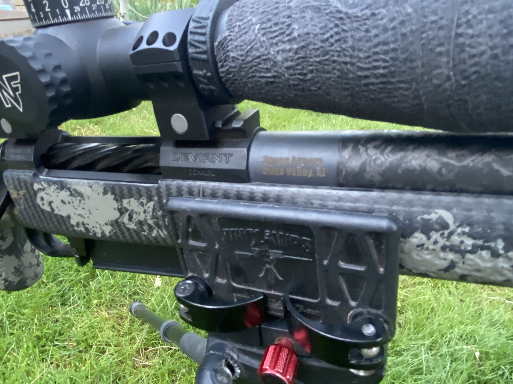

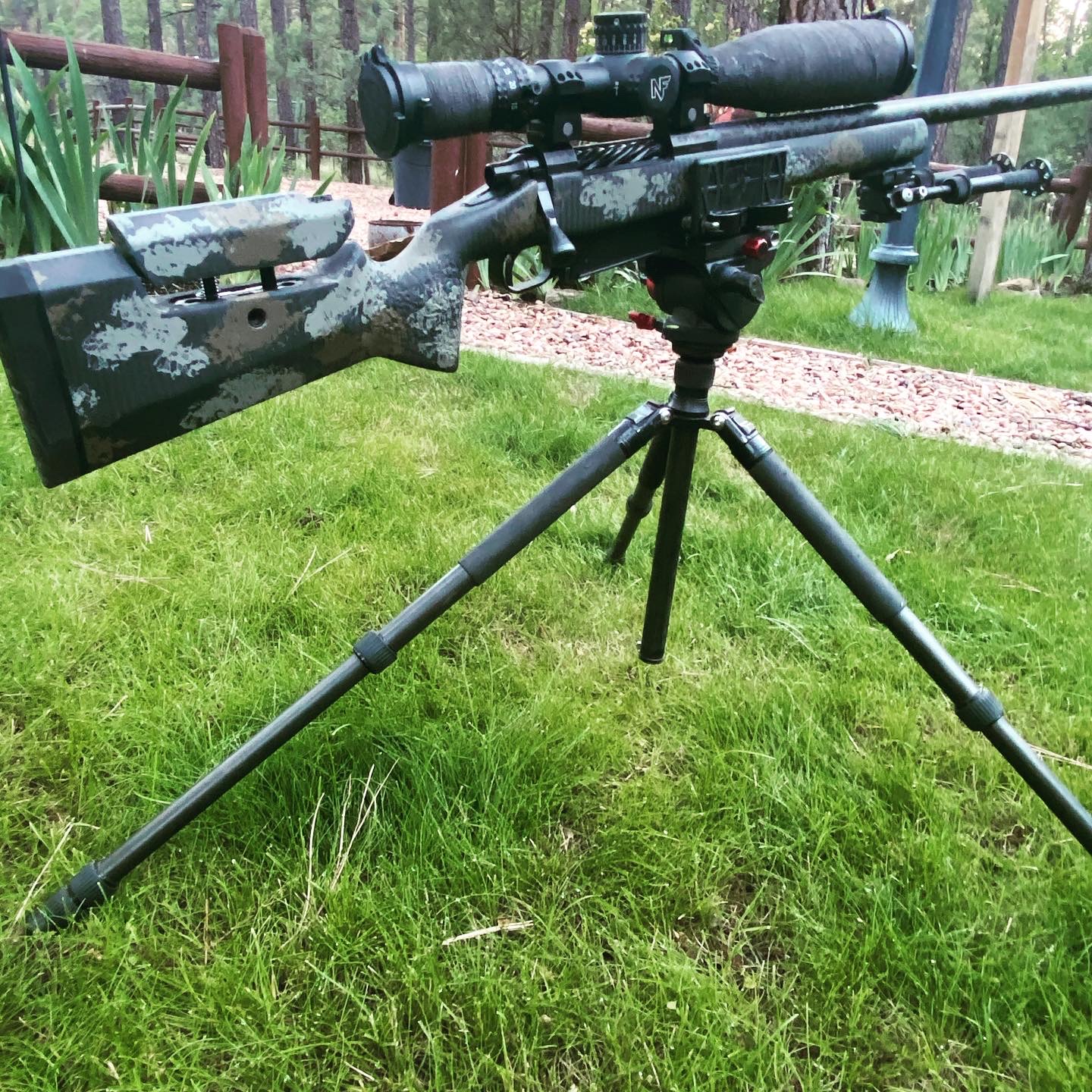

A little late but I took my 300 PRC build out to the NF ELR Match in Wyoming. The main reason why the gun was built.
