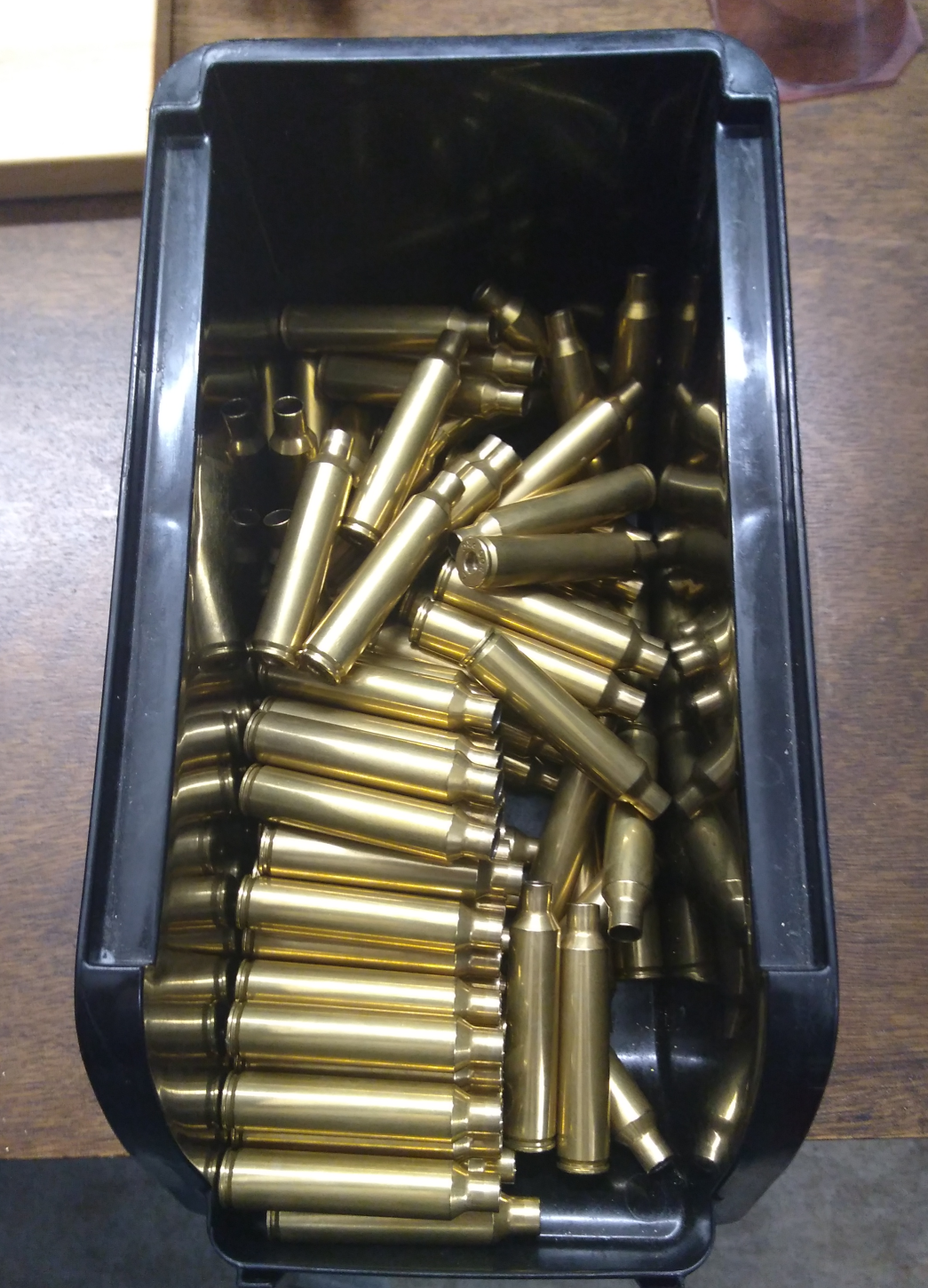

Has anyone worn out their ADG brass yet? If so how many firings did you get out of it?
also how heavily were you loaded?
I'm only on loading 5 on some ADG Brass. If you read the thread...I load toward the very hot side....the "don't do this at home...I'm a Professional...idiot"...heh. I use primer pocket pin gauges and I've yet to wear out a primer pocket on the ADG. Some of the Hornady gave up their primer pockets on the 3rd firing.
I don't wear out the brass doing a full length resize though...I use an LE Wilson arbor press neck die and do minimal movement of brass in the neck/shoulder. I haven't seen any length movement...and haven't had to trim since an initial touch up job. My custom chamber is very tight....I don't know about people that have a factory chamber...
Anyway...that's my experience so far.
