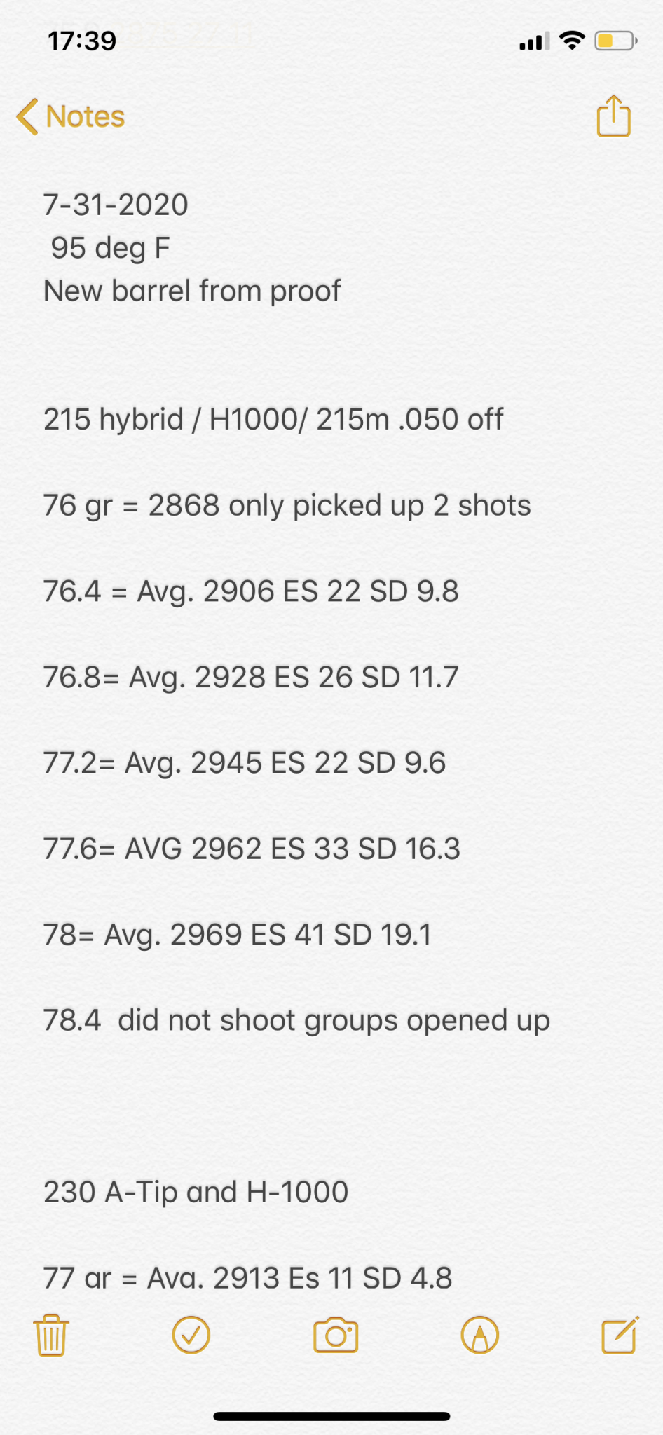

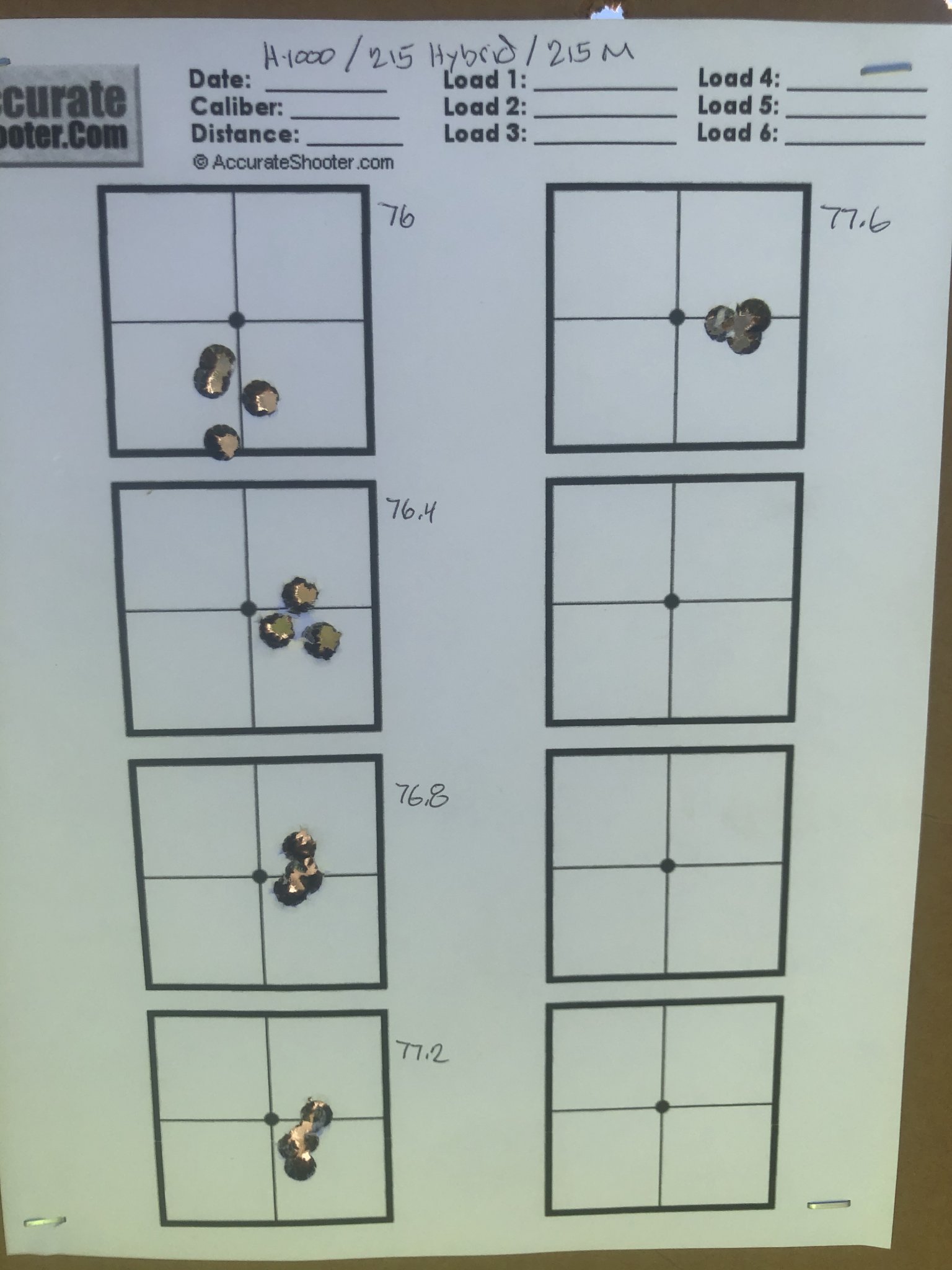

No pressure signs at all with ADG brass and 26” proof carbon

@DellaDog that barrel will start speeding up just a bit over the next 50 rounds or so. What did you use to measure velocities? I keep wanting to rezero my rifle because I'm shooting high...then realize...duh...I have a MagnetospeedV3 on the end and the shots are deflecting high. After next weekend I'll have over 1100 rounds down the barrel....I'll go shoot a few 5 round groups to measure muzzle velocity and then grouping....this thing can't last that much longer as a competitive ELR barrel.
Labradar. I shot the first 25 rounds at 76 grains and watched the speed build from mid 2800 (2840) to 2900.
Took the next 25 and shot 77,77.5, and 78 to see what speed it liked & about where they plotted.
It's just a test to guess where it'll like speed wise. And I'm guessing low 2900, regardless of the charge that gets me there.
76 & 77 were close to 2900 & plot similarly - and an obvious scatter at 78.
I'm plotting speed really, not charge weight at this time.
(I add 3 clicks and aim at the cross hair diamonds to print in the center circle.)
