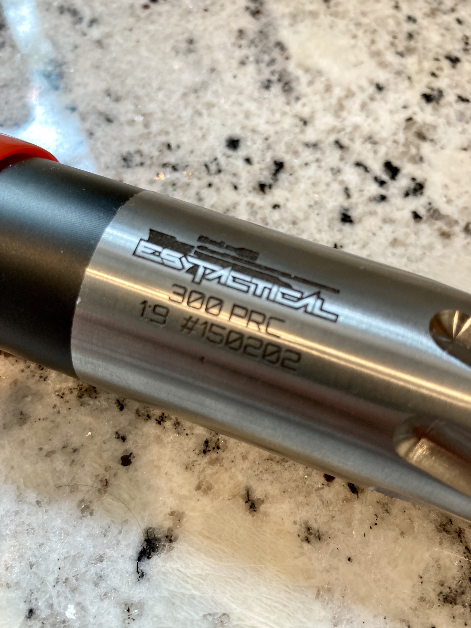

Got this in today, finally. Changed my mind at the last minute and went 24” spiral fluted barrel and shank. Hopefully get some initial data in the next few weeks. I have some 215 Hybrid and 225 ELD loaded up with a min charge of IMR 7977. Velocities will probably be low but just breaking in the barrel and fire forming the ADG brass for now. Gave up on R26 just going to stick with H1000 and find a safe node that’s quick enough 2800+.
