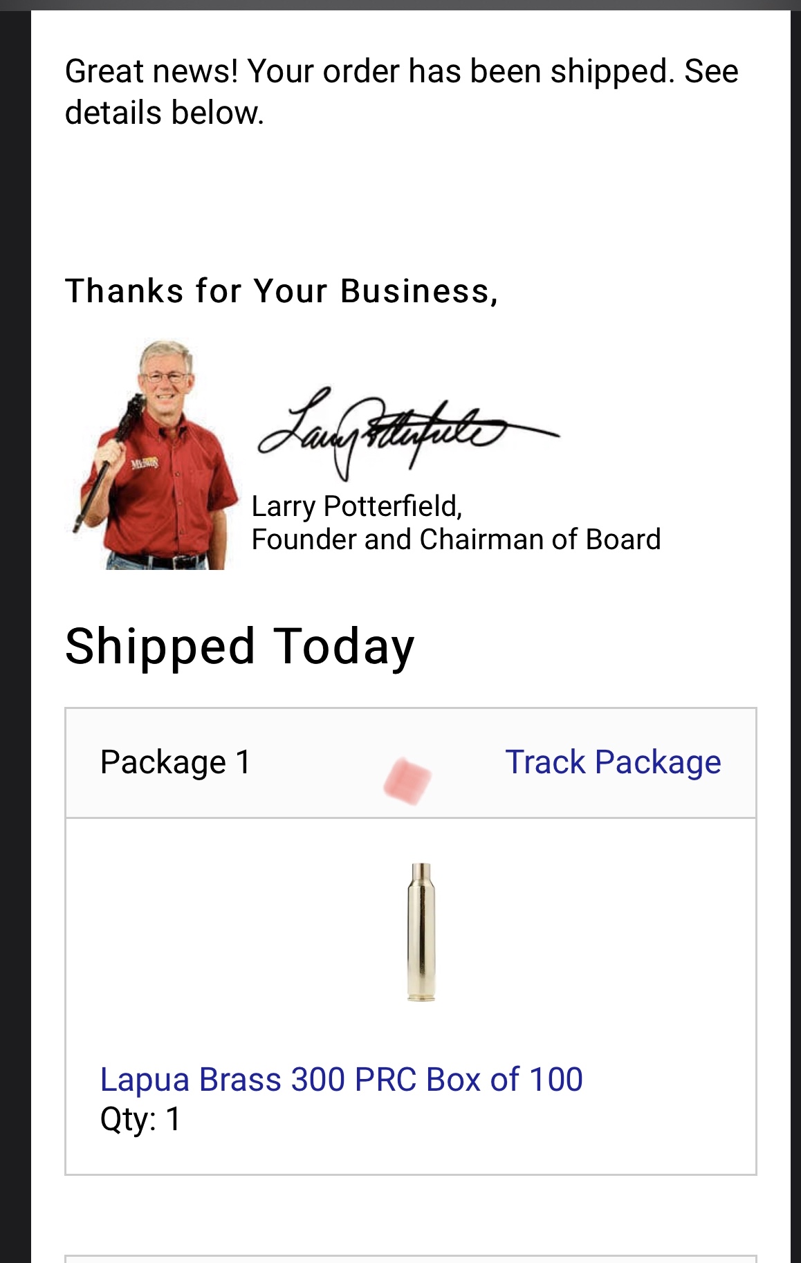

Anyone with Creedmoor Sports back orders on Lapua Brass gotten a ship notification? I backordered in April, have seen inventory pop up elsewhere and I’m hoping I get that notification soon.
I backordered in December and have not got notice yet, however I have an associate who backordered in October and he has received shipping confirmation.

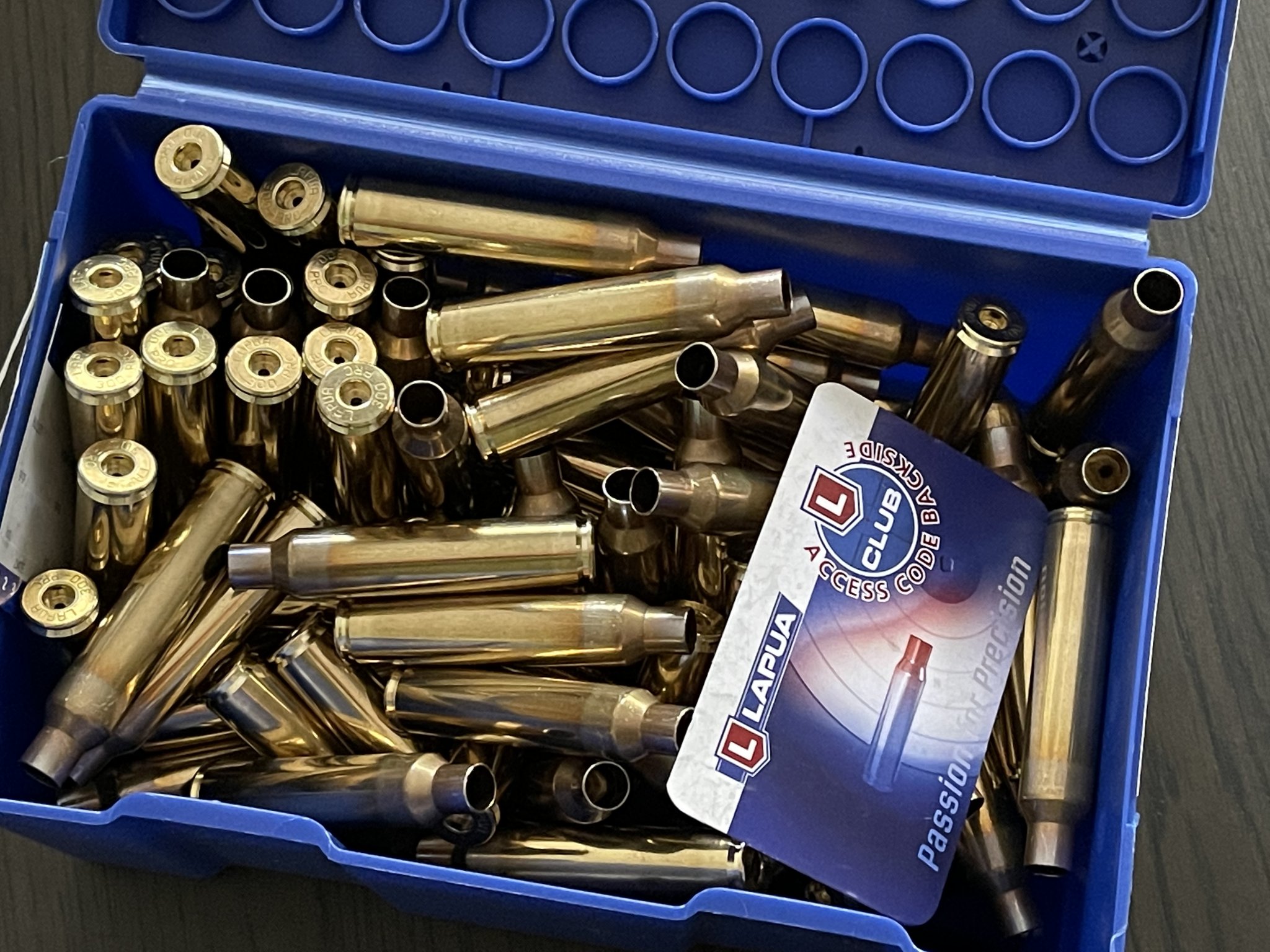

My brass arrived...got lucky...my box had 100pcs in it. Another box hasn't been opened yet.
Brass measured from base to shoulder using the SAC Comparator measures exactly the same as my Manson Go-Gauge. Overall length is 2.5715 with maybe a half thou deviation.
Necks are very very tight. Mandreled them with a carbide mandrel and they were still tough. I may re-anneal and mandrel them again after I chamfer and deburr them. I'll probably shoot 50 tomorrow to work them in...for an ELR match next weekend. I want the neck tension to be as consistent as possible for that match.

My box had 102 pcs. I measured the once fired case capacity at 95.85 grains water, essentially the same as Hornady (96.14, but I don't think these measurements can be that precise). The length at the shoulder for me was identical between virgin and once fired.
I did end up turning all the necks to 0.013" since a bullet would not drop through the fired neck.

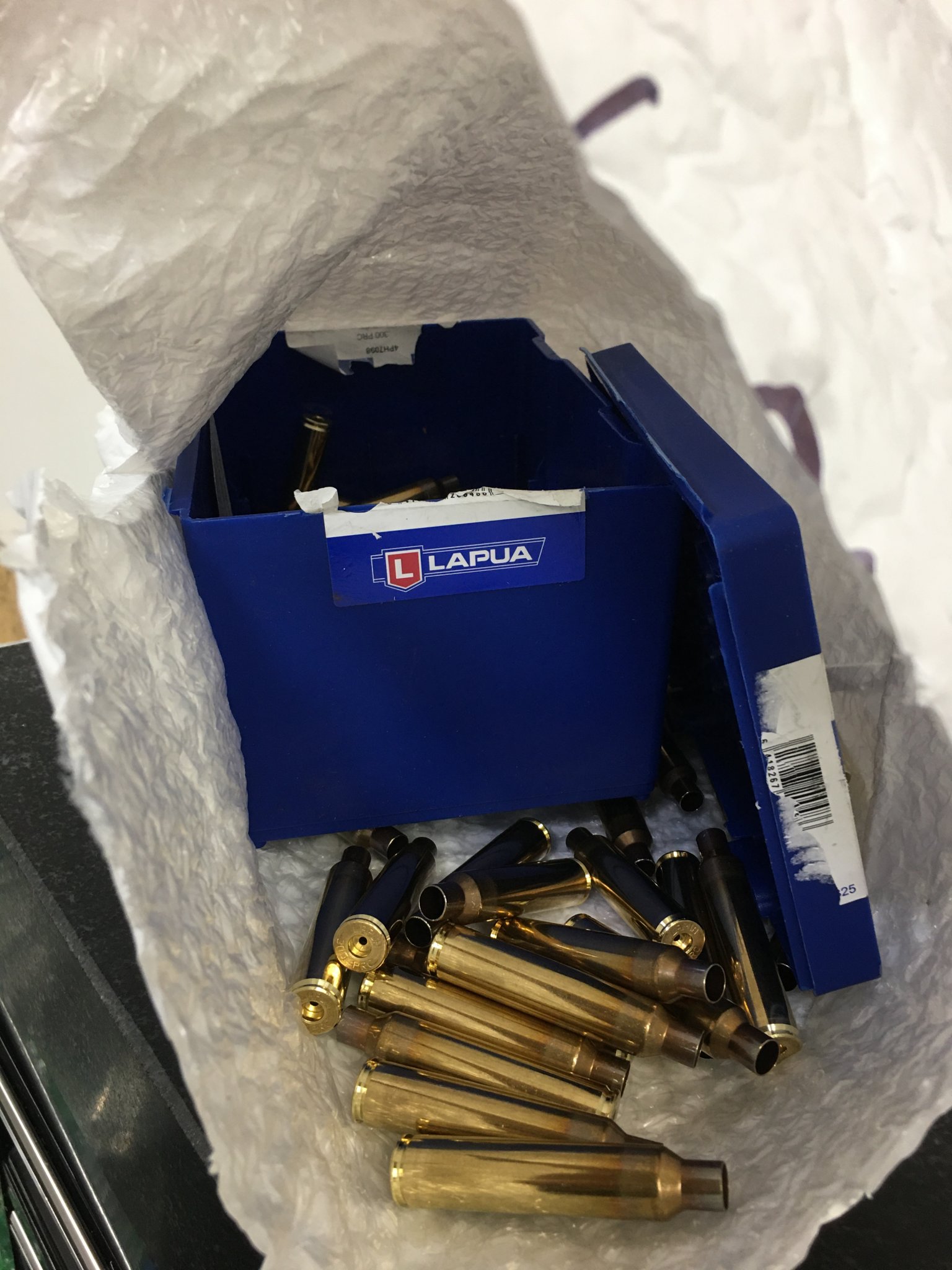

Went out with my buddy and shot the new Lapua brass today. I wanted to get a firing on 50 pieces before shoothing them in an ELR match next weekend. First off....I got 100 pieces in my box....the box wasn't broken. MidwayUSA should be kicked in the nuts for throwing that Lapua box in the cheapest bubble bag they could find for shipping though.
Brass came in....with about 3 case mouths that needed opened with a mandrel. I did NOT resize the brass because when I measured against what I wanted....they came from the factory within a half thou of where I wanted to be. The necks were EXTREMELY tight. I mandreled with a carbide mandrel and they were tough to deal with. When I seated the bullets....they were 120in/lbs to shove the bullet in....when normally I strive for 20in/lbs. Basically...I thought I was going to break my arbor press pushing them in. I was worried about concentricity...but the Sinclair/LE Wilson arbor die supports the cartridge as well as the bullet and they came out almost perfect.

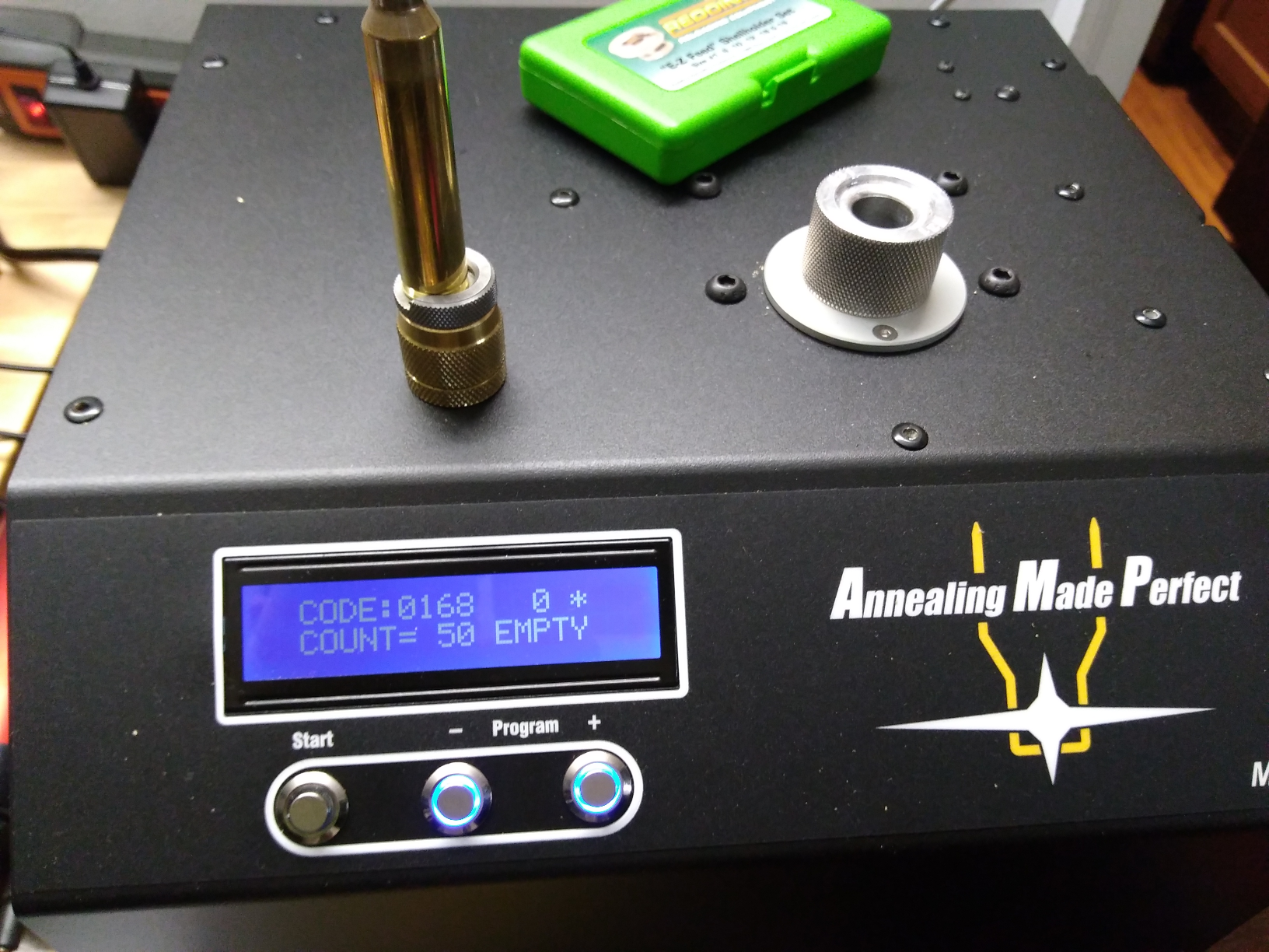

Here is the AMP AZTEC Code I got from burning a piece of brass. I would be interested in what code you guys get:
