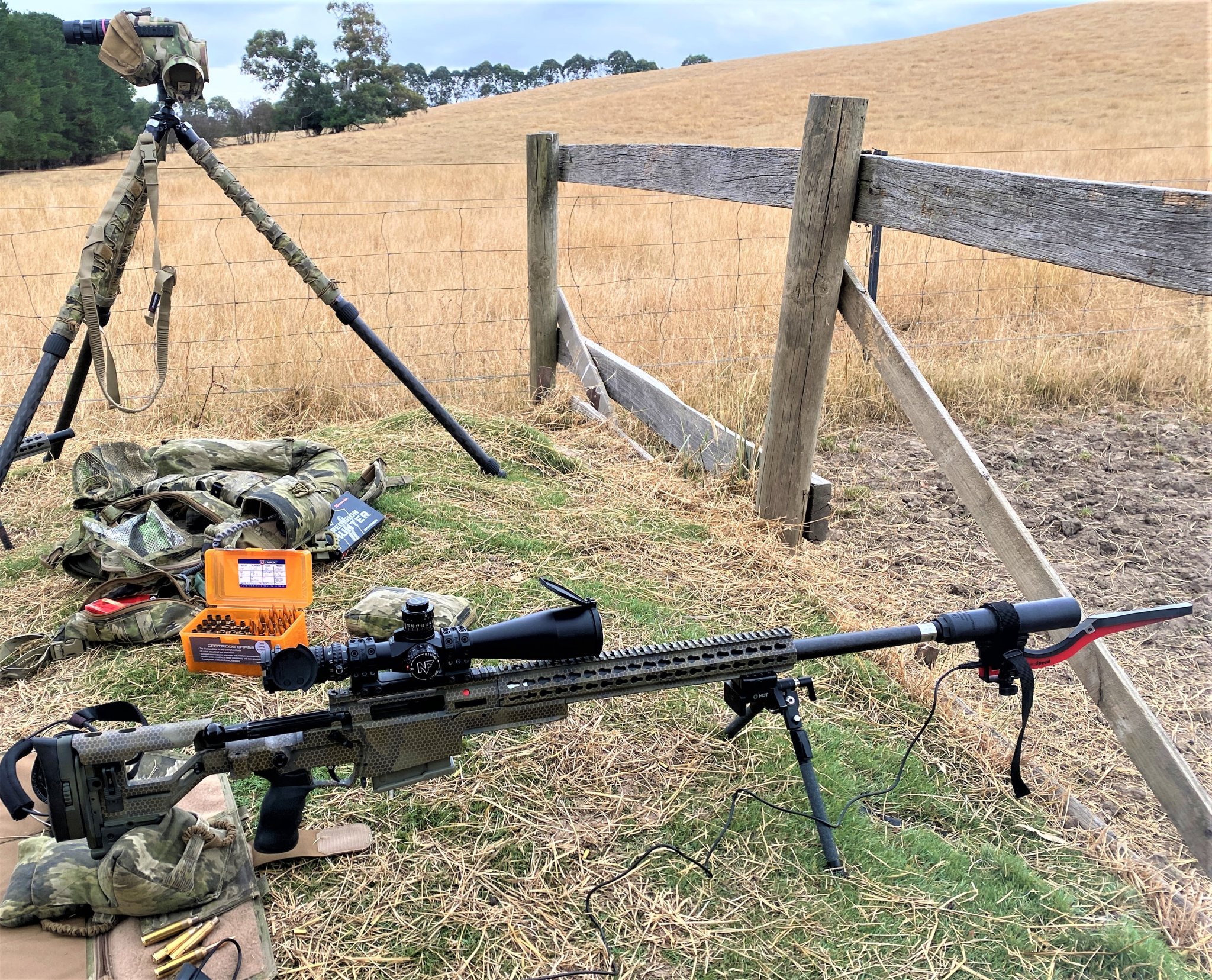

I’m single feeding

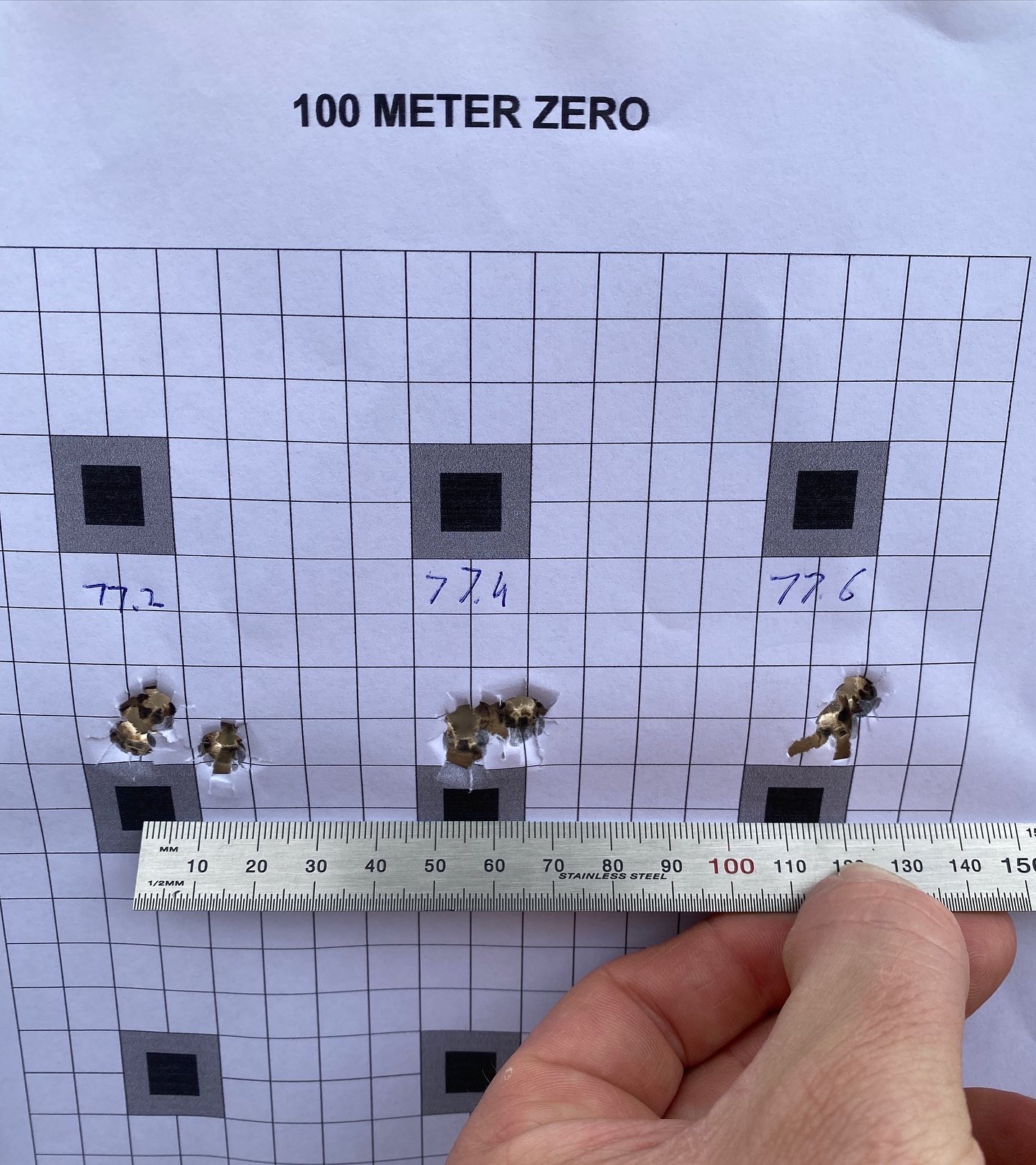

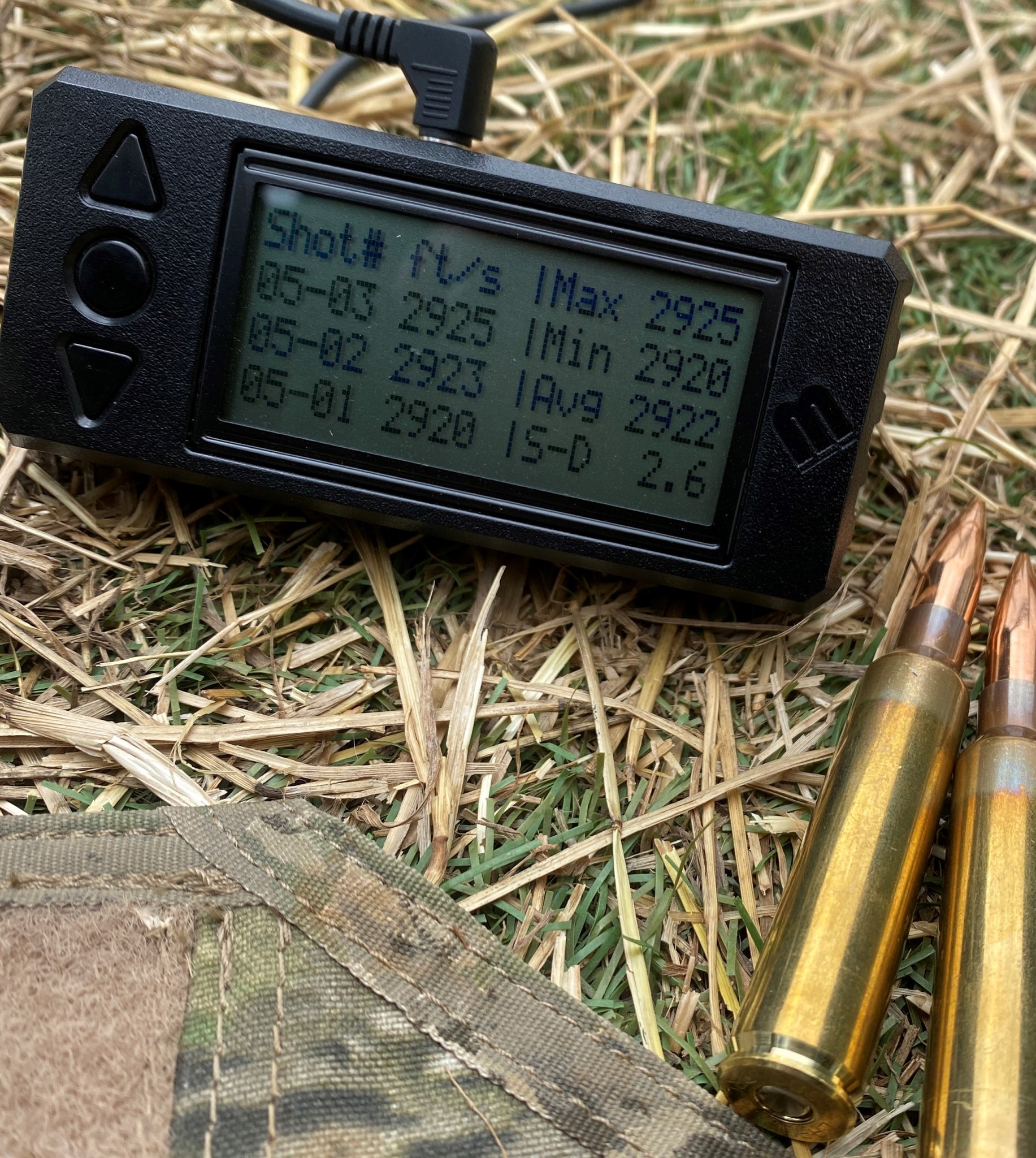

Lapua virgin brass, expander mandrel, trimmed, deburred.
Berger 210 VLD Hunter 30cal
Fed GM215M primers
ADI AR2217 (H1000) - 77.6gr is my final load.
0.020" approx off lands.
77.0 up to 77.8 were all below 0.5 MOA... So, these are awesome and very easy to load.
Fed GM215M primers
View attachment 7795466View attachment 7795467View attachment 7795468
I'd be interested to see how your load changes with 1x fired. It was my experience that I had a lot of body expansion from virgin to 1x fired. I had to back down .7gr to get the same velocity without pressure. This was with the first revision SAMMI reamer and Redding dies.
