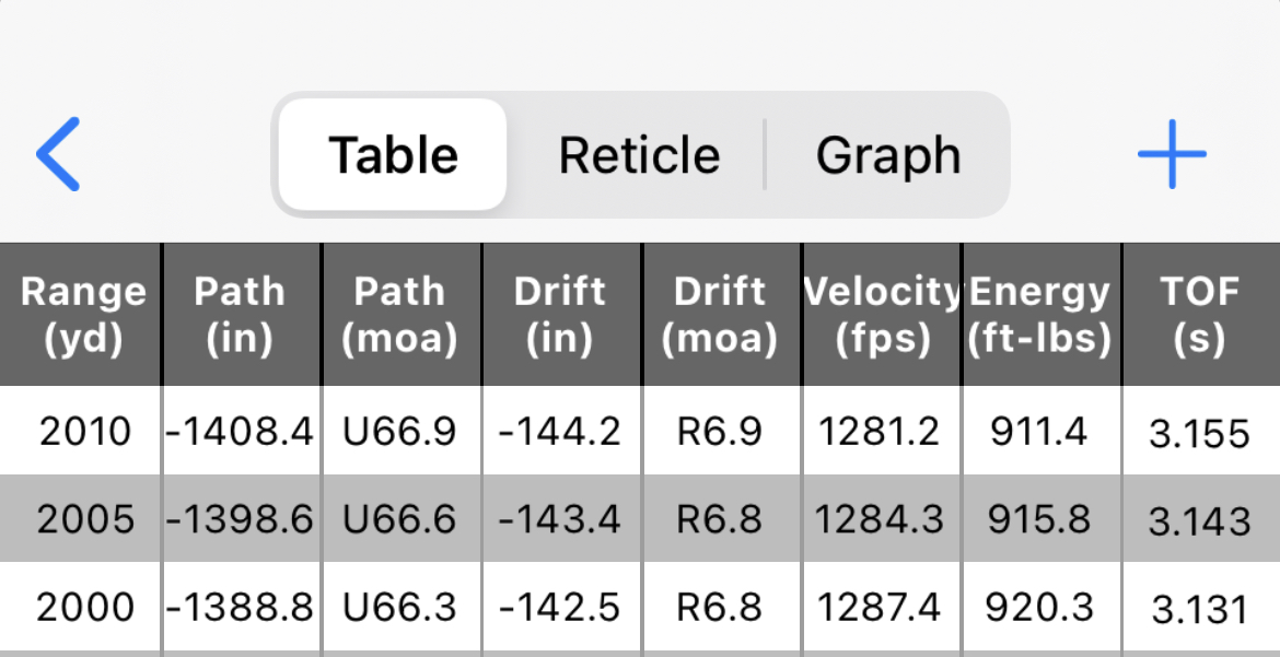

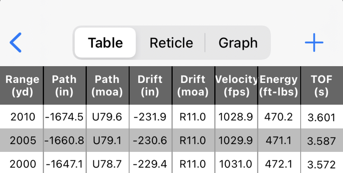

At 1 mile not a huge difference but still noticeable wind. But that's if you get the 250 at 2850. Which is very doable specially in the norma. Those 230 Sierra should work great
The lighter recoil is nice and I'm hit the steel...
Run the numbers through JBM out to 2500. At 1500 you still get less wind drift with the heavies at 100-200 fps slower. That ends up being less recoil than the lighter bullet at faster speed or about the same. Drop is more with the heavies but wind drift is better.

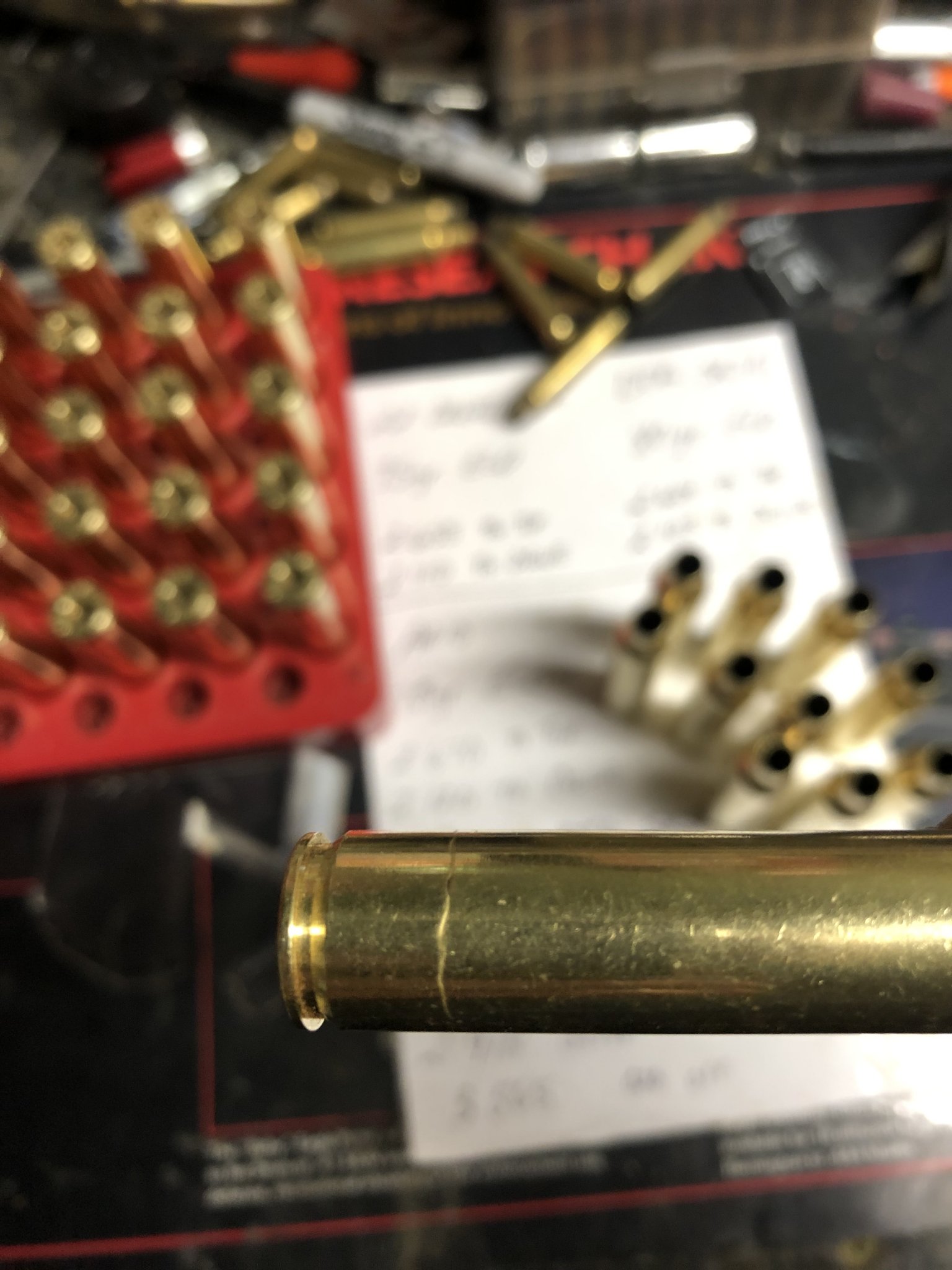

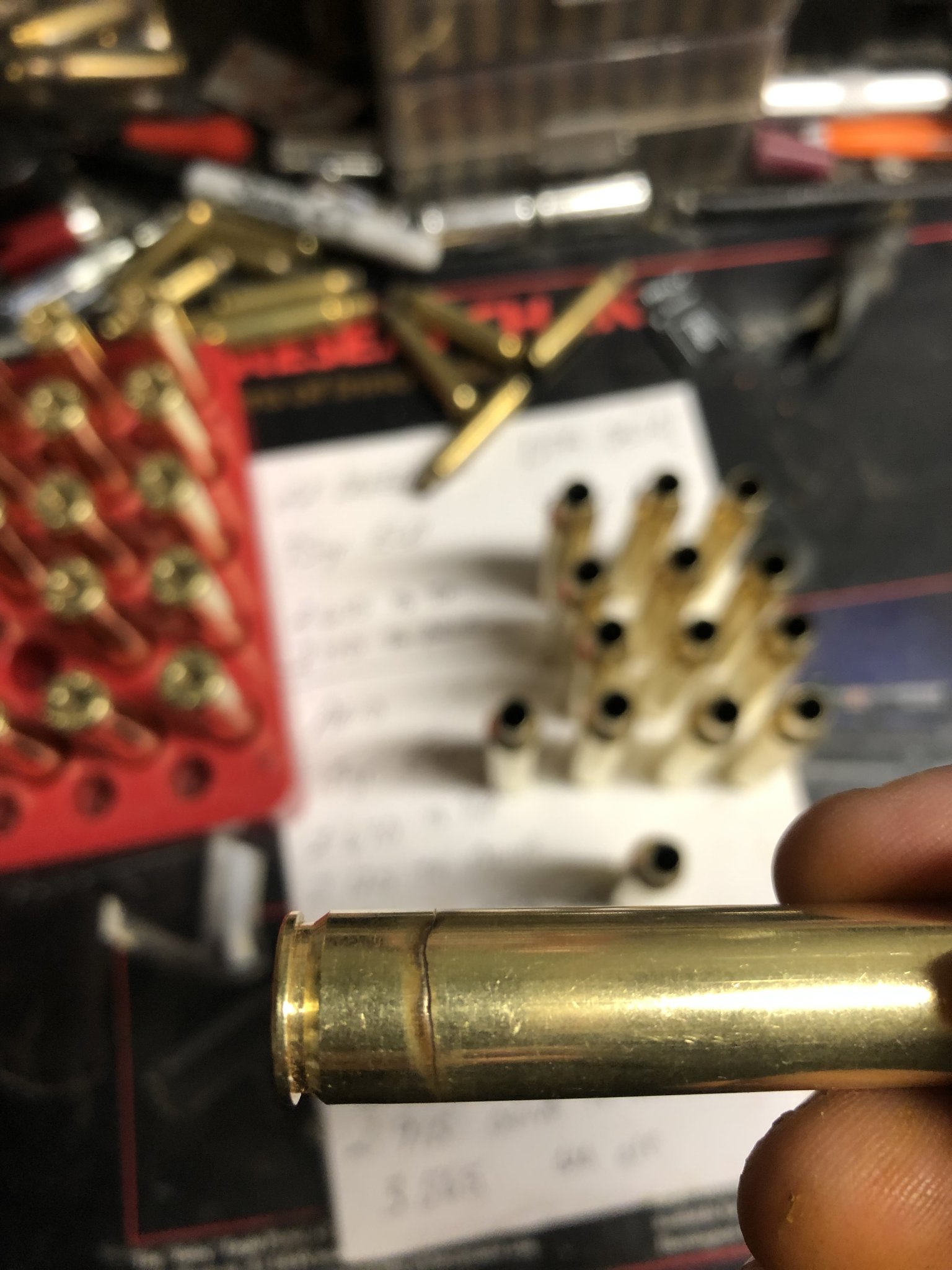

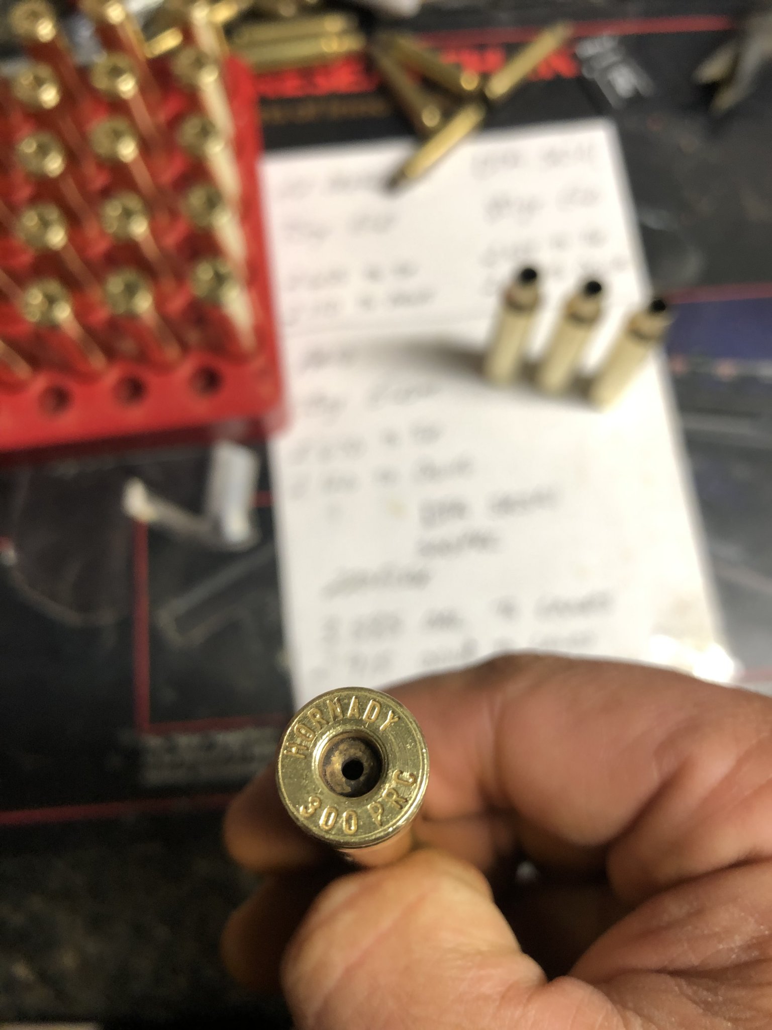

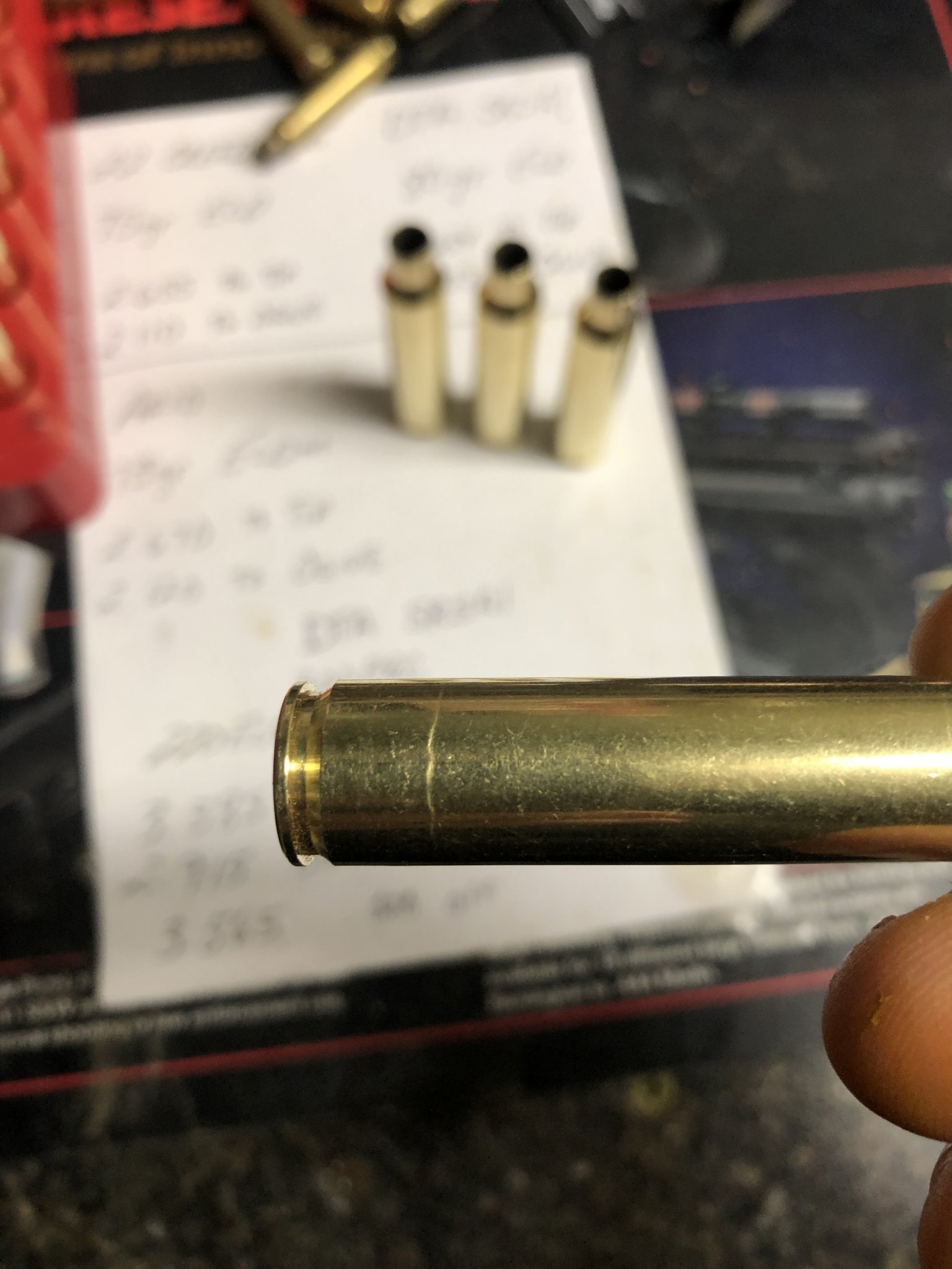

I’ll try to add to this thread before starting a new one. I ordered up a 300prc conversion kit for my Desert Tech SRS A1 this summer for an elk hunt. I ended up developing a load for the 220gr ELDXs using Hornady brass (all I could find at the time) 77.6gr of H1000, and CCI250s. That load had single digit SD with an average velocity of 2,850 from a 26” barrel. I kinda wanted 2900 but they were more inconsistent.
Anyways, I shot 76 rounds during load development and dope verification out to 850 yards before my hunt. Every round I loaded was from brand new Hornady brass that I did a quick pass through a full length sizing die to straighten out the necks. When I got back from my hunt, I decided to size and load all of my once fired brass so everything can be put away for awhile. Upon inspection, I’ve got 15 cases that either have a crack or look close to starting a crack at the classic sign of case head separation. A couple of them have a faint ejector mark from when I was pushing for velocity a little, but most do not. I’ve pushed brass harder than this in several other guns and calibers and have never had a concern about case head separation after the fist firing.
Obviously I have either a headspace issue or a bad batch of brass, or a combination of both. I need to track down a headspace gauge and I’ll shoot a round this weekend to compare my fired brass to a new resized one.
Obviously I have either a headspace issue or a bad batch of brass, or a combination of both. I need to track down a headspace gauge and I’ll shoot a round this weekend to compare my fired brass to a new resized one. View attachment 7730184View attachment 7730185View attachment 7730186View attachment 7730187
I think you nailed it headspsce, brass or over pressure. I've had some bad Hornady brass in past but can't speak on 300 prc Hornady brass.
wow, good catch. I've had that from 6.5 Horn brass when I was sizing it way too much (learning). Even then it took 4 or 5 loadings. I now bump minimally...Not saying that's the case here.
That Chassis looks awesome. I just scored ~75 new ADG cases
I'm about to load some more mild-moderate loads and try this weekend after the local match.
I just ordered an AMP Annealer, I guess my question now is should I anneal size and neck trim the virgin cases, or shoot them all once then do all that?
My max yardage right now is 1250 so I can load them nice and soft for initial fire forming and look for higher vel nodes on the next round.
Well, the big picture is a bummer, but at least you didn't have a horrible failure that led to injury. It is significant to this issue that DT's have strong actions and can take pretty high pressure. I'm not a fan of Hornady brass for reloading, but I have reloaded it for a few calibers without problems. I'd be tempted to push a few primers into your failed brass and some of the once-fired brass. If you have any virgin brass, that would be good for comparison. You might get a hint about whether your reloads were a big part of the picture or if headspace was the major factor. When I'm working up a load, I measure base-to-datum unfired and fired, after sizing, then after second firing, just to find out what's happening in the chamber. I want to get to where I size the case body and neck as little as possible and still function properly.
Do what you have to do to get some Lapua or ADG brass. Good luck trouble shooting it.
Right now I have to lean headspace because my loads fall in line powder charge and velocity wise with the many posts of real world data in this thread. I’ve never experienced case head separation in almost 25 years of reloading. Granted, I haven’t pushed a cartridge to the edge for several firings like some do, but to have new brass do this is something new for me. My bullets were .020 off the lands and most of the bad brass doesn’t even have an ejector mark or any other obvious sign of pressure. Also, all rounds were clocked with my labradar and all charge weights made sense.
wow...that is some serious head space issues. I've pushed Hornady, ADG, and Lapua brass harder than anyone that I know of...and the only time I had case head separation starting was on some brass that I over sized 9 thou or more. If you follow the direction on most reloading dies....you'll be over sizing...sometimes....a lot....but it will fit.
