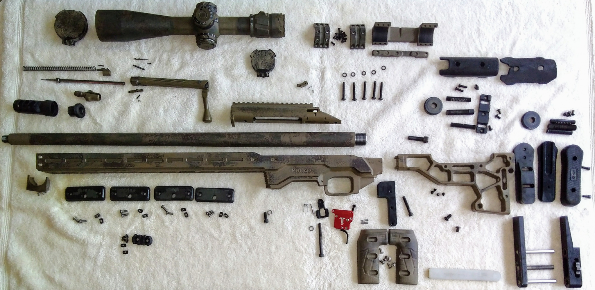

This past Sunday, a friend and I did a local team match. The format was a sniper style match of calling headshots for bonus points or going for the easier-er body shots. This match was at TVP. I've shot here hundreds of time and recently have won 1k and 1 mile bench rest matches and an ELR match. Sunday's match should have been a cake walk of targets ranging from 385 yards to 1140 yards with a bonus shot at 1 mile. Targets were generous since we were shooting IPSECs and 8" rounds for heads. I failed miserably. Why? Hard head and being tired from a long week of work and no sleep?.....PFFT!!! No excuse...but it is what it is. My partner asked me more than once if I had checked my torque on my action screws....and more than once I acted defiant and said yes...at home before the match.
Clue #1. You shoot 40 rounds in the sight in period and still have no clue.
Clue #2. You call a head shot at 385 and center punch it and then transition down a few inches to the body shot and hit 2 feet in front of the target.
Clue #3. You come in 2nd to last place.
Clue #4. Everyone around you is asking WTF is wrong today?
Clue #5. Go to put rifle away for the day and feel a rattle from stock to Barreled action.
Yep...I'm a dumbass and cost my partner a chance at winning...or atleast placing high for the match. SO, I don't like losing. I don't mind it...if someone has a great day and beats me...I'll shake their hand. I don't mind if I know I just don't have it that day, but I did my best and managed a top 10 finish. However, when I have no friggin clue, and my head is no where in the game...I get frustrated. So, today I started a complete tear down of my rifle. I will build it back and check the torque on everything...and I mean EVERYTHING. I will end up replacing most of the bolts, screws, pins and springs with new. I'll also check certain things just before the match starts. This weekend was embarrassing...and I brought it all on myself.
Today so far:
Experience often includes pain, but pain is a great teacher. You probably won't make that mistake again. At least the target wasn't shooting back.
