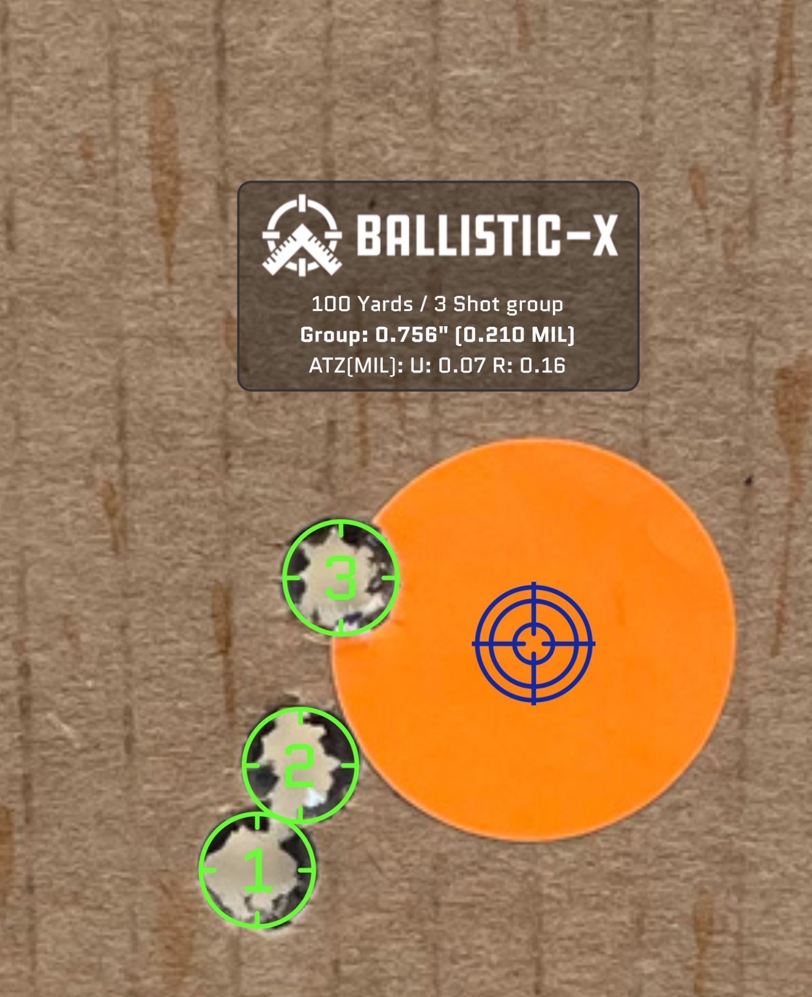

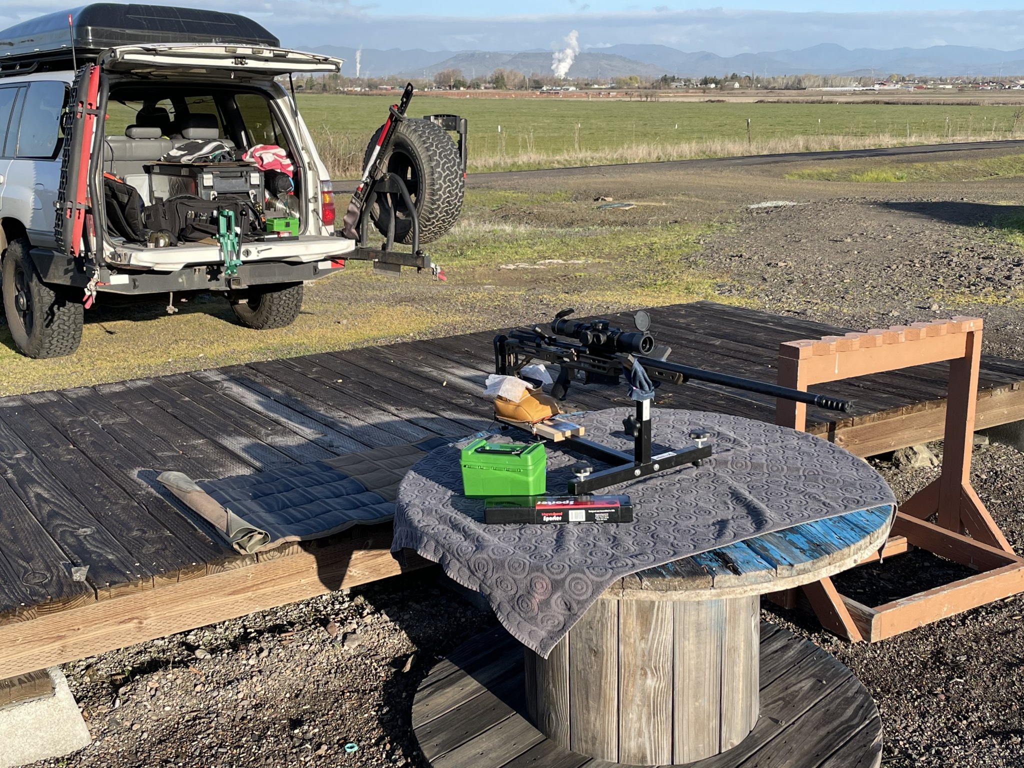

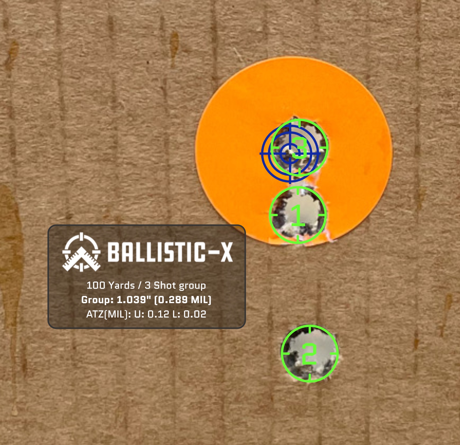

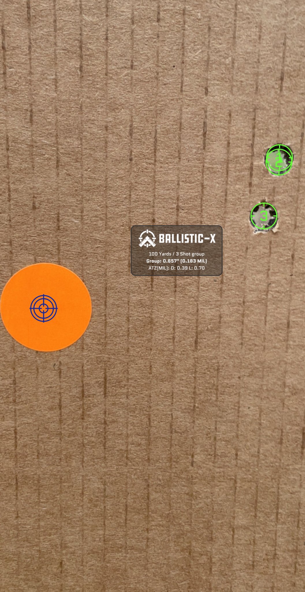

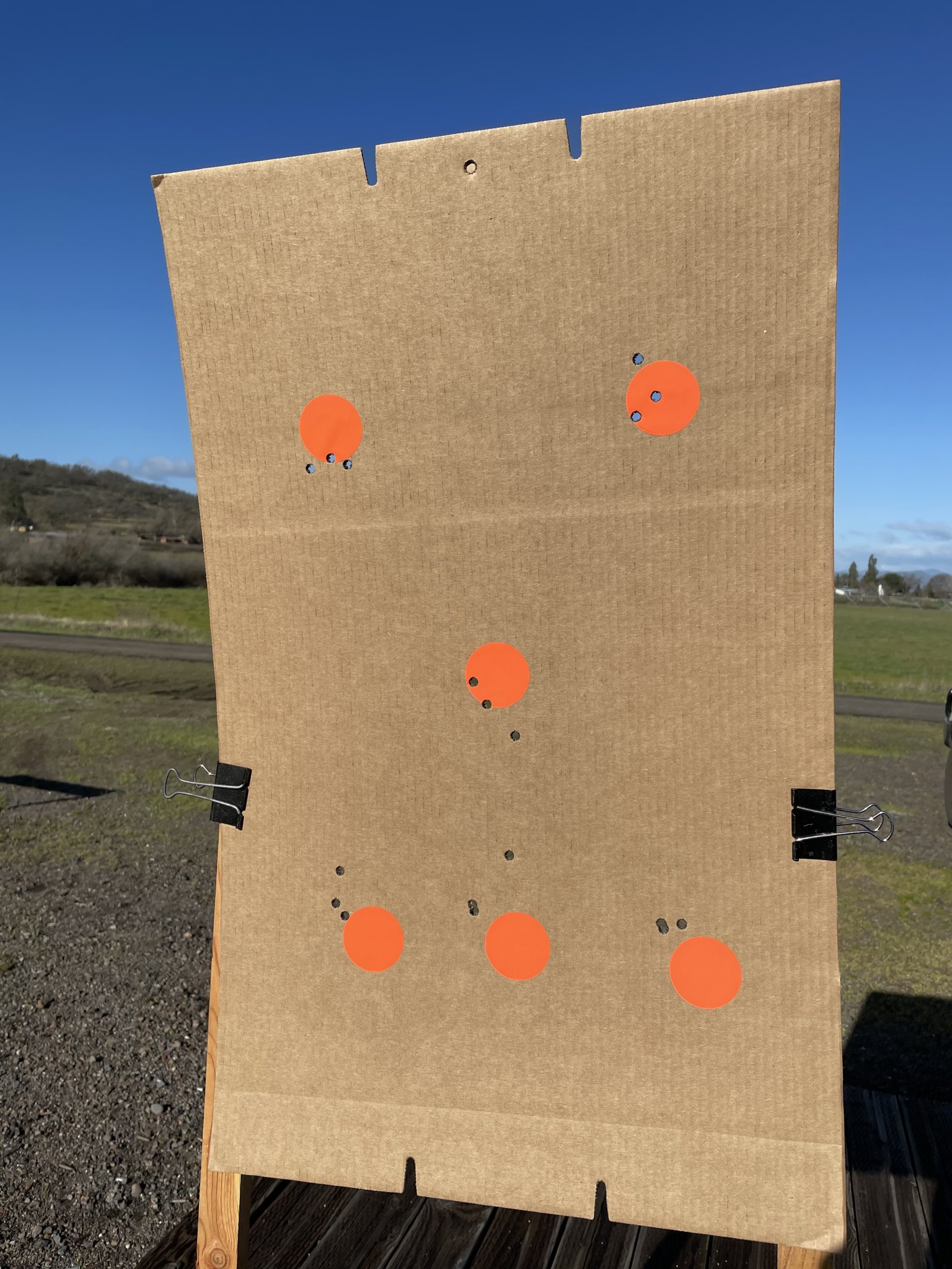

So after bedding my MPA and the scope base and lapping the rings, my groups definitely shrunk, and although they are not all that impressive I think if I can figure out where the vertical stringing is coming from this can be a .25” - .33” gun. I may need to mess around with the brake, as JBartons experience has indicated.
In the photo with 6 groups, those are 2” dots. They are 1” in the other three.
I’m shooting from a rest on an old rickety wooden spool, so that’s one of my problems I need to address. I’ll be shooting from an RRS ascend/anvil normally, but for load development I wanted free recoil. I was also racing the rain that day so I might have been subconsciously rushing the trigger too. First set of groups are what I was getting before bedding/lapping.
Range is 100
Load: ELD220 on 76.2 Gr. of R25 in Hornady brass with CCI #34 primers (all I have) bullets seated .002” from the lands.

I really think the stringing is coming from the firing point. Looks pretty unstable, you might consider putting the rest on a prepared spot of ground or off the pickup bed and shooting prone?
Yeah I’ve had that thought. Also considering bracing the spool up with 2x4s. It sits flat and solid but it’s so old that it is pretty rickety.
I'd say the stringing is coming from whatever that rest is....just throw an Atlas on the front and shoot. Always practice your groups exactly the way you intend to shoot for reals.

Yeah, I’m going to mess around with it. I got an earful from Boyd Allen over on accurate shooter for using my RRS and not doing load development from a free recoiling rest, so that’s what your looking at there. I think the spool it is sitting on is more suspect than the rest itself. If I stick with the rest I’ll probably put a bag under the front end to though.
