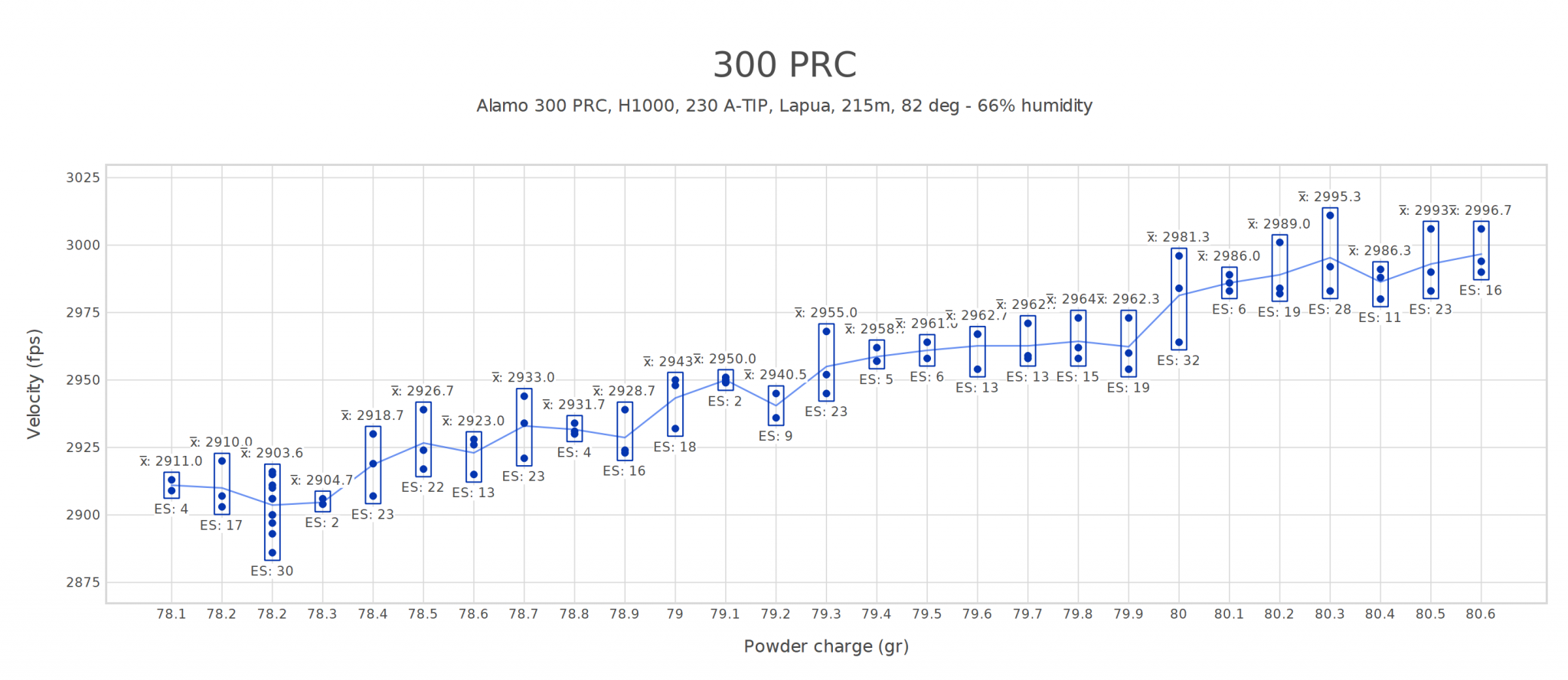

OCW results with new lapua brass. Definitely looks promising. As stated in other posts, necks were extremely tight. Initially ran thru .307 mandrel and seating pressure was over 100 psi. Then ran some .308 mandrel and got seating preasure in the 40-60 psi range.
All charge weights were 3 shots, except 78.2 where I was warming up the barrel.
What chart type is that?

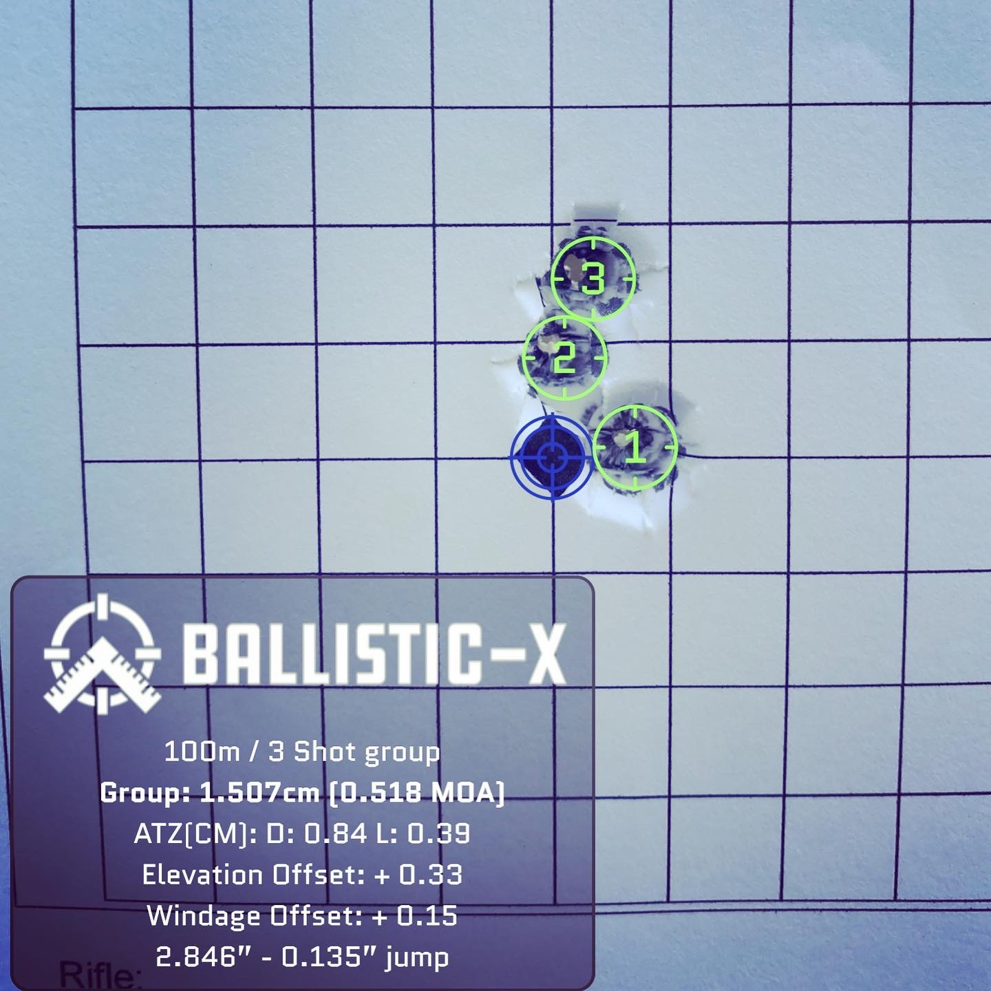

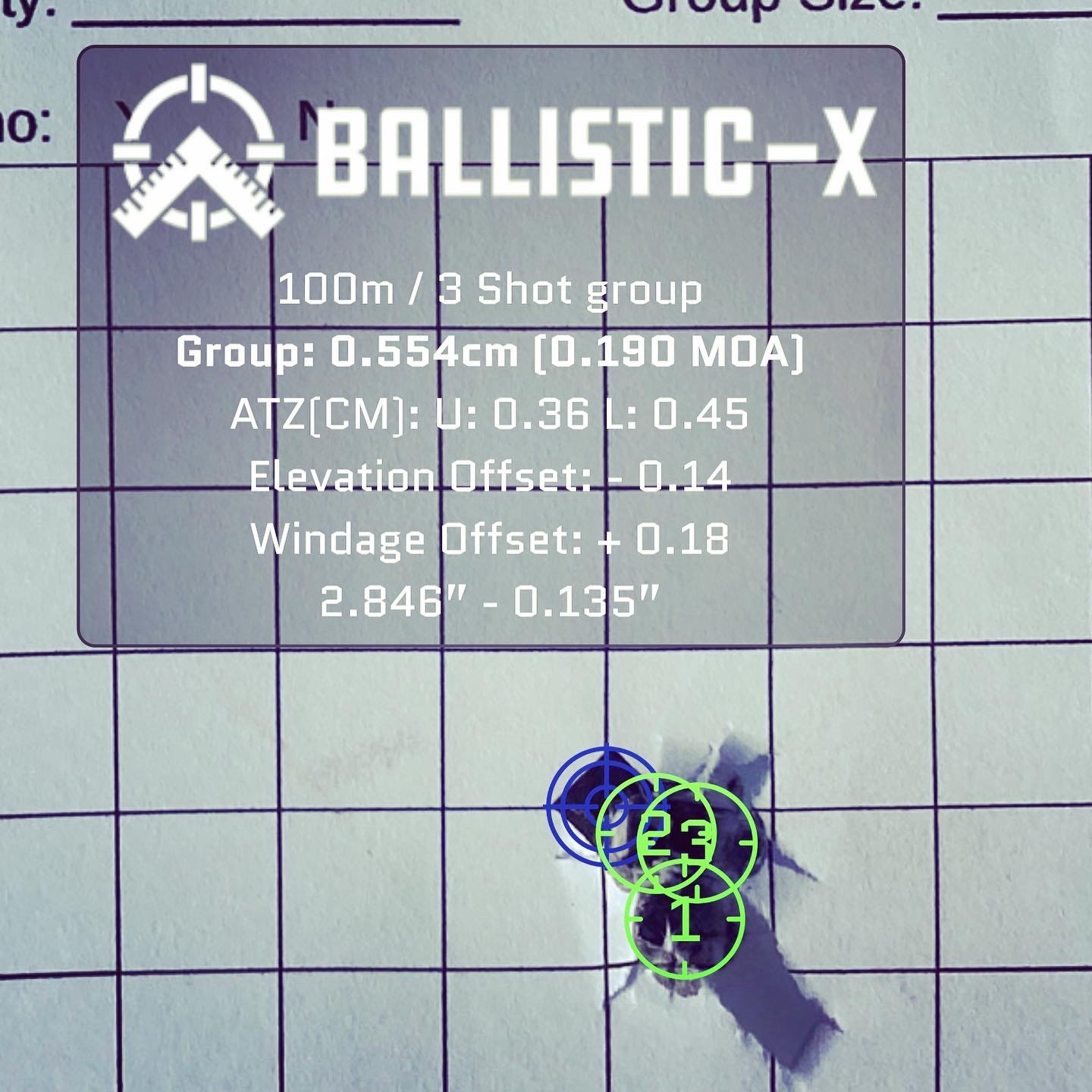

Seating depth, jump tests from 0.150”, 0.135”, 0.100”, 0.080” and 0.060”.
0.135” is good, might load some more up with minor tweaks up and down. 0.130” & 0.140” perhaps.
230gr ATips
ADG brass
215GM primers
ADI AR2225 powder
1:8” 26” barrel
2847fps
Barrel only has 110 rounds through it so far, going alright.
View attachment 7657703View attachment 7657704View attachment 7657705View attachment 7657706
