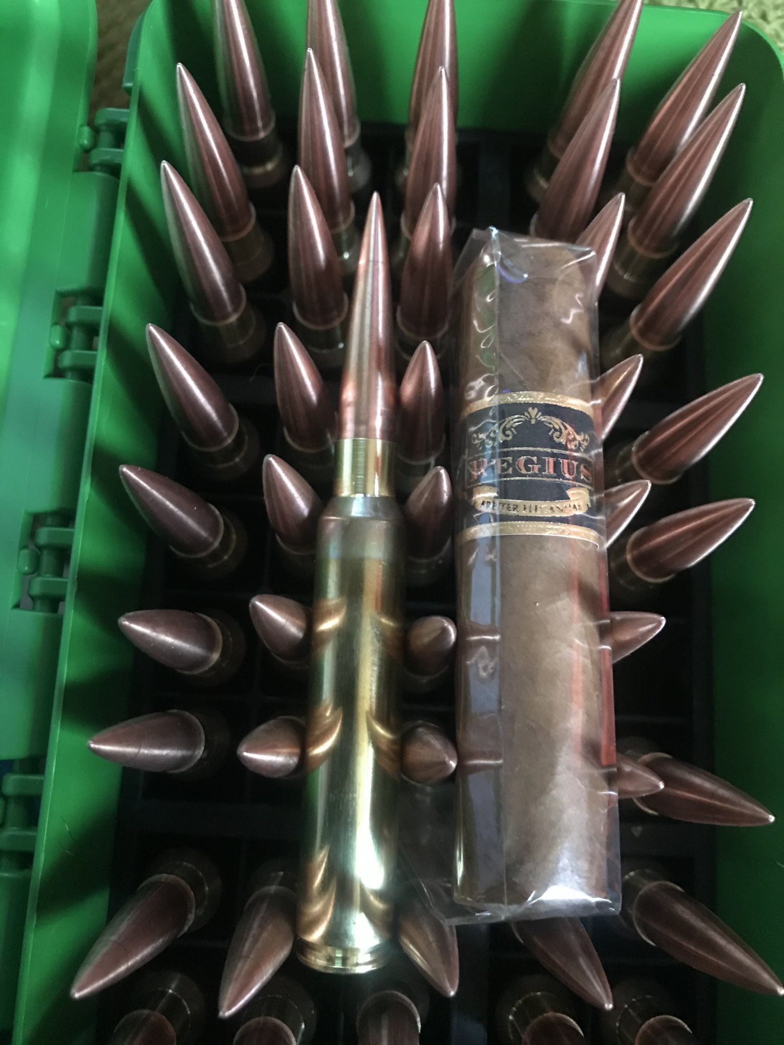

A Seneca round loaded in a 300 PRC case would likely be closer to 4” long.
I shoot this out of a short action Nuke
Magnum boltface and 4.25” long.

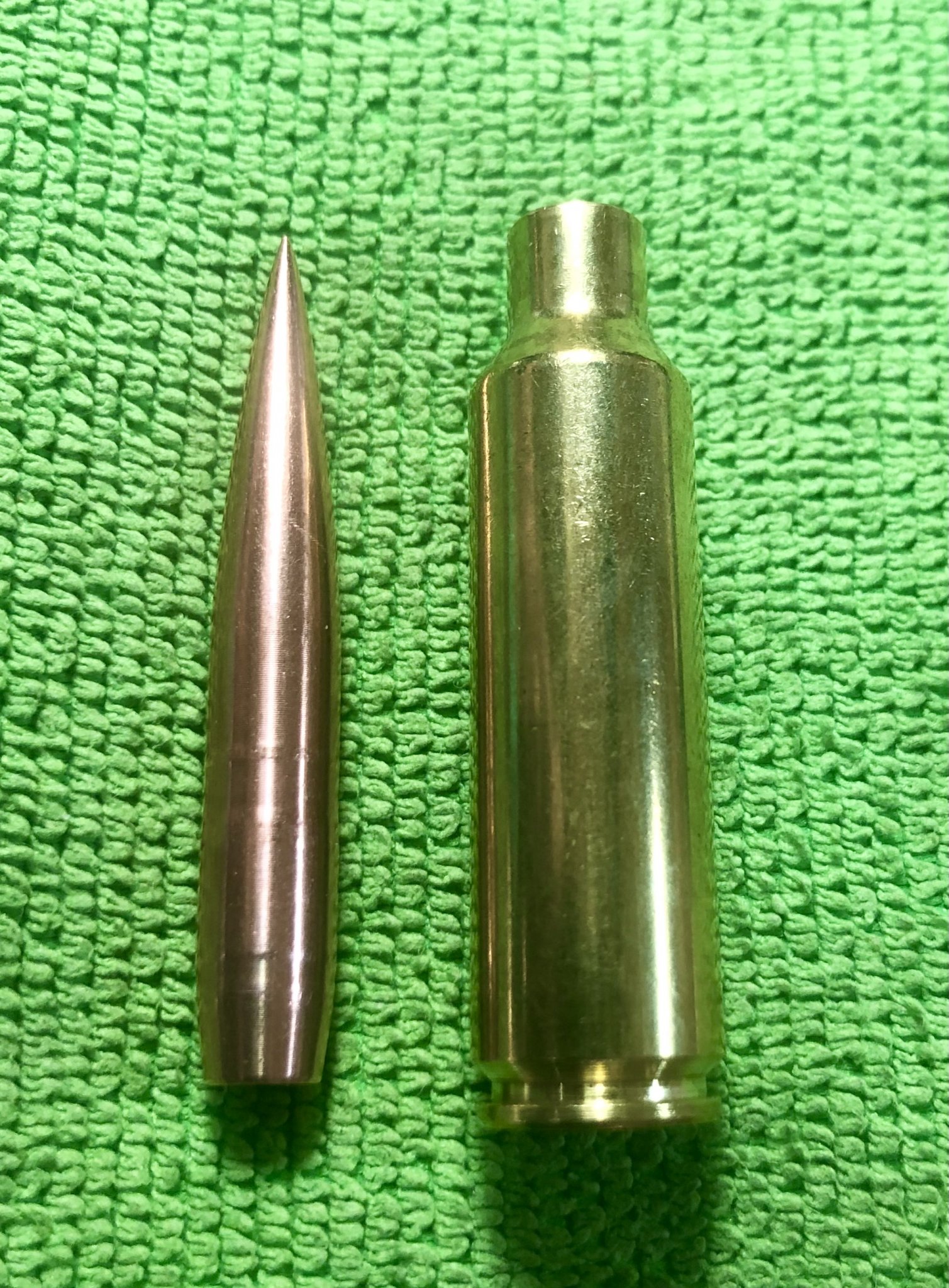

Ahh... So a 285 gn 338 bullet, with a G1 BC of 1.01. [... hard to make out the scale from the photos.] Thanks for sharing.
It seems we are in the middle of a technology race. Fascinating to watch, but soon we will all need new barrels with faster twist rate. 😊
I noticed their heaviest 416 “ICBM” bullet has a BC of 1.2... Wow!!

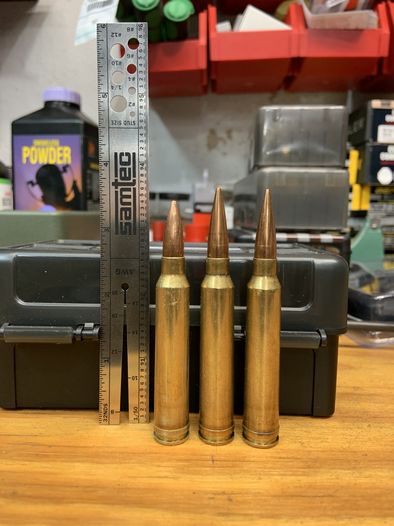

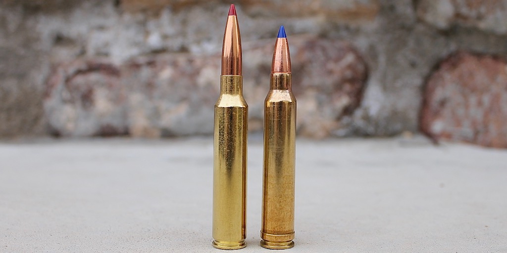

It depends on what 300 wm you’re comparing the PRC to. If it’s a winmag that’s been throated for heavies, the two cartridges are virtually identical. If you have a standard winmag chamber, and that puts 225/230 class bullets way down Into the case, the PRC will likely outperform it. The PRC is merely a blown out AND shortened winmag. The resulting capacity is the same, but in a shorter overall length.
No it’s really not
No it’s really not
Wrong!

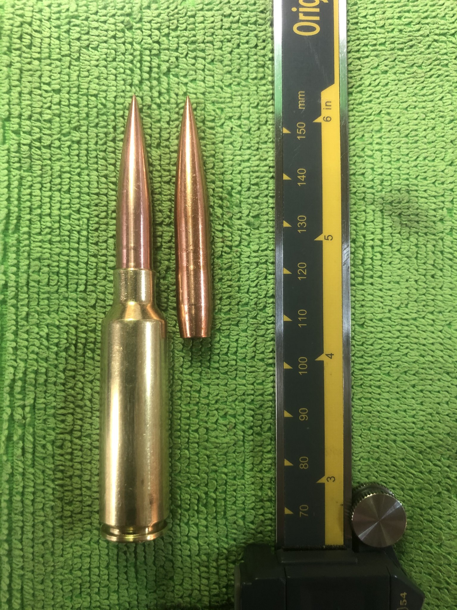

This is what my COAL is with my 0.050" throated Win Mag (3.600" chamber), and I would say that my 300 Win Mag is pretty much a belted PRC now that I have a throated match barrel.
I will add, that if I did not have dies and brass already for the 300WM, I would have gone the 300 PRC route. 300 PRC is nothing more than a modern version of 300WM, like the 375 Ruger is to the 375 H&H (Which sadly never took off). But unlike the 375 Ruger, it is here to stay. I also think that as more modern powders come out from the manufactures, the faster you will see them go with heaver bullets.

Factory Saami freebore on 300 win mag is basically 0 burying any bullets well into the case
Match chambers vary but the .140 freebore was pretty common before the super heavies became popular but that one would be excellent with 190-240 class solids
The other more modern 300WM chamber is a .230 freebore similar to PRC and Norma magnum for 215+ cup/core bullets and it will do everything the prc will do but at a longer OAL
