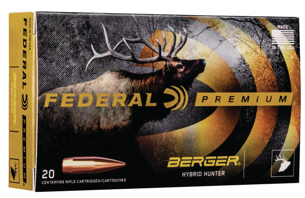

Where are you finding Berger 215gr 300NM ammo for $50.00/box?
ammoseek.com
Reactions: CarbonMTN
ammoseek.com
Ah, FEDERAL ammo with Berger bullets, not Berger ammo, which comes in Lapua brass that costs more than 2.50 for the case alone. The OP just said "300 Norma in Berger 215" without mentioning Federal, so it read like you meant Berger ammo.
Reactions: shoot4fun
