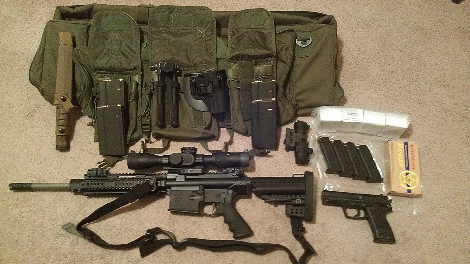

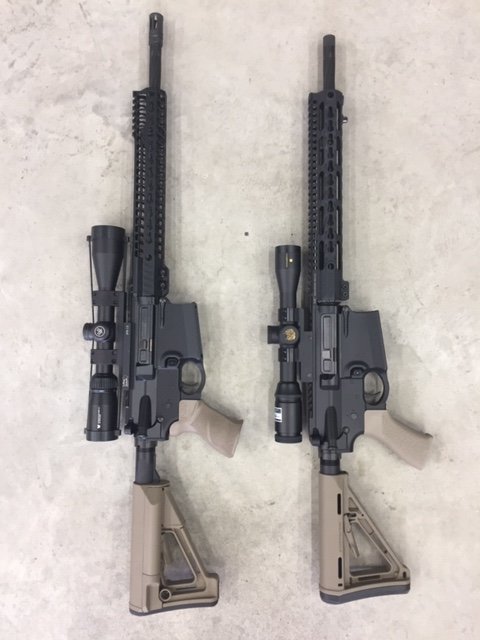

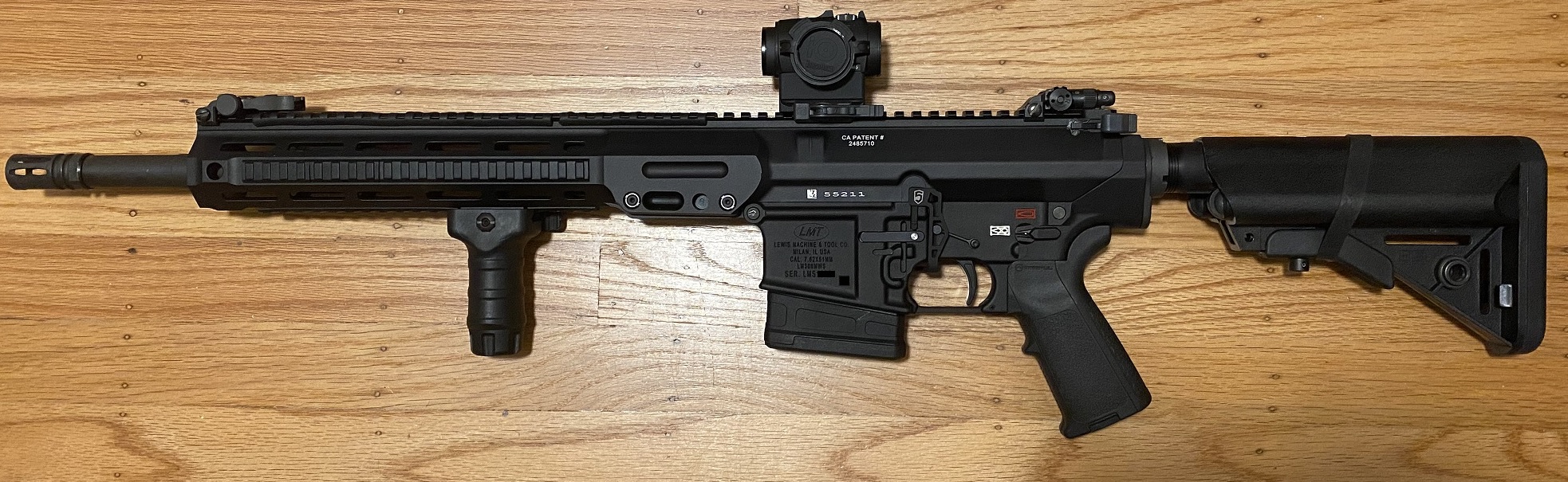

My effort to make a decent compromise in a.308 AR, and I'm pretty happy with the result. However, now that I've got the precision bug, and have found this place, I may try a conventional scope, with a bipod and see what she can really do. She'll never be a long range gun seeing as how I made her short, and handy, but I would like to see just how much accuracy I can get out of her. I do have a 4-12x44 Vortex Crossfire II sitting around not doing anything... It may lead me to getting her some real nice glass if I can find a load the BA Hanson barrel really likes. So far, she's hovering just around 1". ( a couple groups just under) That's with the PA 1-8, and in keeping with the BA accuracy guarantee, (168 gr FGMM) so I can't complain...
Receivers... Aero Precision with their LPK
Barrel... BA Hanson 14" with pin-and-welded Warcomp
Rail system... Midwest Industries
Scope... Primary Arms 1-8 with the ACSS reticle
BUIS... Troy with tritium
BCG... Lantac enhanced
Recoil system... JP Captured
Trigger... Geissele SSA-E
Furniture... Magpul CTR stock, MOE grip, MVG M-LOK
Weaponlight... Surefire M300 Scout Light
Leftover ambidextrous safety that I can't remember where I got...
Leftover scope mount... same deal... just happened to work out well.
Also of note is the barrel twist. It's a 1/10. Everyone makes barrels in 1/10 these days for the heavier rounds. I got my hands on a stash of the 130 gr Federal T762TNB1 as I figured a short barrel round would do well in my little 14"gun. Turns out it's quite expensive to find an AR barrel in 1/12 twist... This one shoots the heavier rounds better. However, at close ranges, it's still plenty accurate for a combat rifle with the PA 1-8 at the ranges I'd see in my AO. I may try some 175s once I get more scope on her, and the ranges open up again.

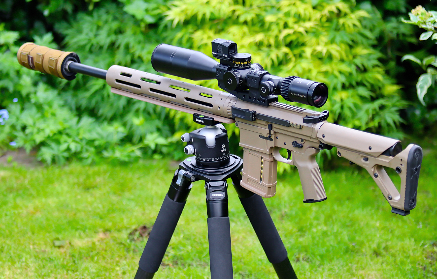

2A Xanthos Receiver Set and Handguard
16” 308 Proof Research Carbon Barrel
JP VMOS & SC Spring
SLR TI gas block
Q Trash Panda
Vortex Gen III Razor
Geissele Trigger & Mount

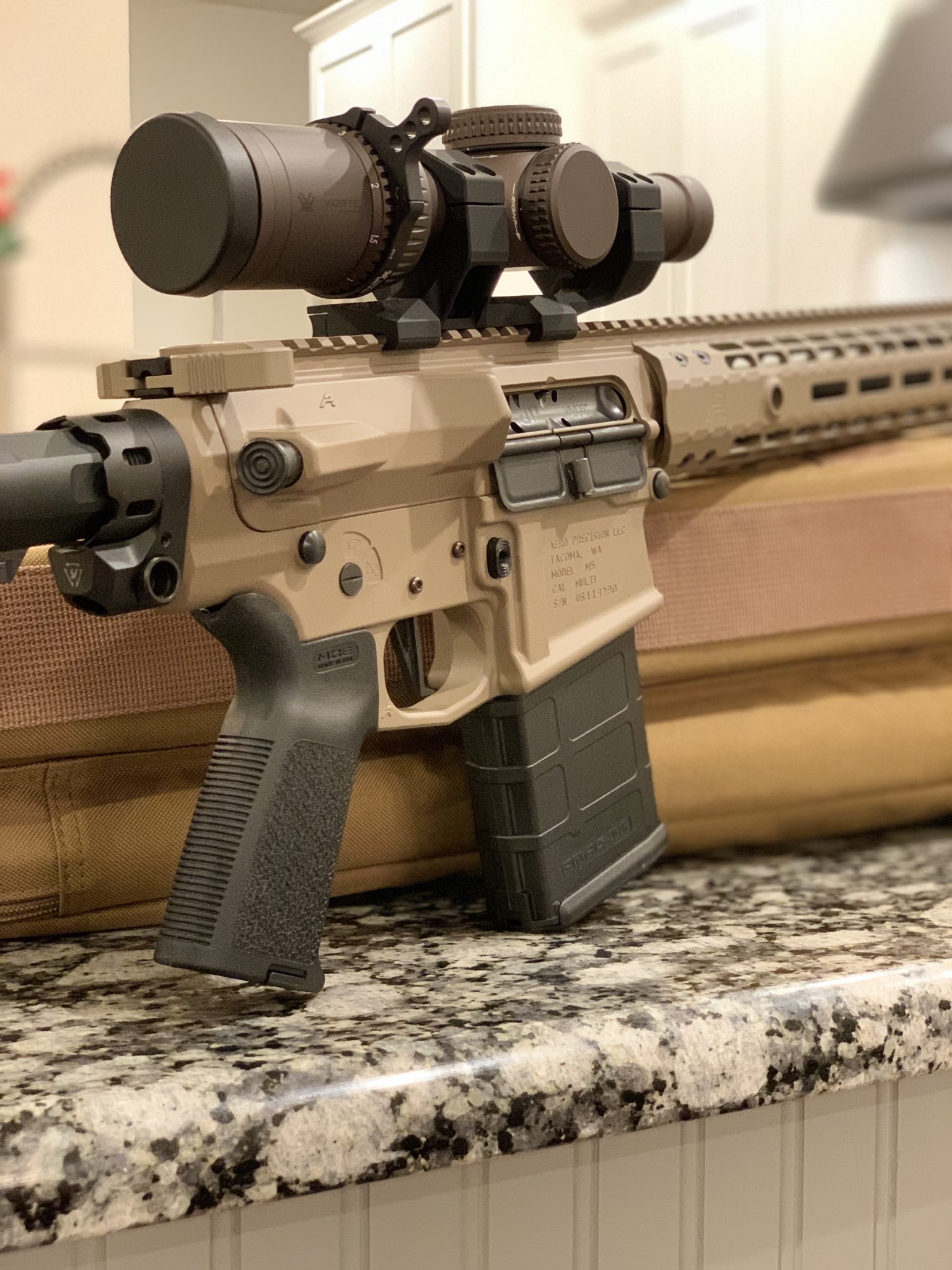

I am literally trying to do an almost exact build like this. I'm going for a longer Proof barrel though. Everything else is almost exactly the same. Nicely done!
When a customer signs up for his third custom rifle, you know what his expectations are - high. I don't think this will disappoint him: 20" 6.5 CM with Bartelin 1x8 barrel from Craddock Precision. Seekins SP10 Builder's Kit, currently made of Unobtanium. Area 419 brake - both super loud and super effective. Dialing that gas down with the usual SLR adjustable gas block. JP FMOS bolt carrier group with JP High Pressure bolt. Geissele Super Charging Handle. JP SCS in 7.62 H2 weight. Trigger Tech Black Diamond (It's actually RED, you know ....) dialed down to 2.0 LB. Cool plastic stuff by Magpul. Cerakote by We Plead the 2nd. Nightforce ATACR F1 4-16x42 with TreMOR3 reticle in Spuhr SP-4026 mount. Fitted hard case by Patriot Cases. Bare rifle weighs in at 10 LB 2 OZ. With scope and mount plus empty magazine 13 LB 2 OZ. Shot way-sub-MOA with Prime 130's at 100 yards from the start.

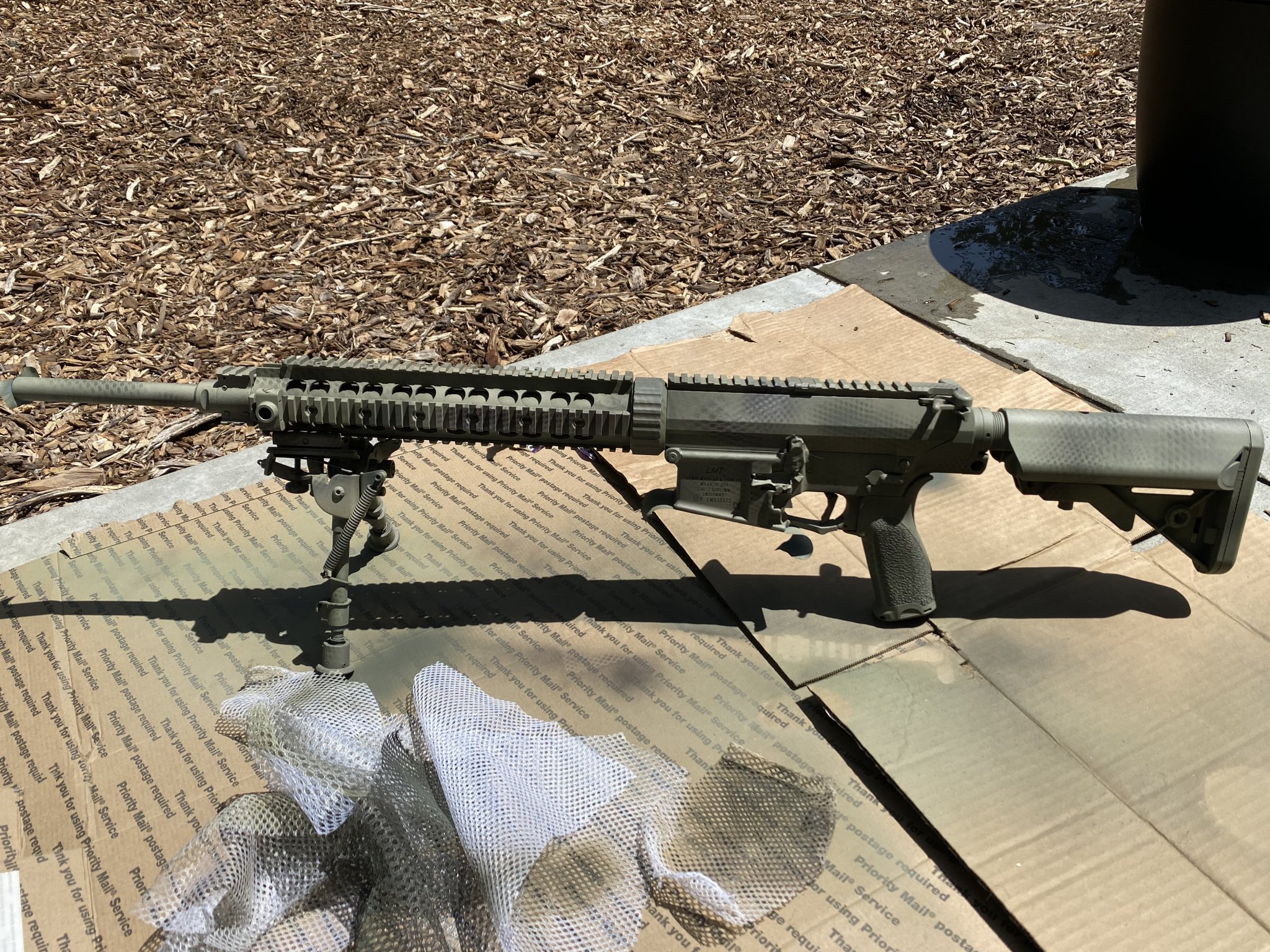

My election panic buy.
Predator Technology Group billet receivers (my buddies company)
Mcgowen 20" Hbar
SLR gas block and 16" SOLO rail
Geissele 2 stage
MOE rifle stock
Houge grip
Bushnell LRS 3-12 G2
[IMG2=JSON]{"data-align":"none","data-size":"full","src":"http:\/\/i.imgur.com\/VHV3lCX.jpg"}[/IMG2]
After Cerakote.......

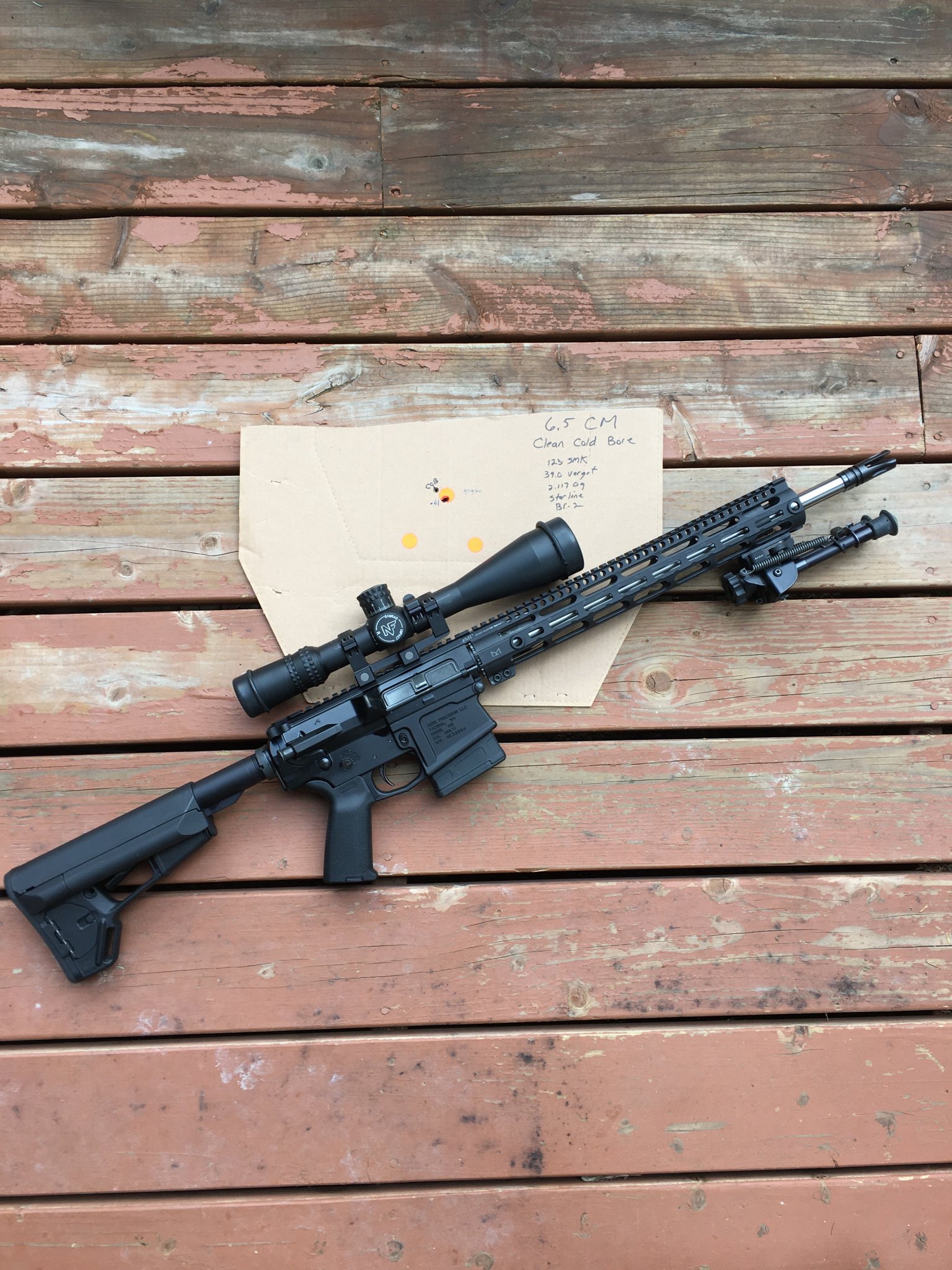

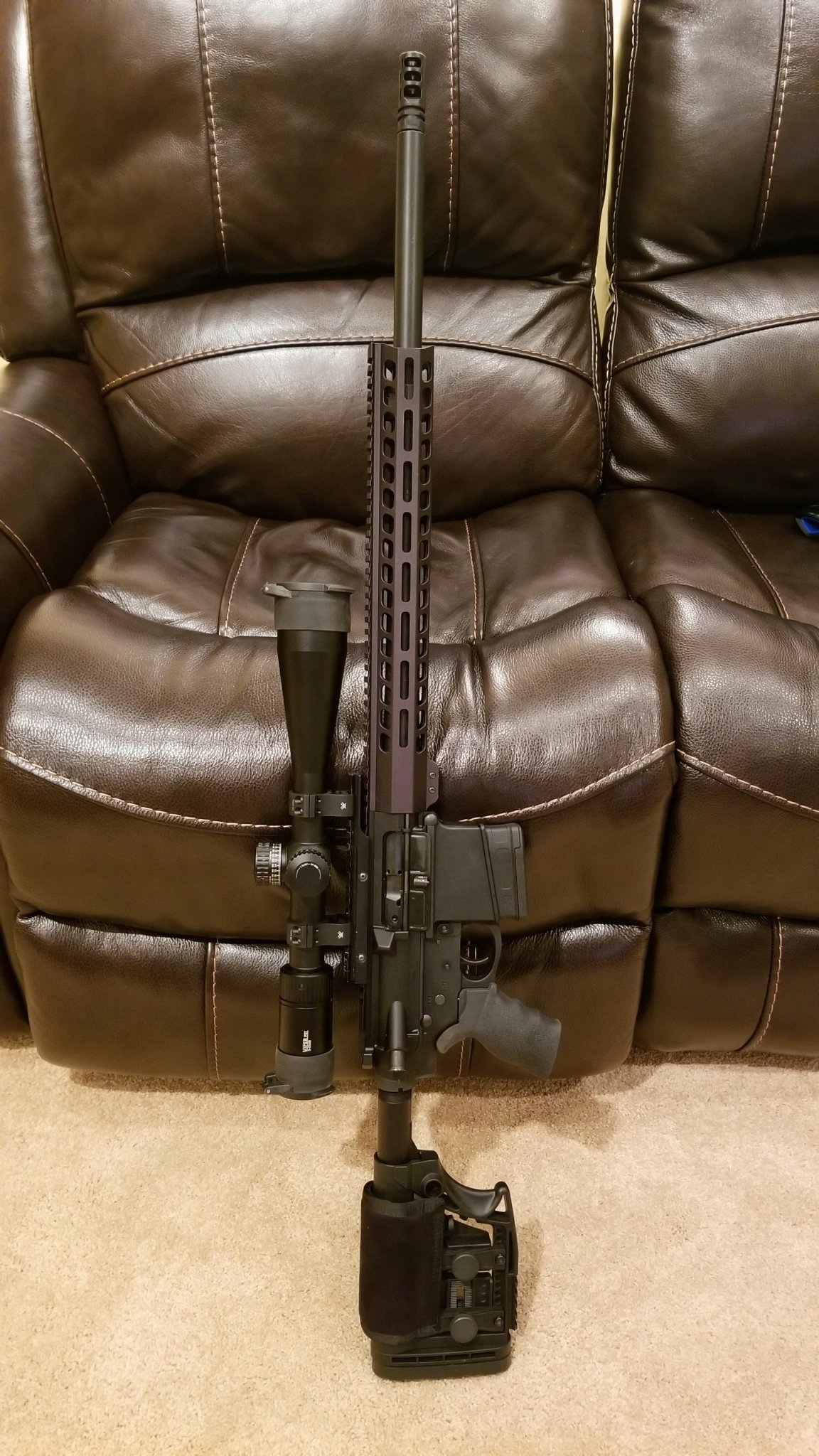

PSA 6.5 CM Chopped down to 16.5"
Seekins Precision Procomp 10x buttstock
Warne 20 MOA mount
Primary Arms Slx 3-18x50 FFP
Larue MBT trigger.
She my budget QWEEN

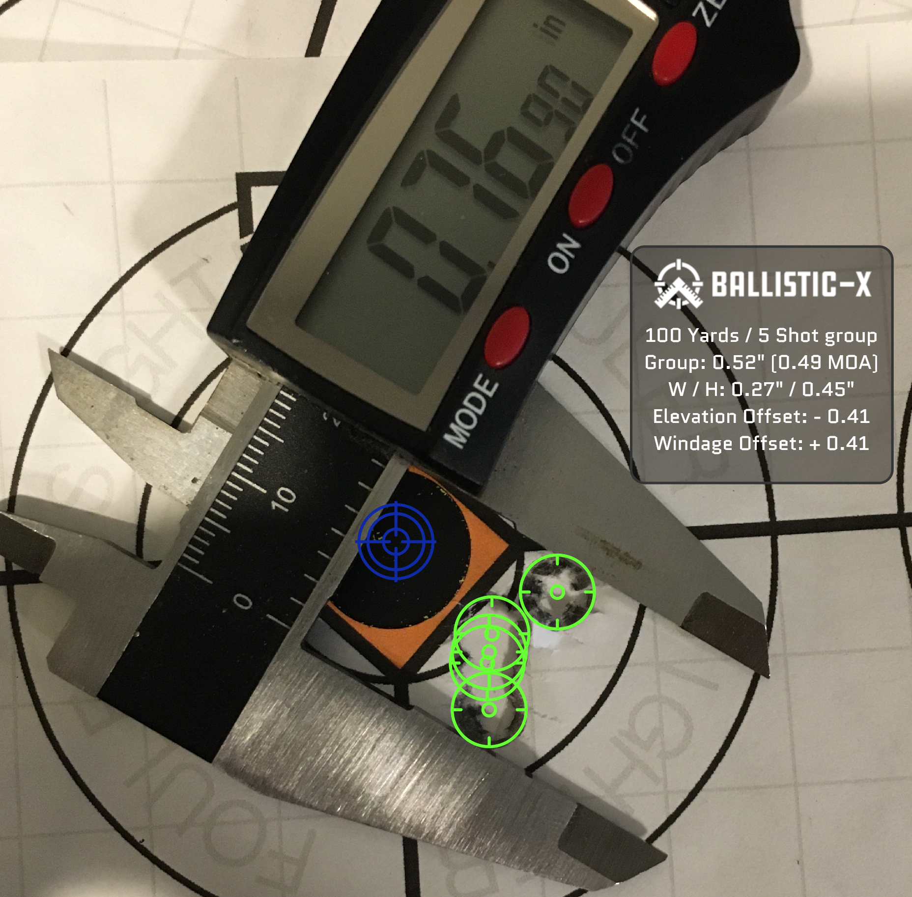

Best groups 3/4 of an inch (5 shot)
Have had much tighter 5 shot groups around .3" but including a flier brings it to about 1". So I wont count em.
For the money, she runs and prints sub MOA all day.

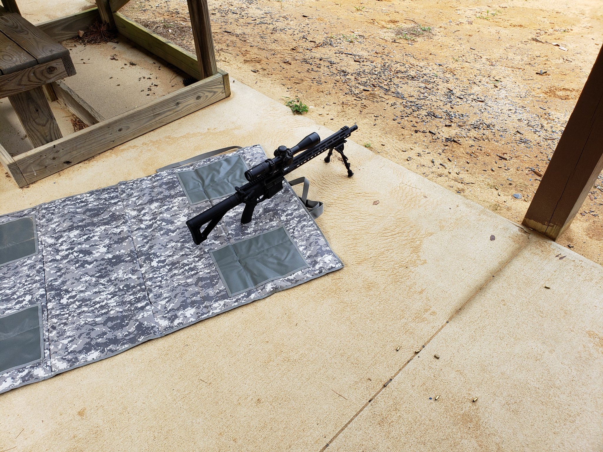

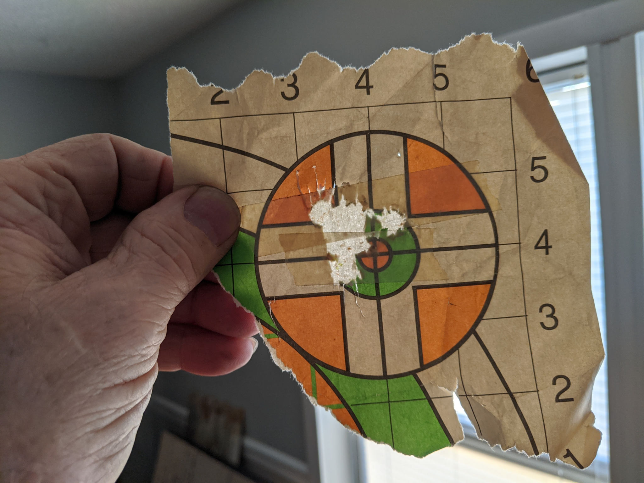

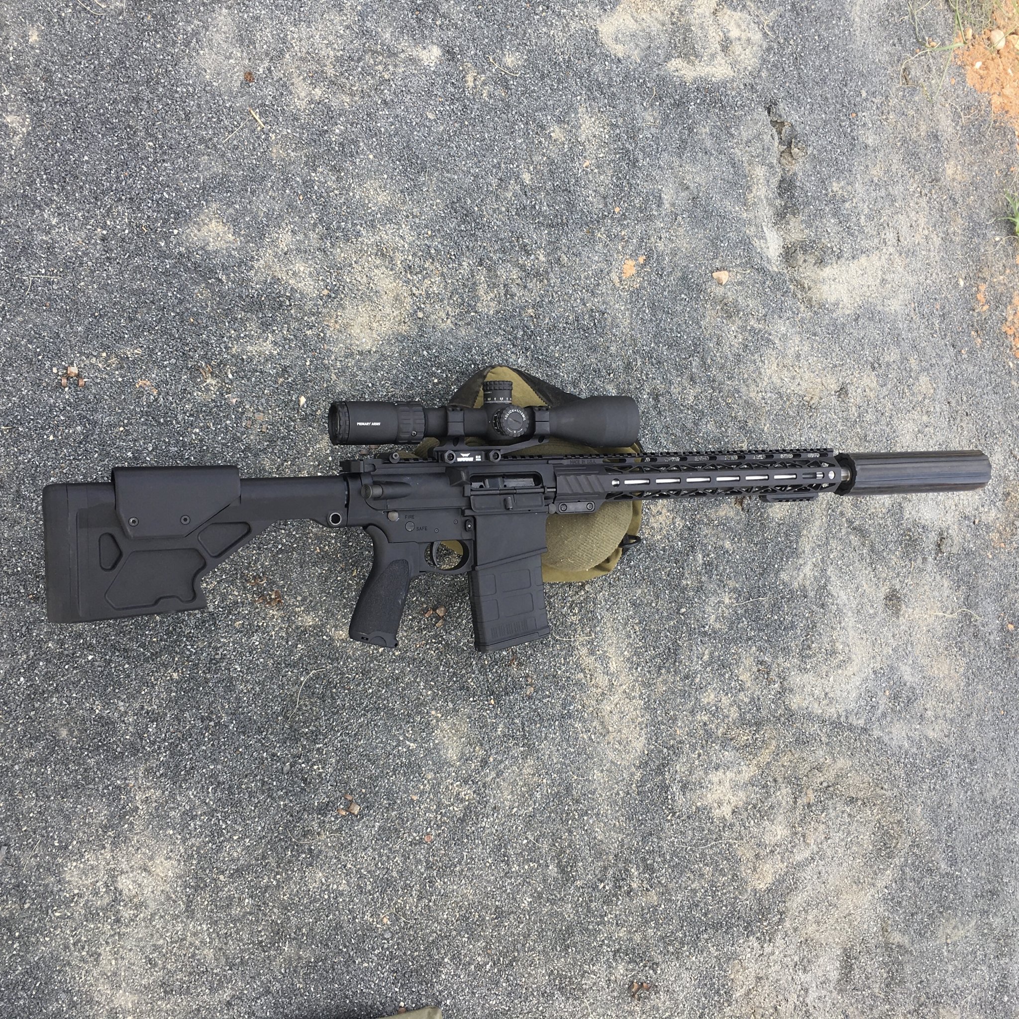

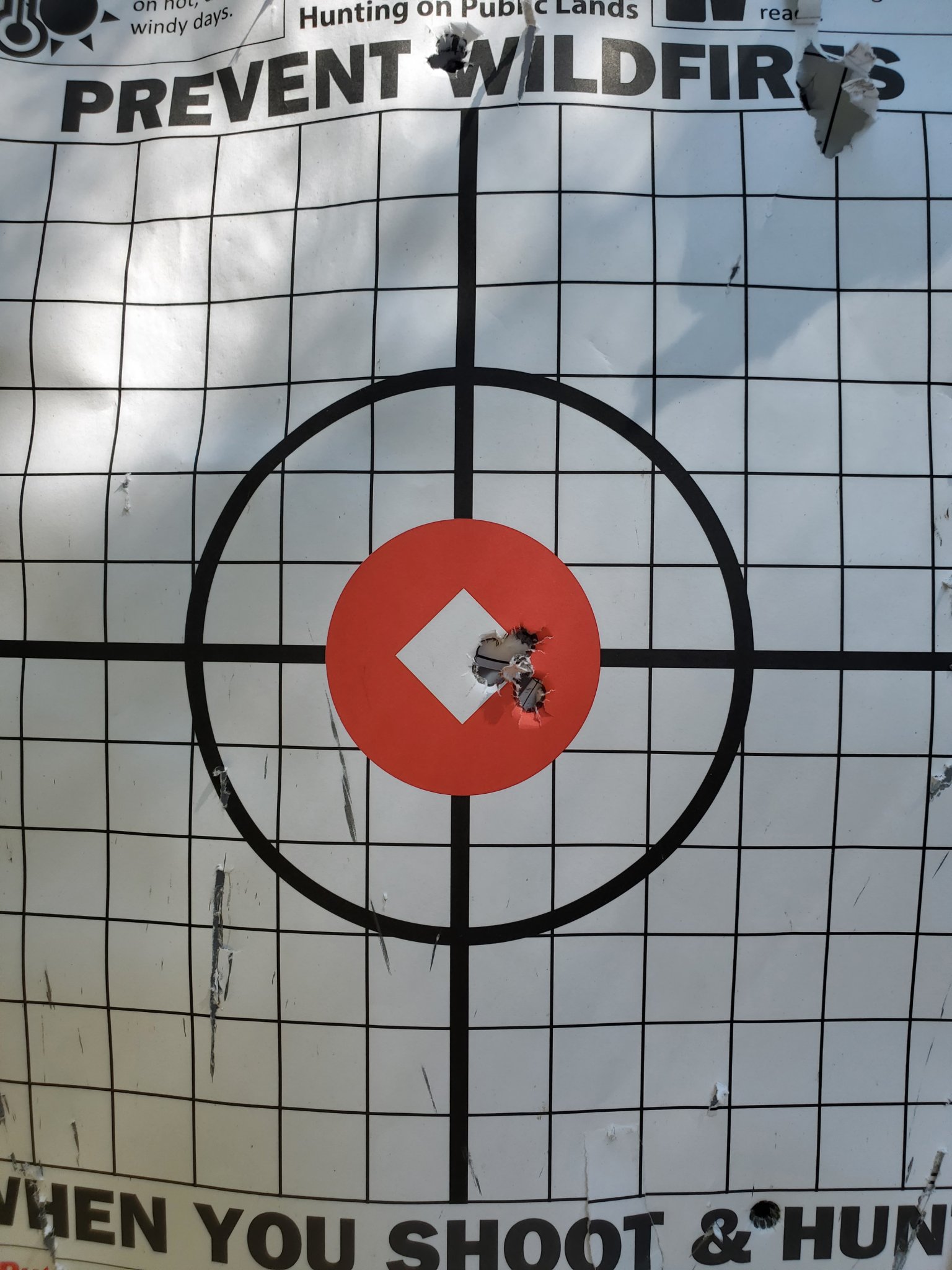

I'll play. I have two Armalite AR10's. One was my first, started as an Armalite 24" T upper with a Lothar barrel. Had it cut and crowned to 20". At the time I was in CA so I had to put it on an Aero Precision lower when they were building them on the same forgings that Armalite used. Only difference was the rollmark but it was CA legal. It has Armalite Match parts including the two stage trigger and oversize pins, EGW gas block, SWS E1 hand guard, Magpull trigger guard, Armalite BCG, rifle buffer and spring, Hogue grip and A2 stock. Optic is an older IOR 3-18x42 (probably some of the best glass I own)and I'm not sure what the riser is.
Last time I had it at the range, ten shots at 200 yds. FGMM.
This is my other AR10, more of a battle rifle. Another Armalite on an Aero Precision lower, this one started with a 16" Lothar SASS barrel mounted to an Armalite upper and BCG. The barrel got a glass bead job, Vortex flash hider, EGW gas block and BCM chargeing handle. It also has a SWS E1 carbine hand guard and a Hogue grip. Lower has a Geissele trigger, Magpul trigger guard, oversize match pins and Armalite carbine buffer and spring along with the Vltor IMOD stock. The optic is a USO 1.8-10 x 37 on a Bobro mount and (IIRC) Troy BUIS. Sling is a BFG. This rifle is every bit as accurate as the 20", both shoot .5-.6 moa with FGMM ammo.

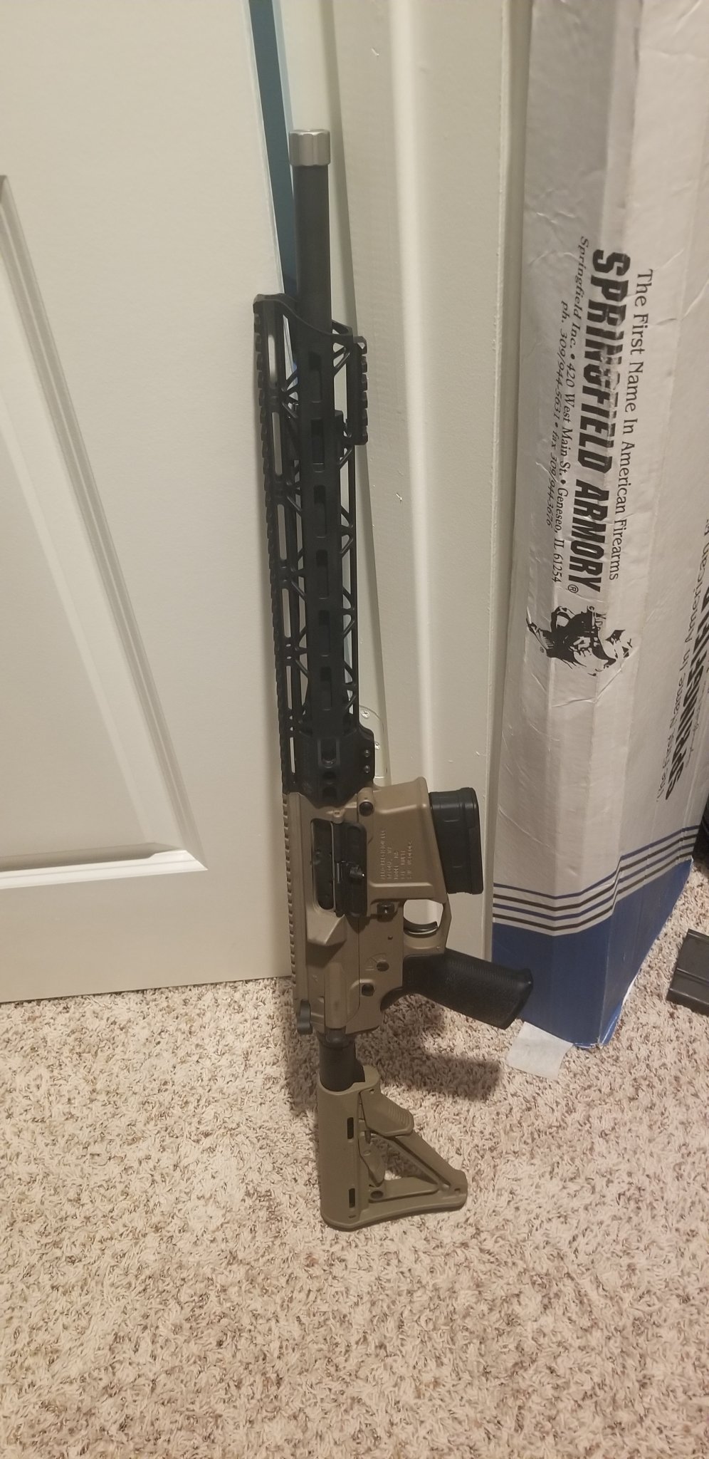

Here's mine, nothing special just a springfield saint 308 with a guessele high speed national match trigger with the light spring.
This is the first time I've bought a complete AR, All my others were piece together.

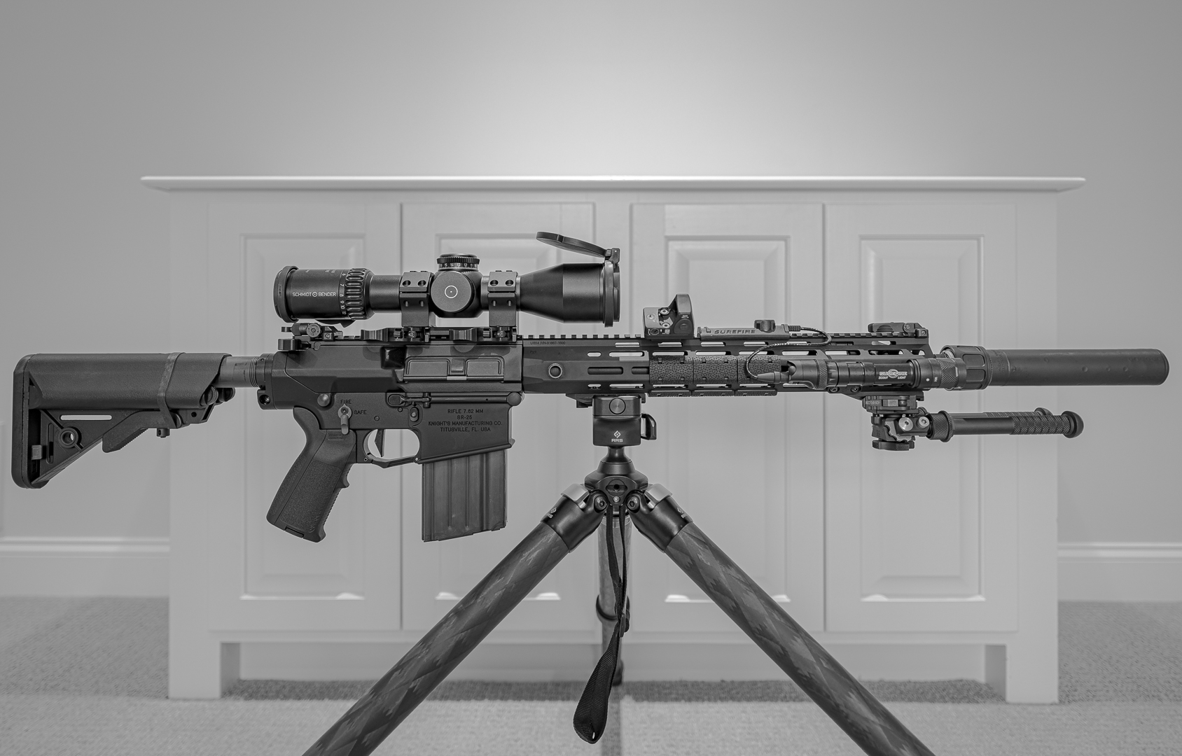

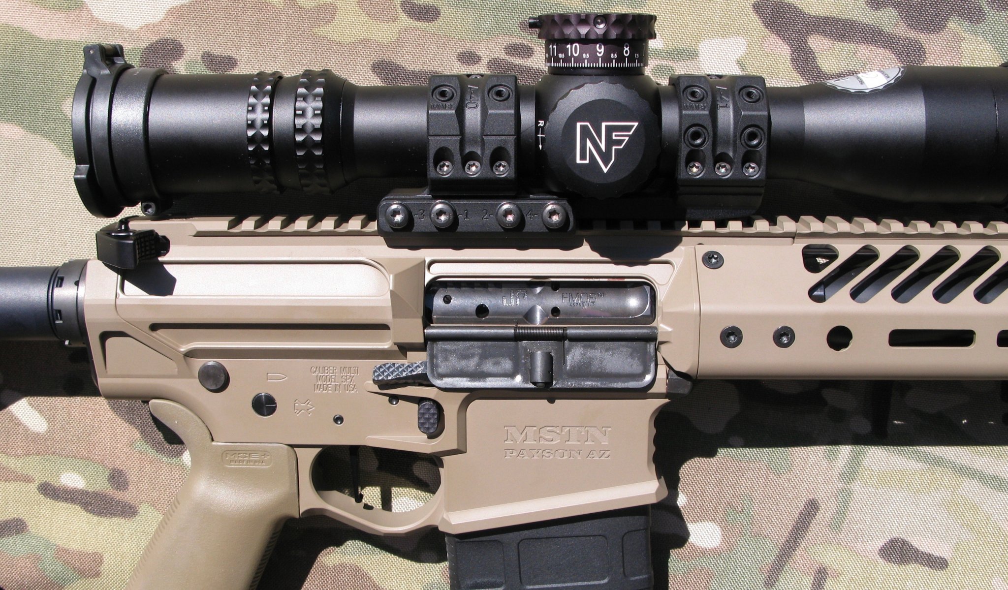

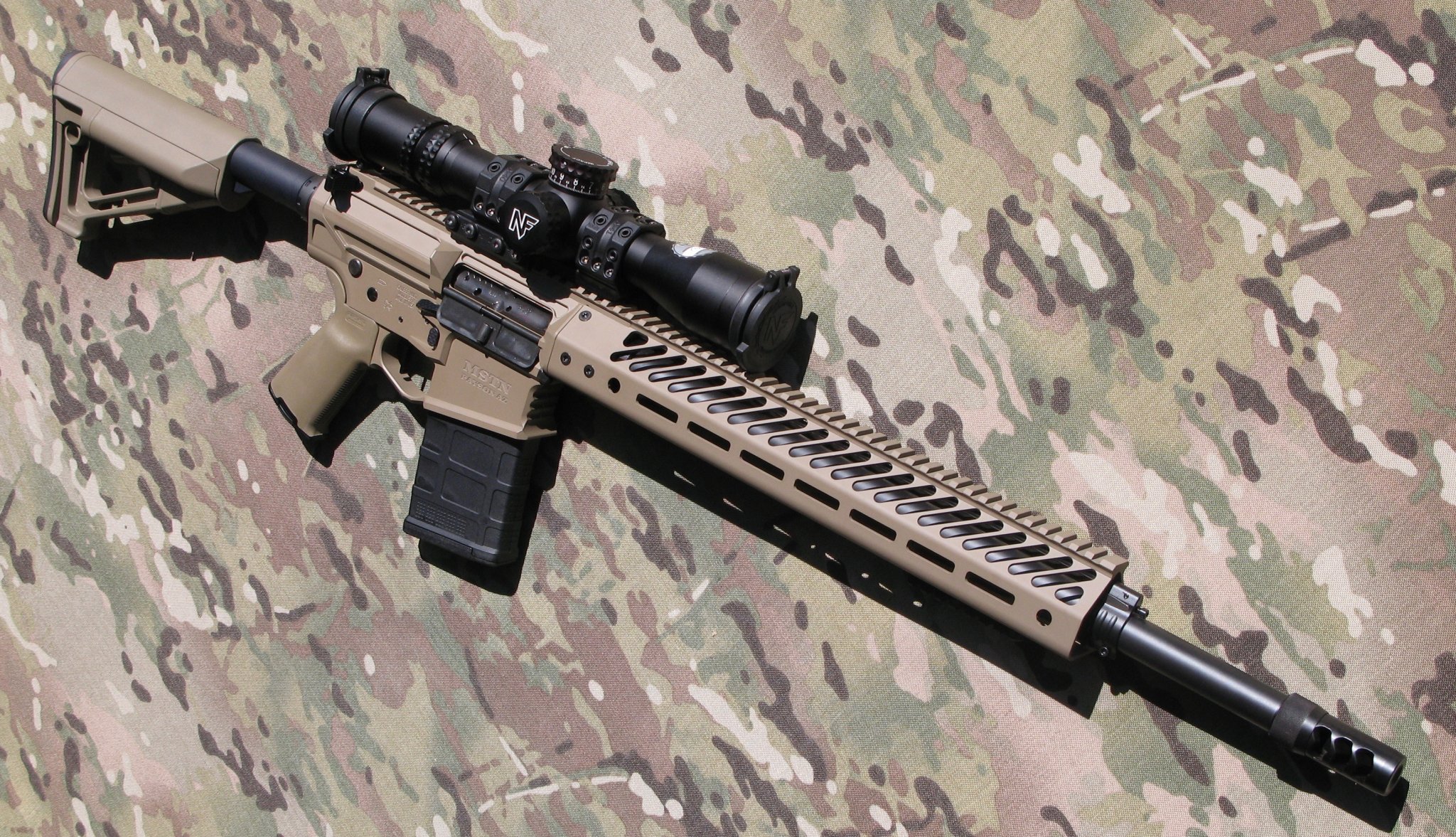

Built this up a while ago, just been to busy to post pics.
Was going for a MK11 build. Being in CA SR25s are banned by name, so had to go with an LMT lower.
Upper is a clone correct MK11. Lower is an LMT with LMT LPK, KAC buffer tube, spring, buffer, end plate, trigger is a KAC 2 stage and paint was done by my crafty AF wife lol.

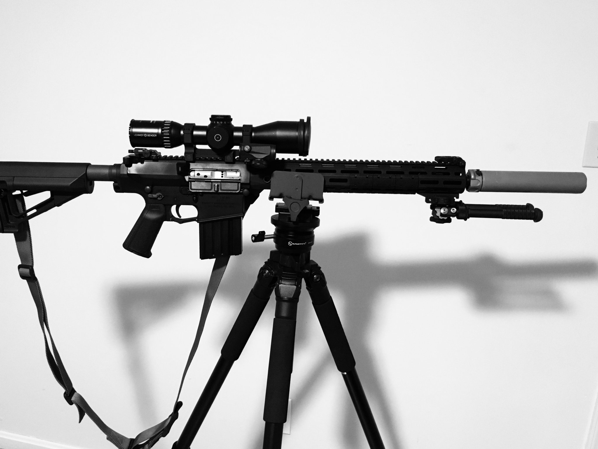

Finally got my M5 build with the new Craddock barrel shooting. The question is to paint or not to paint?
M5E1 receivers
Craddock Rrecision 20-inch Bartlein barrel
Geiselle SSA-E
VortexPST Gen II 5-25x EBR-7C
JP LMOS + JP SCS
Reloads are 178gr ELD-Ms with 40gr H4895 going 2,550 fps. Should have just enough steam to make it to 1,000 yards.

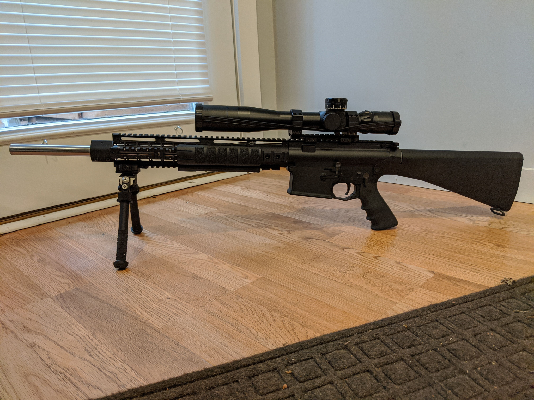

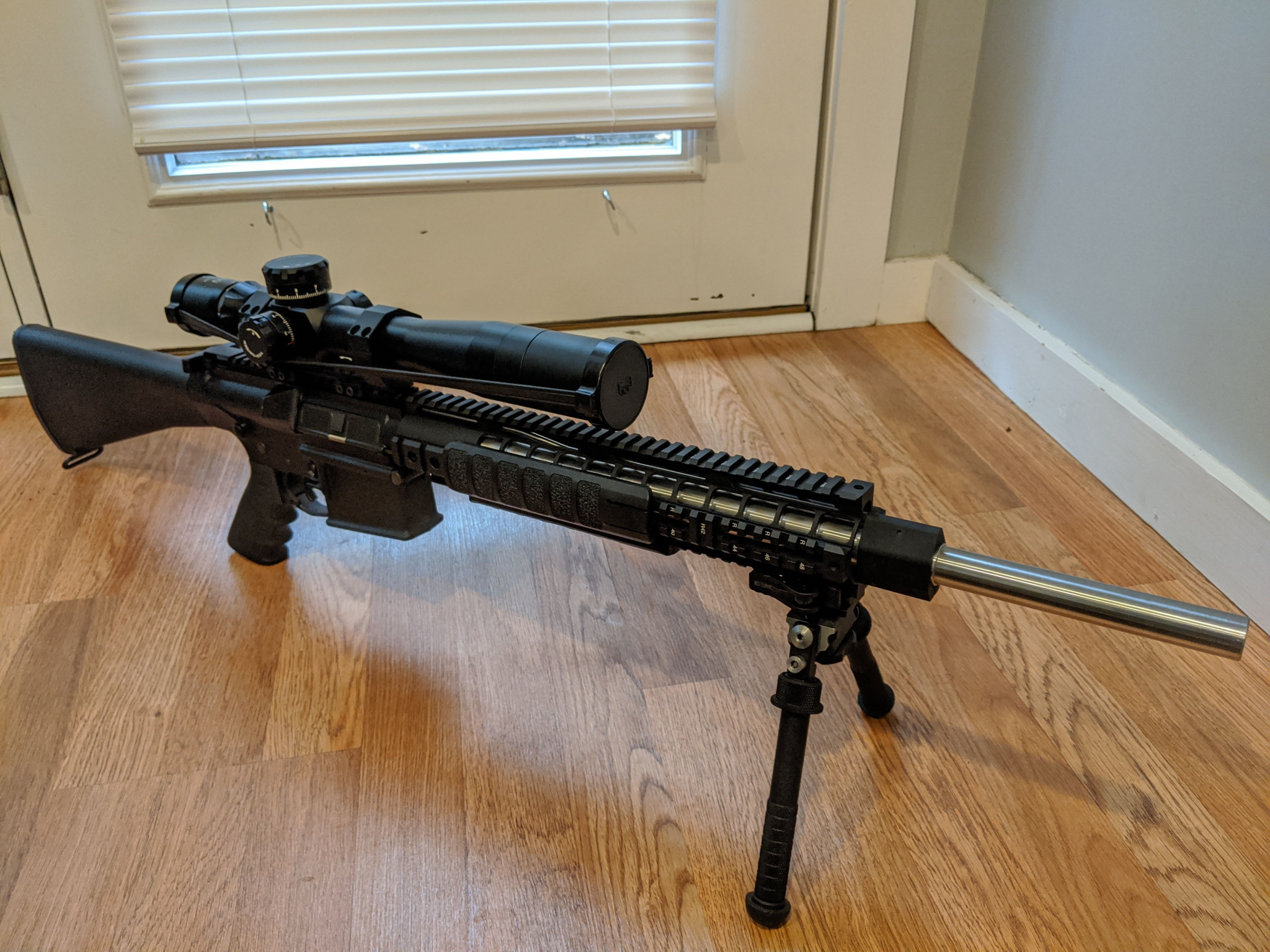

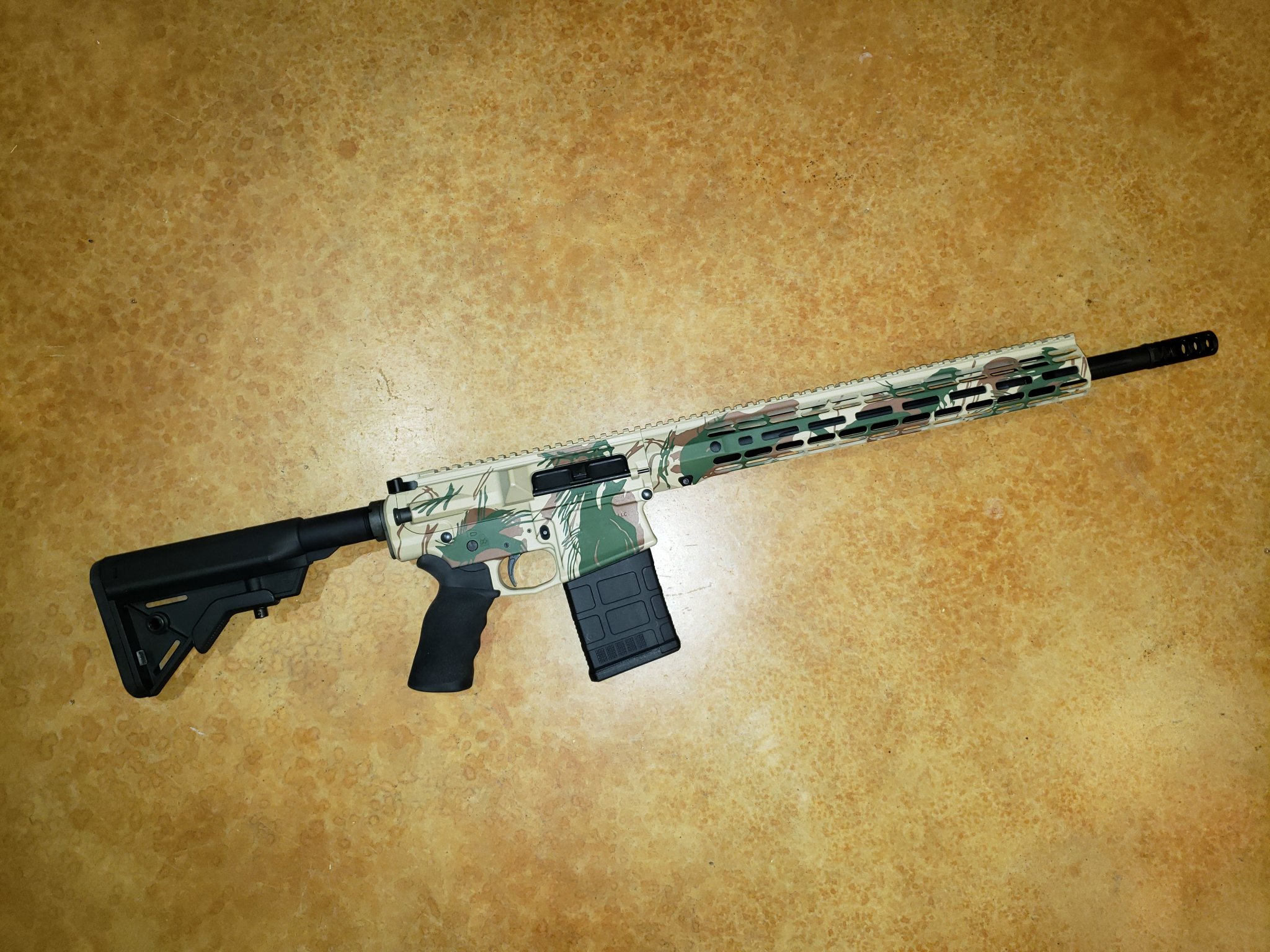

Here's my build. It came in at $1015 with 2 pmags and it was a few years ago. Also note that I spent a bit more because I did 80% and you could probably shave a few bucks there and minus irons and optics I have on the gun too. It's an absolute zero frills budget build when it comes to furniture however I put the money where I thought it counted (e.g. barrel, trigger.)
The Sportical upper was kind of a mistake since I wanted to have iron sights as well but if you had a piece of glass with a large objective I could appreciate why you'd want it.
Worth noting is that you have to do your homework if you build an LR308 or AR10 style gun. The parts aren't as universal as an AR15 even within the lines. There's something like 3 heights of LR308 uppers for instance.
If I was looking for a pre built gun I'd be looking at the M&P 10 or the PA10 6.5 Creed. With reloading I'd think either could break into the sub MOA range. If you haven't yet look at Elfster's series on the PA10 6.5 CM.

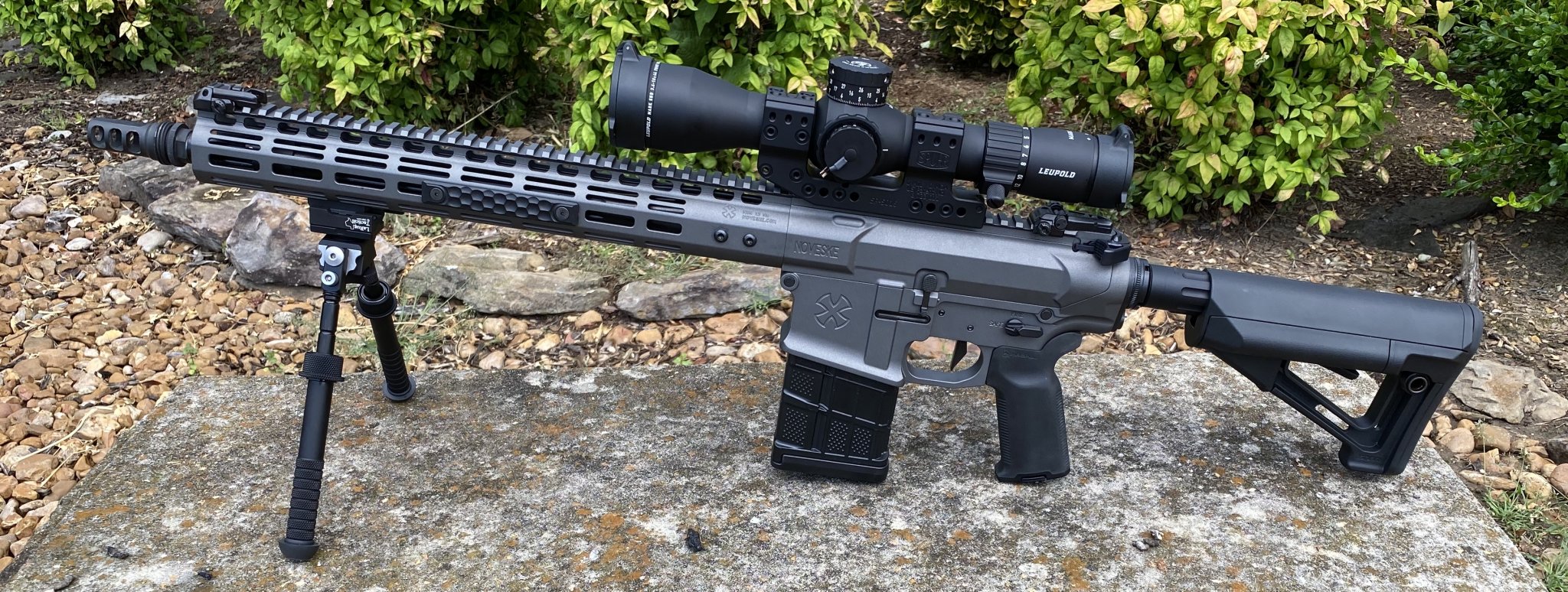

For those who are running a .308 AR in Service Rifle, what seems to be the most popular rifles in your experience?
Here's mine.
Specs:
SLR Builders set upper,lower and hand guard
SLR titanium adjustable gas block
Craddock Precision 16" dmr profile with rifle length gas system and fde cerakote on a criterion blank
Larue mbt2s trigger
Radian charging handle and safety
SLR ambi mag release
Griffin Armament titanium taper mount brake
Bcm furniture
Lantac nitride enhanced bcg

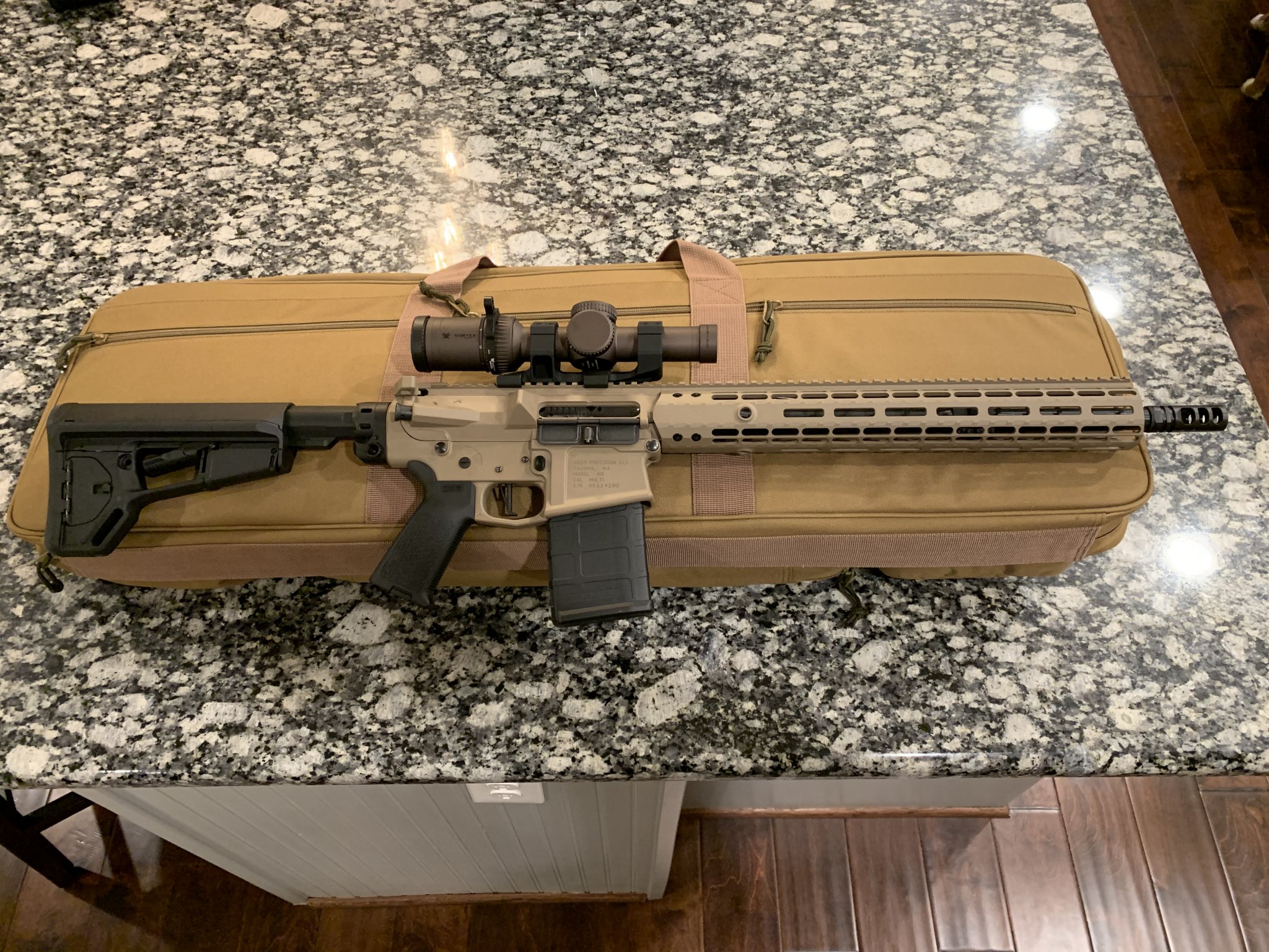

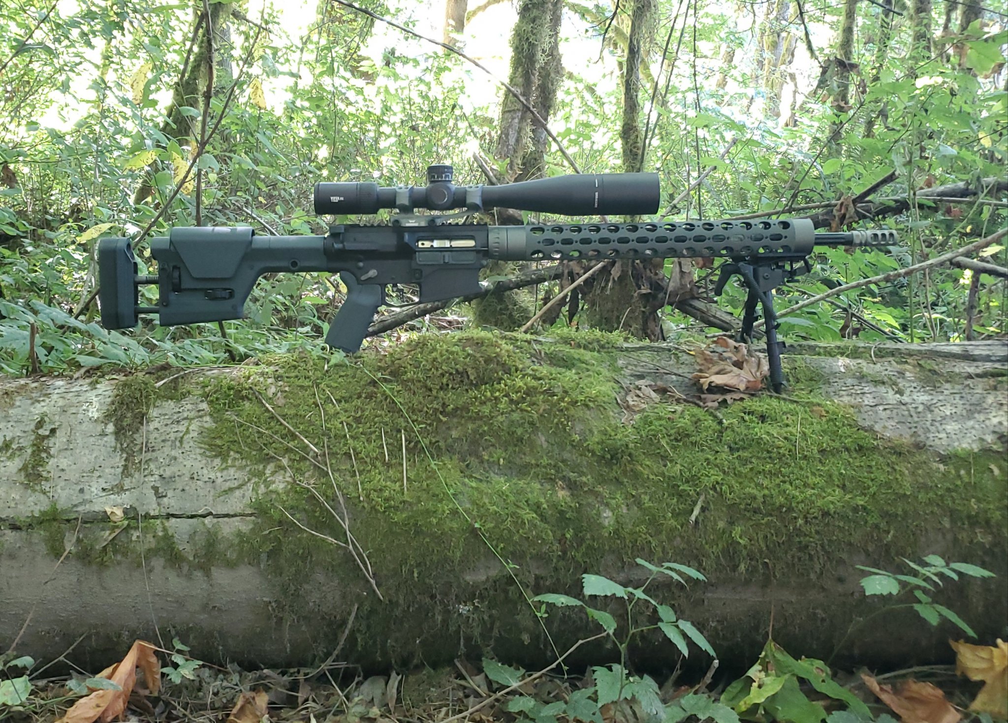

New pig rig in .308.
I've got some more Grendel testing to do, and with deer season on the horizon I'll be out a lot less at night...so it'll be probably after the first of the year before I get it on some hogs.
Its got about 30 rounds down the tube. No load development, just slapped some 150gr Hornady Interlock and Sierra Pro-Hunters over 45gr TAC to see if it was good enough...shot ~ 1.2 MOA with the Hornady and 1.4 with the Sierras (5 shots at 100 yds). For a thermal hunting rifle that's good enough...I'll play with the load development more when I use up the remaining 195 Hornady Interlocks.

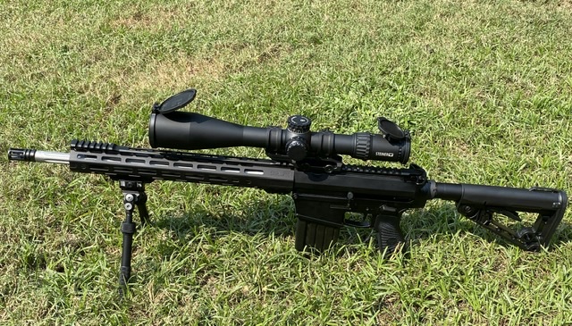

Just finished my build today:
Radical Firearms A2 flash hider
Wilson Combat 18" .308 match super sniper profile stainless steel fluted threaded barrel
Wilson Combat/SLR Rifleworks (really SLR) Sentry 8 adjustable gas block
Aero Precision melonite rifle length gas tube
SLR Rifleworks 15" ION ultra light mlok handguard
Aero Precision upper
Aero Precision nickel/boron BCG
Aero Precision enhanced buffer tube
JP Enterprises silent captured spring buffer
Aero Precision M5 lower parts kit
Geissele SSA-E trigger
Radian Raptor charging handle
Wilson Combat/BCM starburst gunfighter grip
Wilson Combat Rogers Super-stoc stock
Steiner T5Xi 5-25x56mm scope
Scalarworks LEAP standard height scope mount
Atlas BT46-LW17 PSR bipod
Can't wait to put some rounds through it!

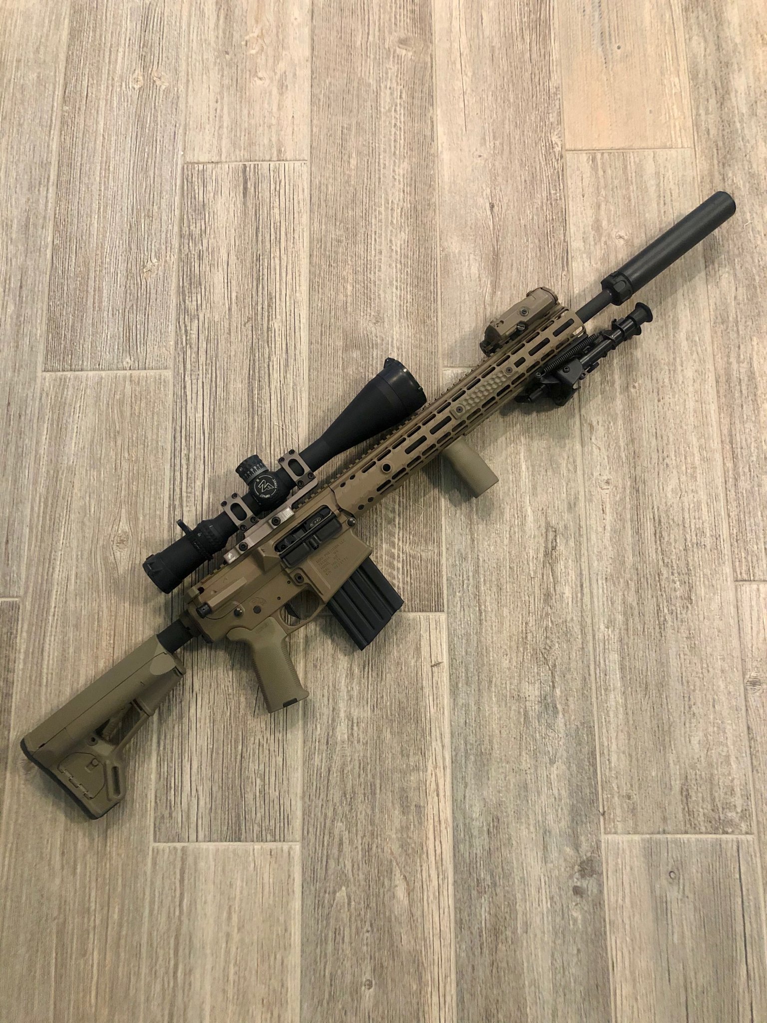

Not sure how I'm doing.

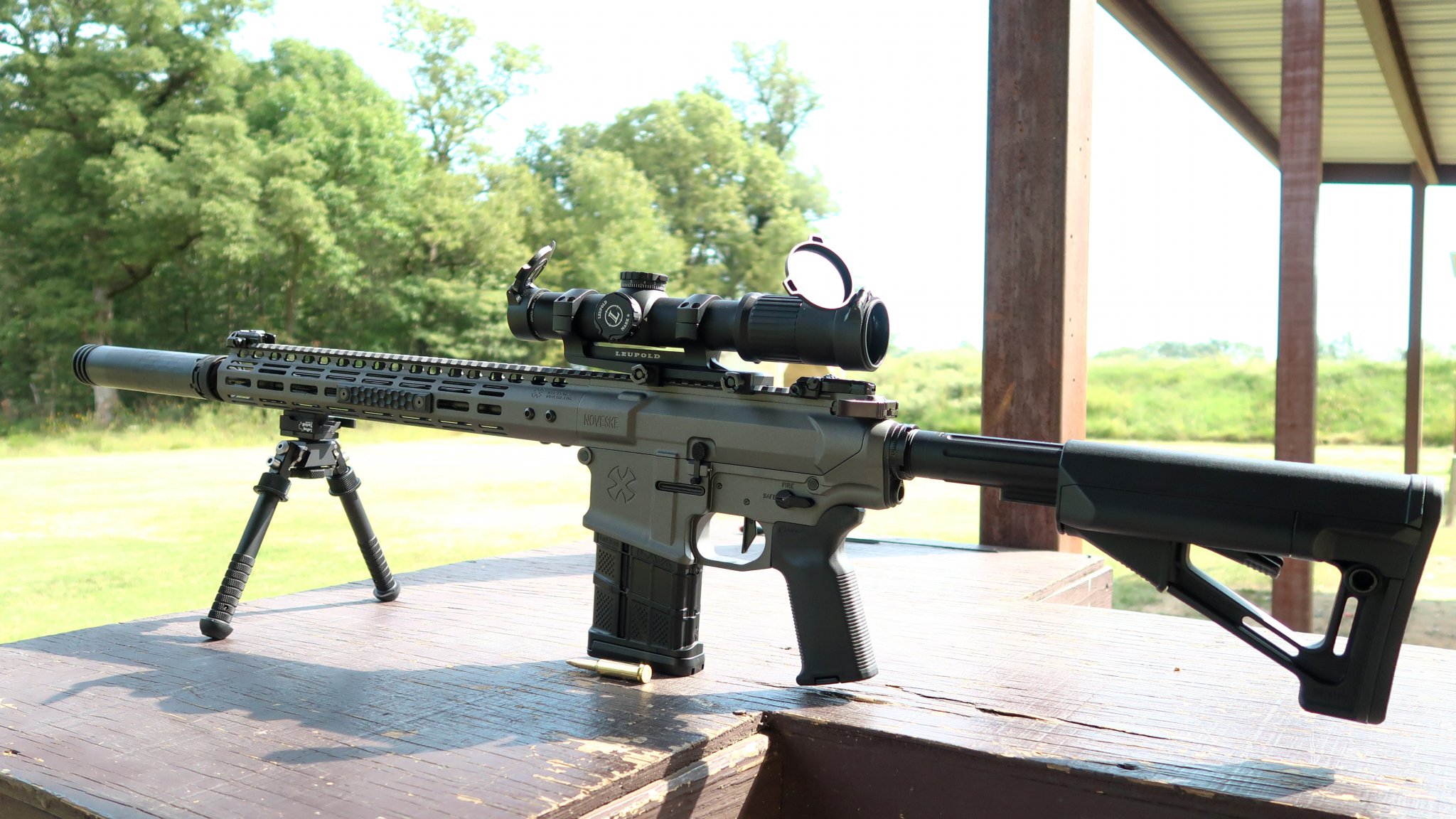

This is a JP PCS-12 born a 308 but now a 6,5 Creeeedmooore.
Conversion was HELL during COVID, and when you make silly mistakes and re-order takes half a year.
But now it shoots, thanks to a South African and a Swede.
Spuhr mount, Acro 2ndary, S&B 3-27, Ase Utra suppression.
Did some recent Cerakote to make the mount and Acro blend in.
