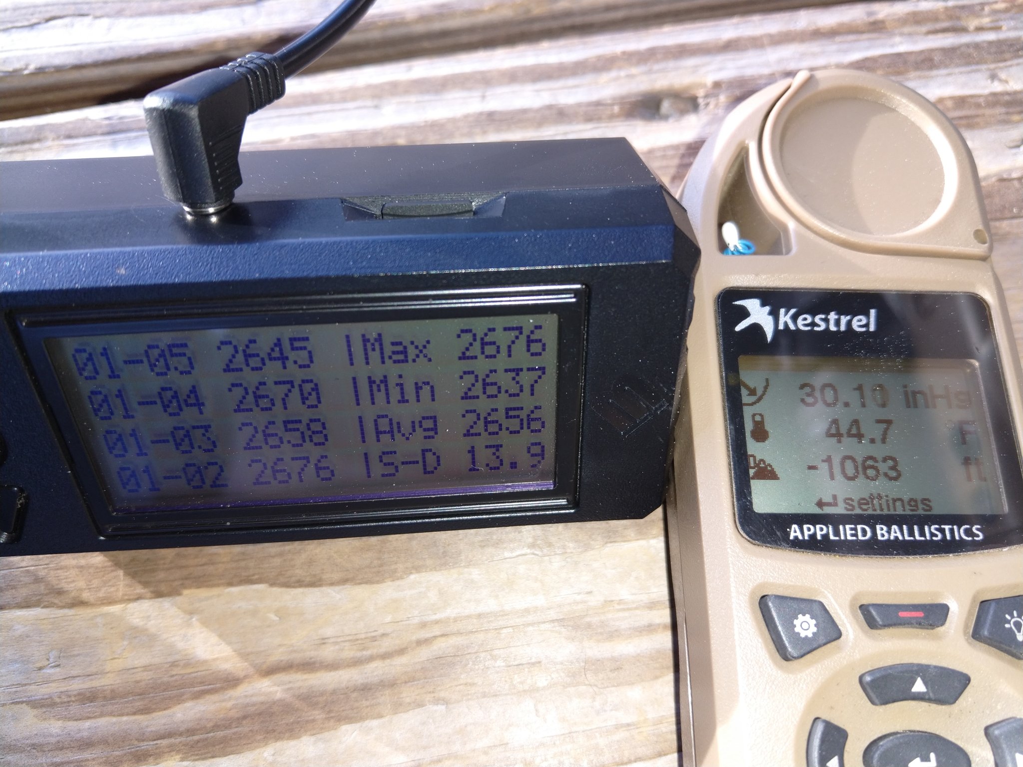

This load is just stupid. Had I not had someone with me I'd have had a hard time believing my own eyes.
So I just got back into reloading after a long hiatus (25 yrs) and decided my 1st load would be .308 Berger 168 hybrids. I used a Satterly speed test, came up with a speed node, then tried 5 different jumps, settling for .035. After not getting quite the speed I wanted, I bumped the load up .02 to the top of the speed node and went for a final test today. Speed was disappointing in that the SD and ES was just not good enough for me, and it didn't make sense given the care I put into making sure everything was gnats ass (previous speed test had a SD of 7 and ES of 26 I believe). So I tweaked my zero and said screw it I'm going for 1K yards to see what happens. Well, this is what happened...
First three shot group on a full size IPSC was barely bigger than a quarter and was like a ridiculous .121 moa. I literally had to drive down range because I didn't believe what I was seeing. I even thought that one lower stain was one of my shots but it wasn't... It had paint over it and was just someone elses poorly painted stain. So I decided to go to the two gongs to the right to confirm what I was seeing. The left gong is 12 in and the right gong is 10 in. Essentially the same result. The worst of those two groups was barely 3.5 in. I held center on the IPSC then left edge on the gongs. Those three groups were shot in succession. And I'm going to go buy a lottery ticket.
The only thing that makes sense on the speeds was that my ammo was stored indoors last night and it was 40° out this morning. I have a hunch that my ammo was rapidly cooling off sitting at the bench and it was doing so unevenly. The powder is win 748 which is known to be quite temp sensitive and I had evidence to support that from my previous test.
