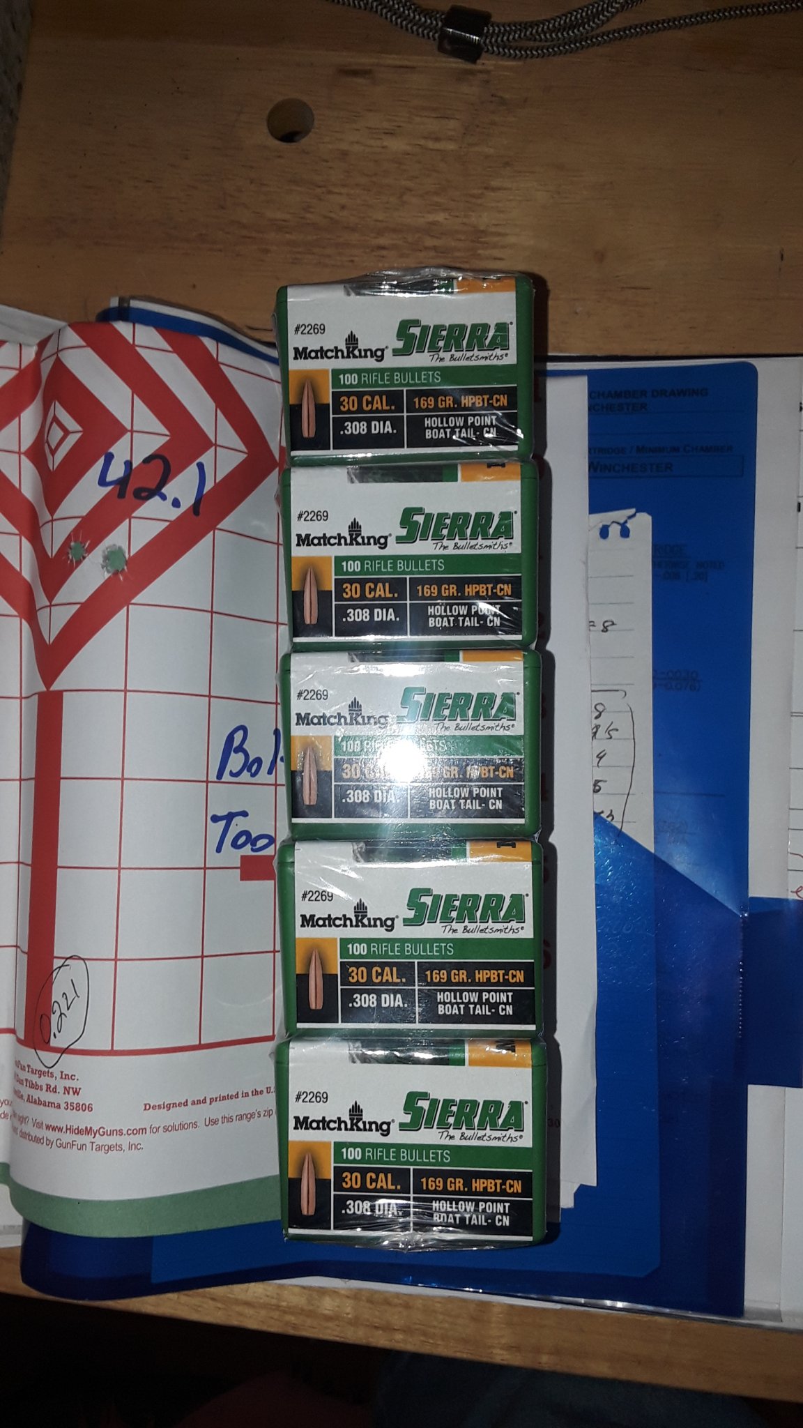

SMK are usually around. Its not like finding varget (F*** Varget!). Midsouth has them right now.
I do wonder about some of you fellas and those super-heavy bullets. has anyone thrown them in a BC to see their benefits? I suspect lowlight is gonna be along to smack us all and tell us lighter and faster. 185 is about my limit before I need to pull out a magnum.
I used to really shoot a lot of the 155s. I switched to the 175 SMK and I'm just about out, and thinking about switching back again. Of course there are none available anywhere!
You might want to check out the 169 SMK's??? They've got a higher BC than the 175's at .527 and also they're also a longer bullet than the 175's. These 169 SMK's have been work very well for me with the same powder I use for the 168's and 175's. Many places have the 169's available and at a lower cost the either the 168's or 175's (why, I dunno . . . but these days I'm not going to argue for getting them under $200).
I'll have to run some ballistic calculator information to figure out if these will be superior to the 155s. How are they in terms of seating depth sensitivity for you?
Reactions: NLS7162
So far, in my experience I can see no difference from either the 168's or 175's. The 169's look to be like a hybrid ogive and definitely more forgiving than a secant ogive.
With the velocities I'm getting my ballistic calculator show it being stable out past 1200 yds. from the 1:10 Krieger 26" barrel.
I ran some numbers and while the new 169 is superior to the old school SMKs, the 155 is significantly superior to the new 169 in terms of performance, even if you assume as Brian Litz has shown that the 155 TMK has the same BC as the 155 (new) Palma bullet.
By "significantly," it's not quite 10%, but it's not trivial. If I could get a 500 pack of the 169s, I may give them a try. Bummed that they designed an entirely new bullet that doesn't actually perform better than one they already had, however.
Plenty of 500 packs at Blue Collar Reloading: https://www.bluecollarreloading.com...ierra-30cal-169gr-hpbt?variant=39250057494626
I have been using essentially the same methodology Litz demonstrates in AB to compare bullets for a while. I had originally purchased these for a .30-06 when I couldn't find 208 ELD-M, thus why they're lying around.
With a "normal" rifle, there's the concern that COL eats your powder volume and you lose relative performance. I fully acknowledge that. However, if they "work" in your chamber and magazine setup, it comes down to what problem you're trying to solve. I would invite your attention to this article: https://rifleshooter.com/2016/11/si...k-load-development-308-winchester-and-varget/
While the comparison in that article clearly omits a number of very good projectiles, it does highlight the advantage of a more aerodynamic bullet at range.

Just ordered 500 of the new 169g smk's.
I think they should work well in my sons (mag lenght) 20 inch gun.
Trick will be to get more varget that evidently is the best in his 20 inch that we have had.

Everything I shoot is out of a magazine. It might be a long magazine, but it's out of a magazine. I haven't tried 185s or anything like that because my 12 twist won't stabilize them anyway. Certainly for F class type shooting, you're going to want to get all you can out of the cartridge. But there is nothing unconventional needed to make a .308 shoot at 1000 other than bullets with a G1 BC over .500.
My precious.
