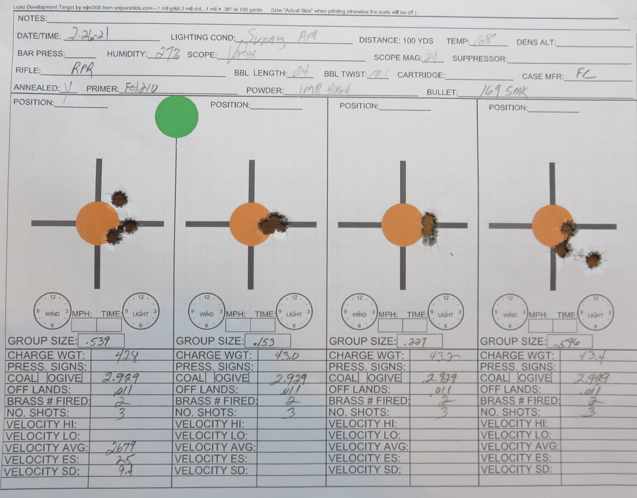

Training for PRS, I’m attempting to reduce the barrel wear on the 6GTs. Open to anything, I’ve got plenty of SMKs. I have mixed feeling on the 168gr when shooting past 700.
The 168 SMK, yes but not other 168s. The 168 SMK is the bullet that gave all the other 168s a bad name. I use a 168 ELD-M in my Tac .308 and at 2750fps it hammers at 1250 yards. Those 169s will do it too. I wouldn't use either the 155 or 175 SMKs unlesss you had a bunch to burn up which you do. Use them for practice but use the 169s for matches if you shoot it in Tac for some fun.
Reactions: straightshooter1
I have a couple thousand of the 169s, I got bored waiting for the barrel to be spun up. I will give them a try. The "JAM" point of the barrel is at 2.9016", tomorrow I am going to break it in and then do some testing.
This is why I publish my COAL's instead of jumps. If, like so many people do, I had only said my jump is .011", that wouldn't work in your chamber and you'd have no idea how my cartridge configurate might fit in you chamber.
Good luck with those 169's. You should find them easy enough to develop a load. In fact, I found they're not far off from my 168 SMK loads.
I spent the weekend with some CFE 223 and the 168 HOR ELD Match, averaged .577" (group size-OD of bullet) in light winds was the best. I tried stepping the loads up gradually in velocity nodes of 50 fps. The barrel shot the slower version the best and with more jump than getting closer to the rifling. The FED Gold Match 175gr shot a decent .48" in the factory configuration. Off to IMR 4064, target, with some 148gr, 155gr, 178gr, and 169gr. Still looking for the 215grs. Thanks guys!
Reactions: bubbaokie
Any recommendations for reloading?

Alright fellas. First time posting in the reloading section. Trying to figure out a good charge weight to start with.
R700 .308, 18” to the SiCo ASR brake. 1:10 twist. The thing shoots FGMM 175gr SMK factory loads very well. .5-.75” depending on how well the user performs…
2lbs of Varget just got delivered. 180gr Berger Elite Hunters are in the mail. Going to finish setting up the bench and get my hands on some primers as soon as I can.
Thoughts? Was thinking I would start with 39gr as my median and work up and down .5gr.

Tough crowd. After looking at a couple more reloading manuals I’ll probably start at 40 or 41gr of Varget.
Are you familiar with the OCW method of load development? If not, here's a link to the site that explains it. It's a pretty good method of zeroing in (no pun intended) on a good charge weight for a given bullet/powder/brass/primer combo.
Optimal Charge Weight Info
Negative. But… I’m going to check it out now! Thanks! Appreciate the link.

On that note and the above mentioned OCW......The only load recipe that I have found to be a better shooter than I in my M1A is, indeed, 41.5gr of IMR-4895 pushing 168 Sierra MatchKings seated at magazine length. Sub minute rifle all day long! 💥 There's something about that combination and the rifles metalurgic tendencies where it just works. And I first read that recipe in an M1A reloading article!! Granted, there will be some discrepancy given between brass variances and thicknesses, but thats a hair I don't bother spliting.
As an engineer, there is something magical when it comes to load development that I love!
