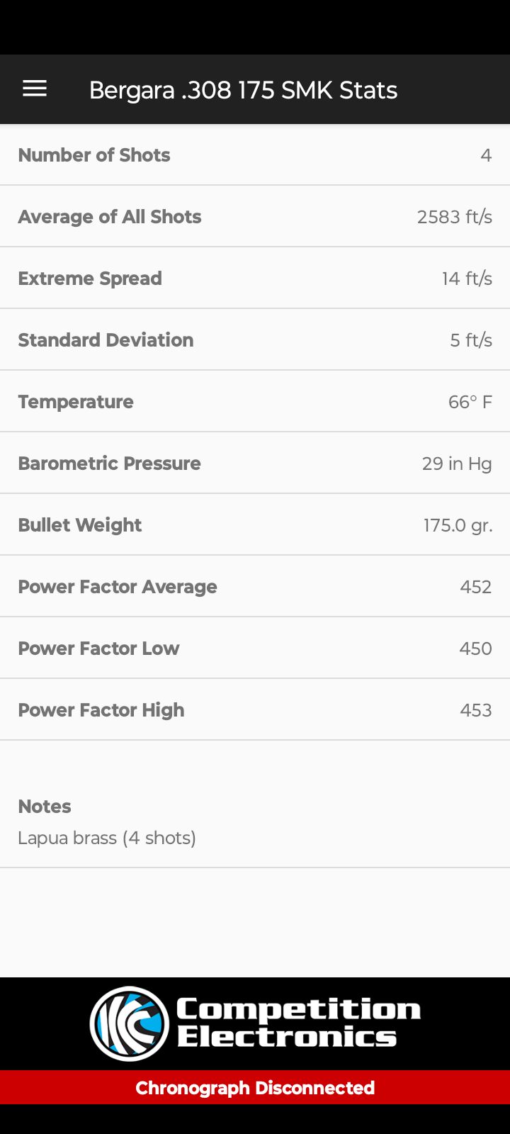

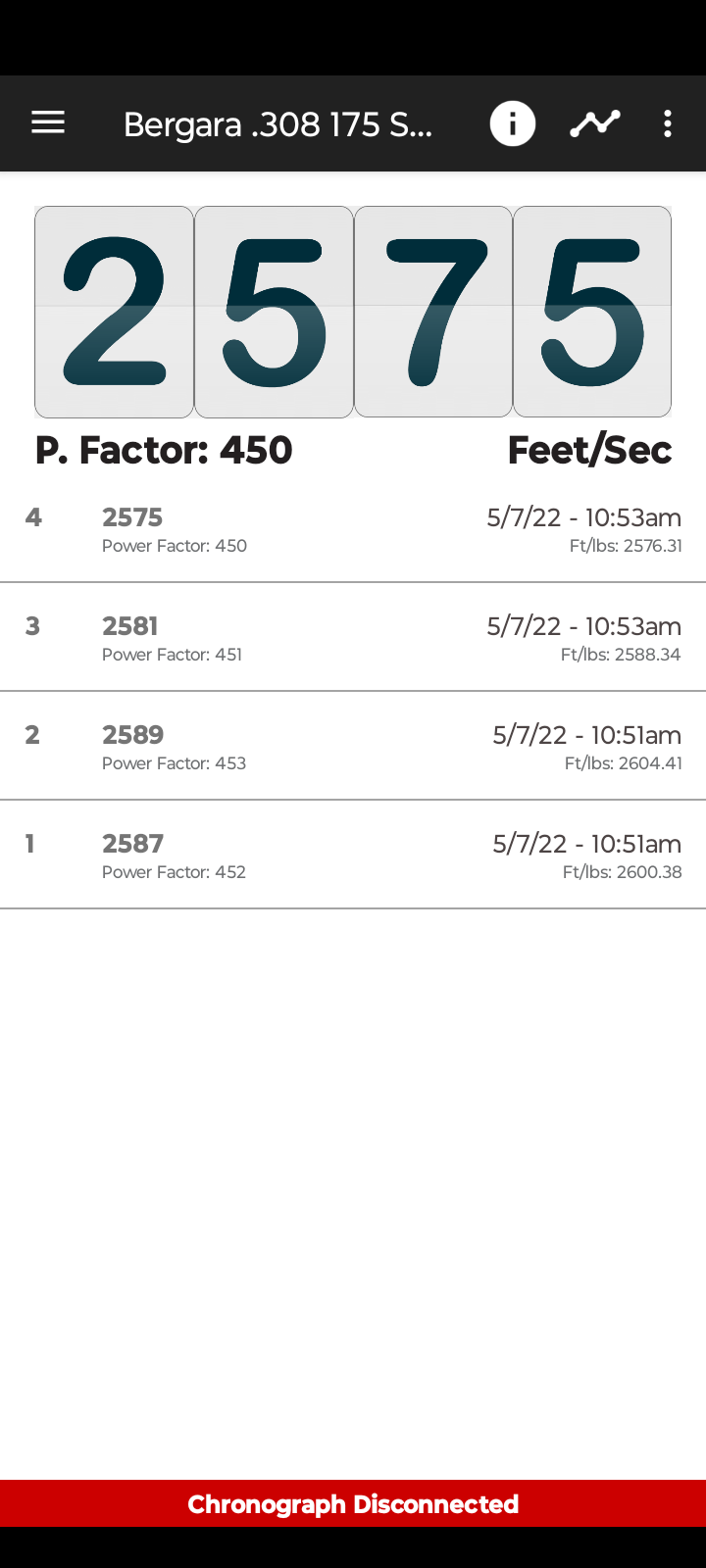

Reactions: Alaska

Love the Bergara Ridge 22” with its No 5 weight barrel……..extremely accurate with 168gr MK and 45.0 of Varget in WW cases with BR2 primers. Love that factory trigger ! And 1-10 twist
Note it says 22” but it measures closer to 21” without brake.
