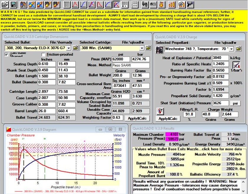

Thanks. I think R.STOCKFISCH might find that info helpful. And here's some more info for him and you that might be found helpful:
View attachment 8065639 View attachment 8065640
Man that is awesome. Thank you for all of that info. I appreciate it.
Still interested in knowing what the reasoning is behind loading the 200 ELD X in the 308 ?
Is it trying to use the .597 G-1 BC ?

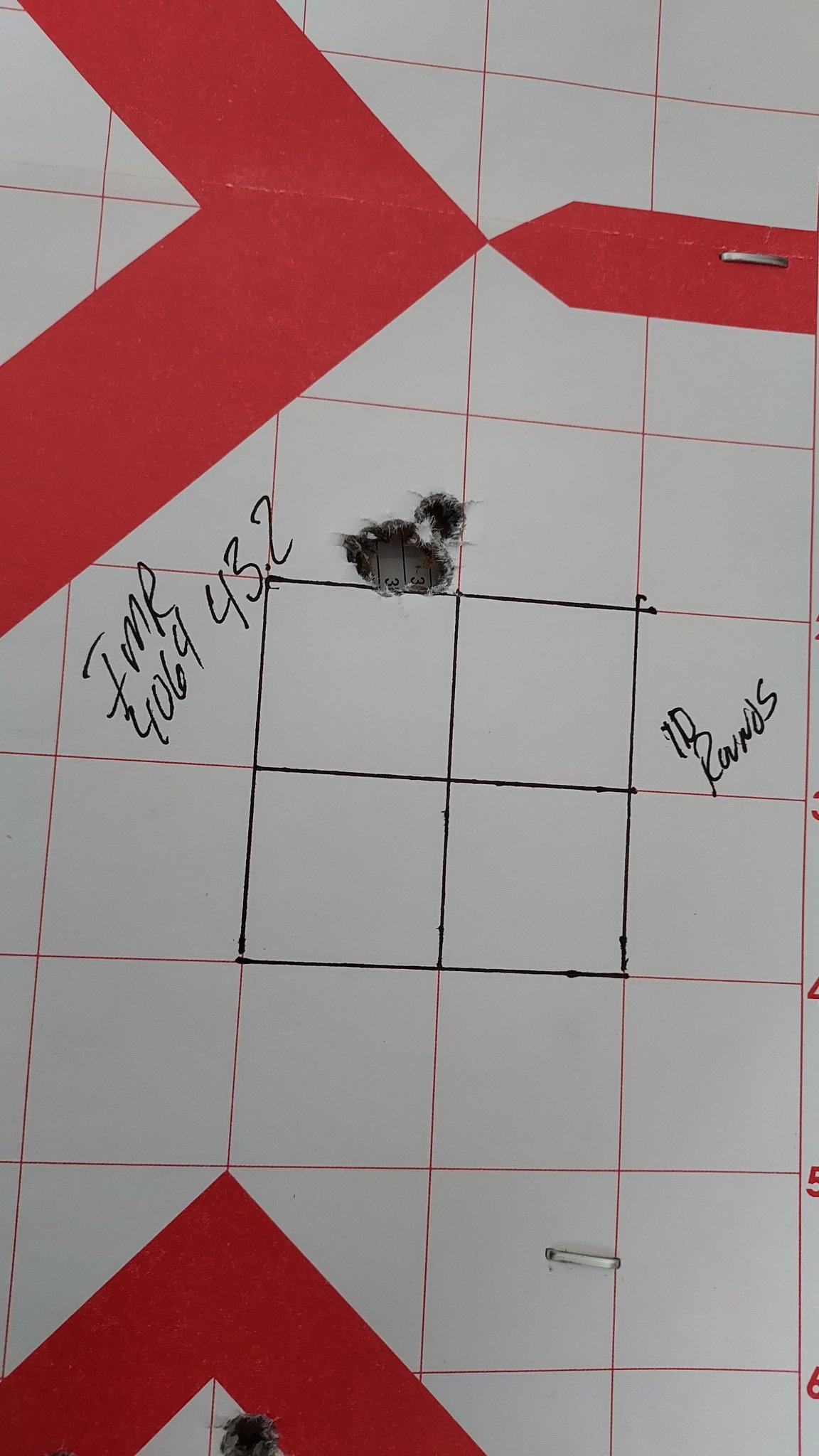

42.5 4064 20" 1/10 Rem AAC/SD Heavy 175 SMK Hornady Brass CCI BR2 2440 FPS.

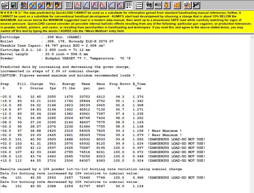

According to Quickload, 42.5, 175 SMK from a 20" barrel would be a little over 2500 fps. I've found Quickload to be very close to actual velocities.
Data that I have from 43.0/4064 shows 2626 from a 26" barrel, 20" barrel would be about 100 fps less, so that would be right in the ballpark for 2500+.

Pretty doggone close... 42.5 gr of IMR 4064 in Lapua brass with CCI BR2 primers @ 2.800" will push a 175 SMK about 2550 fps from the 20" barrel on my wife's .308
4064 isn't too bad about temperature, but it will swing a little from that velocity depending on how hot/cold it is outside.

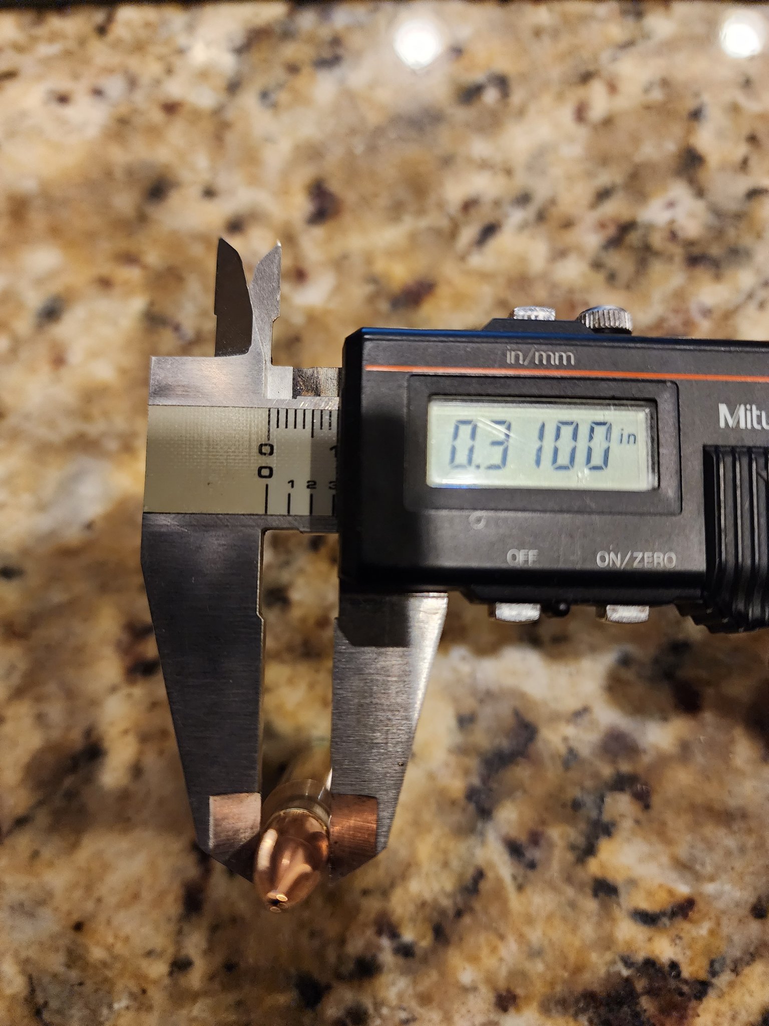

Had round were the bolt would not close so I set aside for inspection later.
Got home and it measured .310" OD, so the neck was thicker by the corresponding amount.

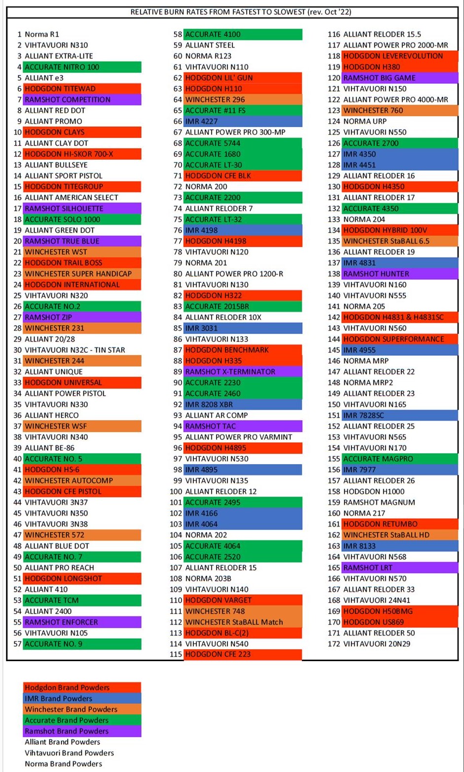

Now , back to 308 reloading , has anyone tried VVN N 550 in a 308 with 168 / 175 gn. bullets ? I'm thinking it as a replacement / alternative to Varget
The numbers don't suggest that N550 is an "alternative" to Varget any more than any other powder suitable for a .308. N550's burn temperature is close to the same, but it's a much slower burning powder. For N550 to get the same velocity as Varget, you need about 10% more of it. And I don't think it's as temperature stable as Varget. Otherwise, I don't see why it can't be used in a .308 cartridge for those bullets.
