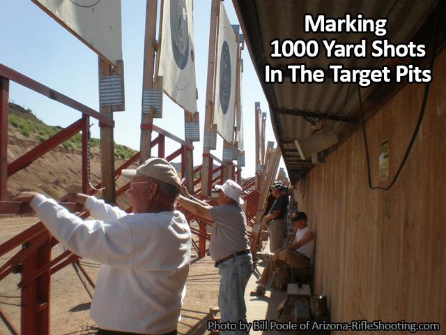

I’m at 2 long ranges here in TN and no one is allowed past the benches when line is hot.
Come shoot a match at ORSA (Oak Ridge). Learn what life in the pits is all about. :cool:
Seriously though, second weekend of every month, March through November, two days, 1,000 yard matches. It's fun and you will meet a lot of really good people and excellent shooters.

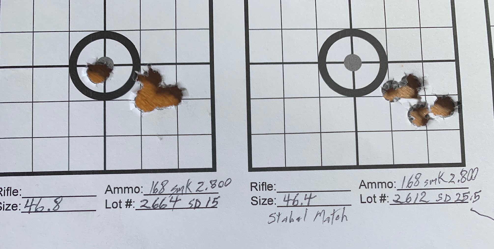

I ran a pressure test ladder last weekend With the Staball Match in an 18" AR 11T Proof.
For comparison on the same range trip I first ran x 5 FGMM 168 across the Chrono
FGMM 168 x 5 = 2516 SD 9.3
All Staball match loads in Black hills brass with head stamps of 7.62 & 308 Match, cci #34 primers, 168 smk seated 2.800
45.6 = 2582 SD 7.8
46.0 = 2599 SD 20.4
46.4 = 2612 SD 25.5
46.8 = 2664 SD 15
The 46.0 & 46.4 had mixed head stamps & it shows on SD's. 46.8 is book max per Hodgdon.
Primers were flat with some cratering all the way through the ladder. Oddly it didn't get any worse with the upper end loads, but based on speed I'll be re shooting 45.2 - 46.0
If you want to try heavies stay well south of 45.0! I tried 45.6 with 176 A-tips @ 2.875 based on Hodgdon's data & blew a few primers. They list 46.0 max for 175smk @2.800. From what I've seen their 308 data is not at all on the conservative side at least not in an AR.
Accuracy showed promise as well.

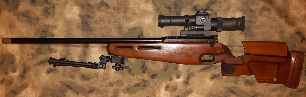

By chance, quite fortunately I recently bought a Russian Izhmash Record-1-308 rifle in .308 Win caliber. This is my first encounter with that caliber. Factory ammo is quite expensive ( I live in Europe, EU, Poland ), after shooting I am left with a factory shells, so I thought that I might try to use them and reload .308 for my rifle. Because the scale of reloading was to be rather small – after a net study and watched several YouTube videos on reloading ( I know now, it is not enough, and with a such tiny background I should not take that step – but it is too late ) – I bought a Lee Loader, thinking that it would be an inexpensive way to get a cheaper ammo.

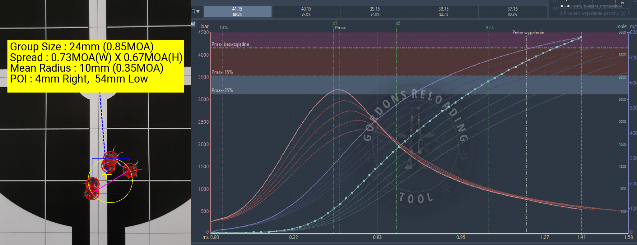

Parameters: bullet : Hornady ELD-M 178gr, powder Lovex 73.6 - an equivalent let's say of Accurate 2520 - load : 41,15 gr, COAL : 72 mm = 2,83 inch. Shooting distance : 100 m, rifle rested on bipod, optics : PS-07 - magnification x7
GRT software data for my "load": pressure : 3200 bar, muzzle velocity : 778 m/s, energy : 3495 J.
The rifle : Izhmash Record-1-308, cal. 308 Win, barrel : 650 mm, barrel twist 320 mm.

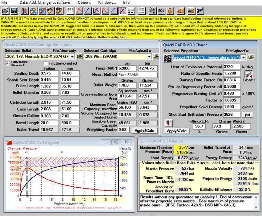

As you've probably seen on YouTube, you'll need to charge your cases with various loads in increments. . . like at .3 grs apart (for this sizes of cartridge) covering about 8 different loads. Then, on a target with a grid with dots for each load along a horizontal line so you can best distinguish variations in POI's relationship to the line, shoot 3 shot groups on each dot as a POA. Not only can the size of the group help you determine which load it best, but the POI relationship to the horizontal line and the shape of the groups will help you in determining which load works best out of your gun. How far you can go with adding more powder is such a test will be when you start seeing and feeling pressure signs (e.g. hard bolt lift, stiff ejection, ejector swipe, cratered primers). If start having these pressure signs, though you're not done with all that you've loaded for your test, STOP! You don't want to go any further.

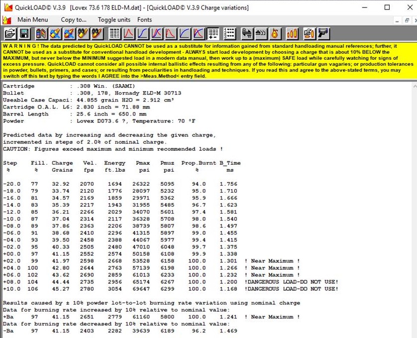

Based on your data you've shared, I've done a rough calculation using QuickLoad (similar to the GTR you used), which I've used for a long time to help me with my load development. So, it looks to me like you can start with the load you have at 41.5 grs and do increments upwards from there (like 41.3, 41.6, 41.9, 42.2, 42.5, 42,8, 43.1.).
Note that I've based this on a case capacity of 55.5 gr H2O. More accurate calculation can be made (including with your GTR app) if one has measured the case volume of you're particular cartridges (need to measure at least 10 to get a good average to use). Also, you didn't state a temperature, which effects the calculations, so I just used 70°F.
Looking at your group, it looks surprisingly good considering your first loading and your rig's set up.
Getting the right powder load is not the only thing that can help to make groups tighter. Some will have to do with the details in your case preparation. Then there are other things too, like a more powerful scope (important if you just target shooting. . . as in, "aim small, hit small"). When doing load development, it's important to have a good front and rear rest. The smaller you want to get the less a bipod will help. And since trigger pull is also so very important when trying to get very tight groups, having a trigger that's adjusted to a light pull also helps a lot.
So, all of these things work together and should be addressed within the scope of your shooting goals.
Here's my QuickLoad calculations base on the data you've provided:

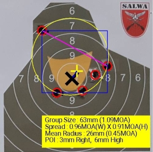

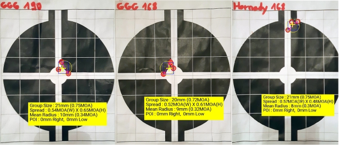

Thank you very much for the reply. With a factory ammo I got 0,72 – 0,75 MOA groups at 100m but only of 3 shots.
With that rifle - Record-1-308 and 100m distance normal result should be about 0,55-0,6 MOA. That's why I thought that with a "hand made" ammo I would be able to reach such result – that was an example of a wishful thinking. Human factor ( me and my shooting skills, not very high ) is also influencing the result. Rifle did its job - it was me who spoiled. After first try I got 0,85 MOA so was a little bit disappointed but now when I see it, I have to say that I was quite lucky, taking into account my very limited knowledge of reloading ( you've mentioned even a temperature - I did not think about temperature and its influence on the result ).
With a help of GRT software I wanted to stay on a very safe side of Pmax-25% pressure, that was the reason for 41,15 gr powder load - chosen on the basis of GRT calculation. Work with a Lee Loader and a hammer is time consuming and let's say not very pleasant, so now I’m thinking about a single stage press. Especially if 8 different loads should be prepared and tested.
If I understand you correctly the direction for development of my “load” is to increase the amount of powder, starting from the already tested 41,15 gr. I’ve got some empty brass from factory ammo fired from my Record-1 so I’ll try use them.

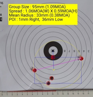

With a factory ammo I got 1,09 MOA at 200m ( 5-shots group ) and same 1,09 MOA at 300m ( 5-shots group ). I’d like to get a sub-MOA groups – perhaps my own “load” will help me get that result.
200 m
300m

Yes, I would say that getting a single stage press would be the best way for you to reach your goal and give you more control over how you load each cartridge.
Though I have no idea what seating dies you might have available to purchase, I'd recomend getting an arbor press and a seating die like this Wilson seating die. It'll give you more control over how uniform you can seat your bullets, which helps lot towards smaller groups and you can take it to a firing range to adjust seating depths when you get to the point of fine tuning your load.
You don't necessarily have to use your 41.15 grs as a starting point. You can use 8 steps below that or you can have the 41.15 in the middle of a set . . . the latter seems more appropriate based on what you've said here. Having it in the middle, you can see again if you might get a similar results, or maybe even better since any 5 shot group needs to be verified.

Base to begin with for Tikka T3X CTR .308 WIN 20" factory barrel
RWS brass, fully sized, trimmed to 51.00mm / 2.008"
CCI Primer
VV N140 39.9grains
Hornady ELD-X 178grains
COAL 71.50mm / 2.815"
Repeatable result 10 shot group from bipod, No rear bag @100m / about 100yards.
More finetuning could improve the results.
V0 not yet measured.
Tobias
It will be on the slow side, but it shoots great.
Another sweetspot seems to be 40.4 grain N140 under either a 167,168 or 175 grain VLD bullet, like the Scenar or SMK. Me and friends have shot it in both Sako TRGs and Tikka T3s, and next month I will shoot some in some large frame ARs too see if it works there as well.
CCI Primer
VV N140 39.9grains
Tobias

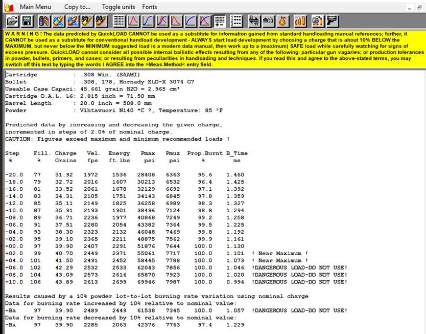

Here's some info using that data you supplied (note that without velocity info I'm limited to QuickLoads default powder burn rate, so it's nothing more than to give you ballpark ideas):
Thank you.
Used GRT when build this load. 39.9 and indeed 40.4 were the two sweet spots. But haven't spend any money yet for a speedo. 😅
But, for me, it showed that using 40.4 grains doesn't improve accuracy, but there is some unburned powder compared to 39.9grains which causes some more trouble using my NV device while hoghunting.
I have about 200 rounds left of this load. After unloading them hot, I will change to leadfree bullets due to new state laws and maybe try alternate powders.
