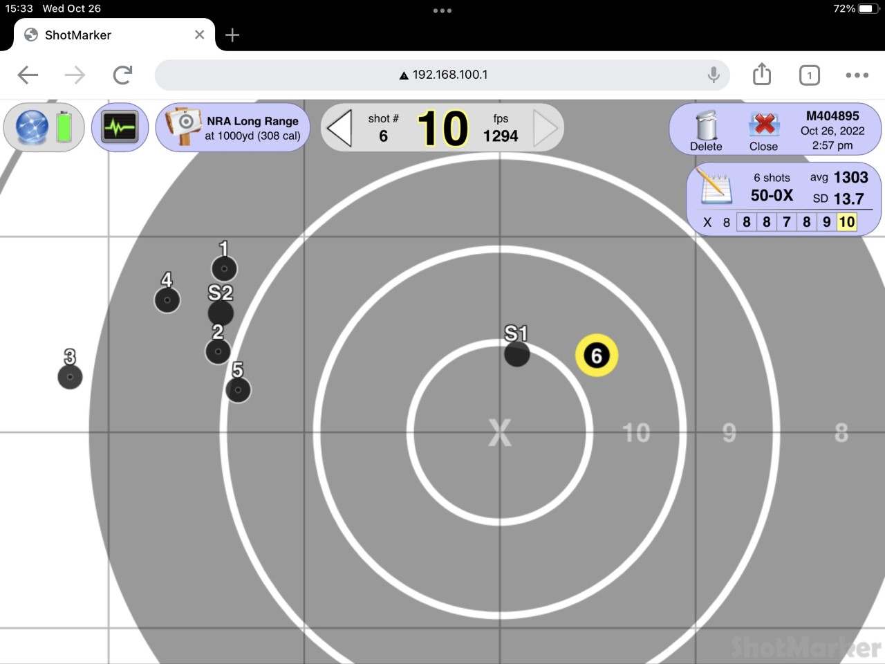

42.5 varg win brass 2.82 nominal (so they would fit in magazine). The top one is 1000 it took 9.2 to get on I think with 6.5 creedmoor it was 28min so about 8mils. Haven't chrono the 308 (going by drops it's 2600-2650) but the 6.5 was 143 ELD at 2750.
circles are 600, 750, 1000

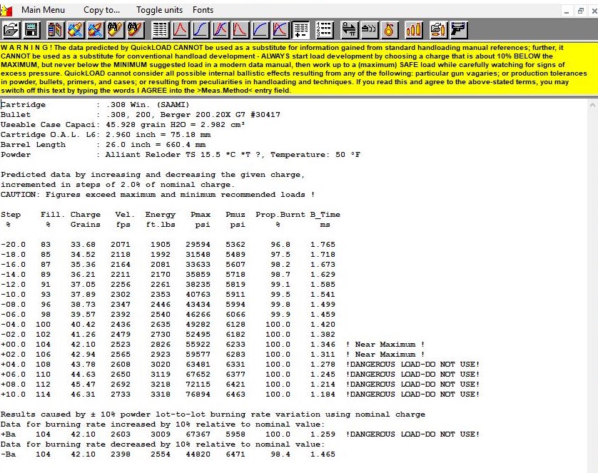

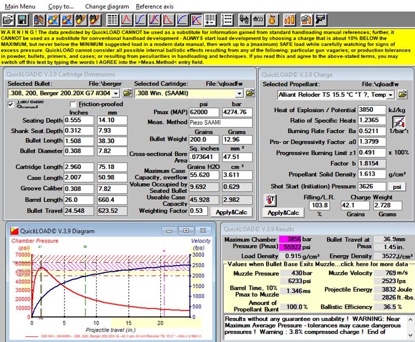

Started some load development on a few high BC 308W loads light/heavy, to see how they compare.
There's not a lot of data out there for either of these 2 powders in 308.
This was just trying to find powder charges.
Maybe @straightshooter1 would be willing to check these loads in Quick load for me.
For any one reading this. These loads were built in GRT for my barrel, brass, action. I have a lot off data with these powders that has been worked up to in my rifle. Do not assume these will be safe in your gun. GRT is often pretty far off in their speed predictions. Some hammer forged barrels (Tika/Ruger) are 150fps slower for same length & will pressure out much sooner.
They are all safe according to GRT in my rifle, but up near top end. That said GRT doesn't always agree with quick load from what I've seen.

Here you go . . . (note I used QL's default burn rate, but use temperature of 50°F to get the velocities you showed):
