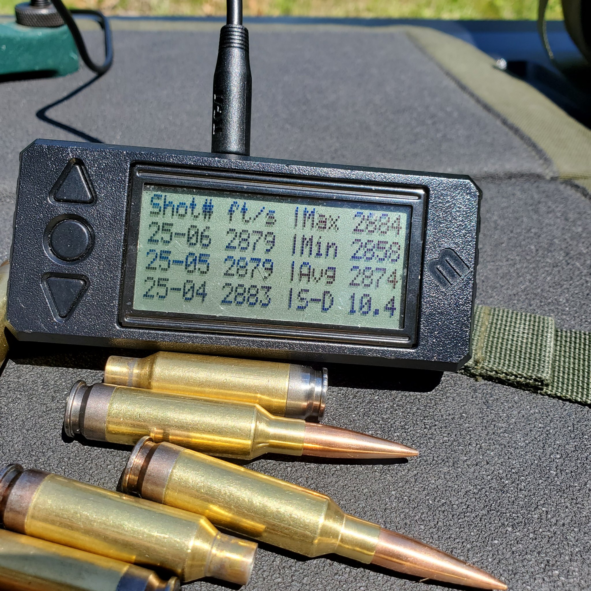

Here are some 200 SMK running 2874 fps out of a alum chassis 308 Win, 8 twist Bartlein on a trued Rem 700 LA action with the hybrid cases.
A good load for those wishing to do it at home....if ya want.

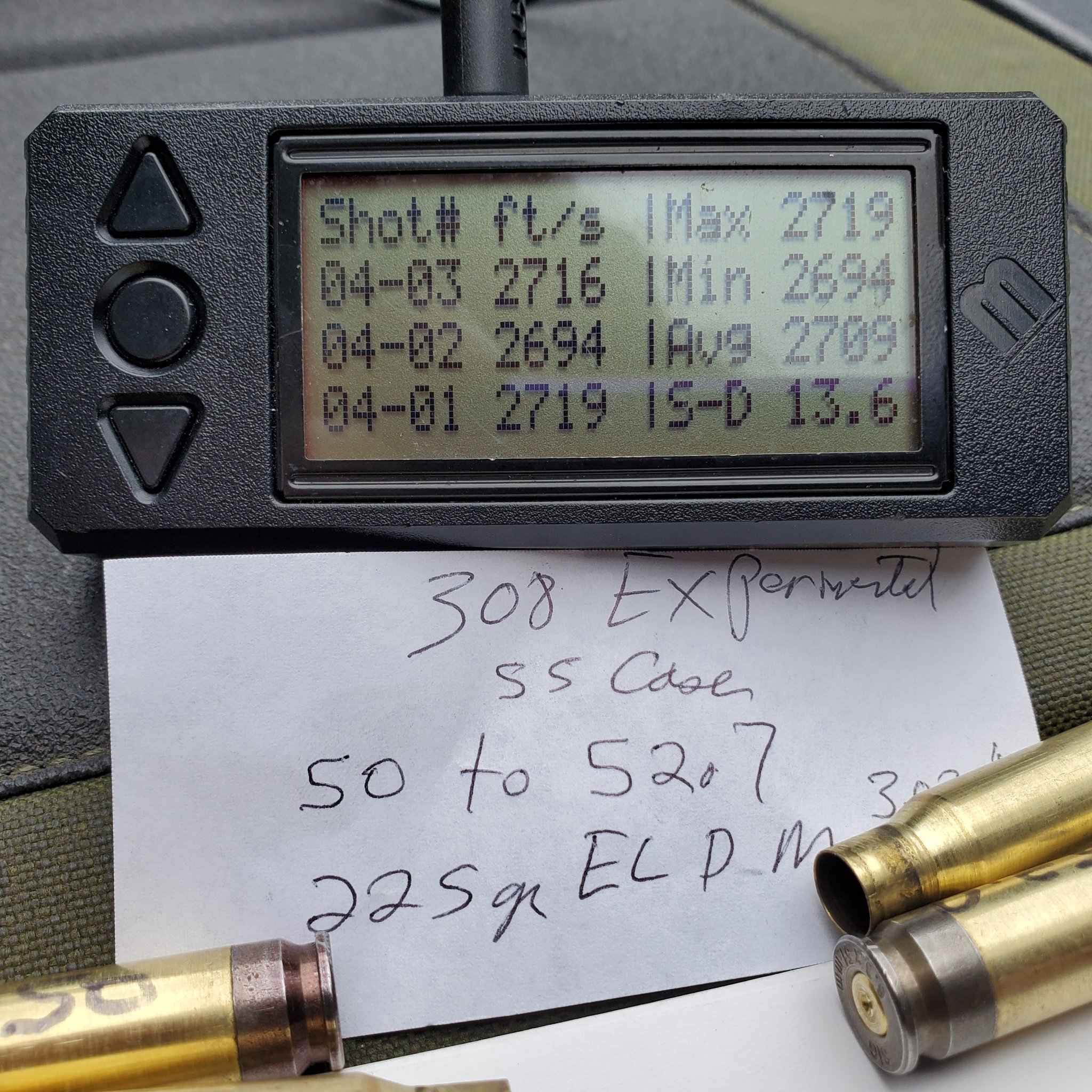

First experiment with Hornady 225 gr ELDM running over 2700 fps with a 308 hybrid case...they run 2674 fps in Lapua cases.
Not exactly slow for a 308 case.
But every time you compromise with shorter barrels, those velocities are diminished, as is the performance.

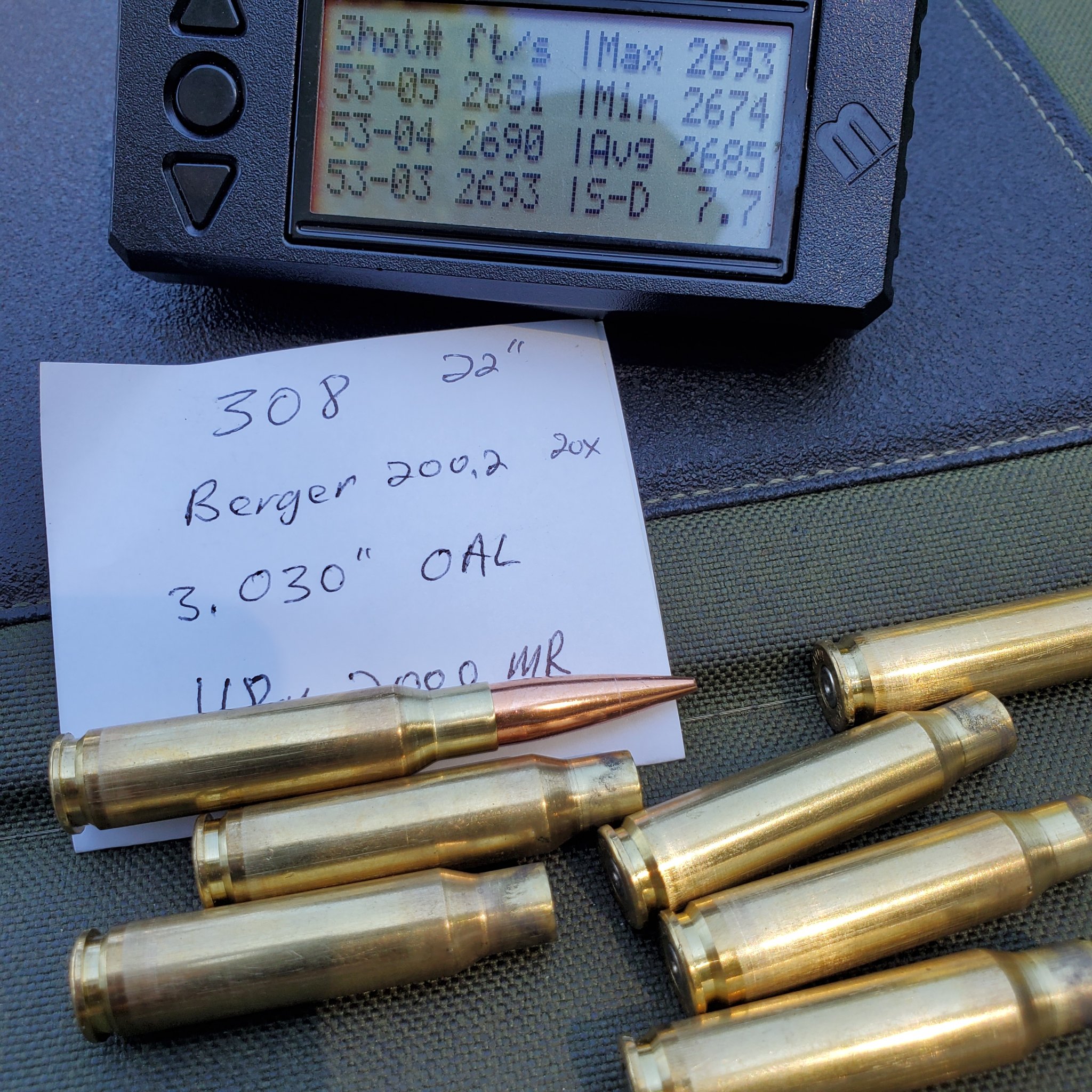

Since you like Bergers ...here's a 200.2 gr 20X Berger load, from the 22" barrel.
Just under 2700 fps.
